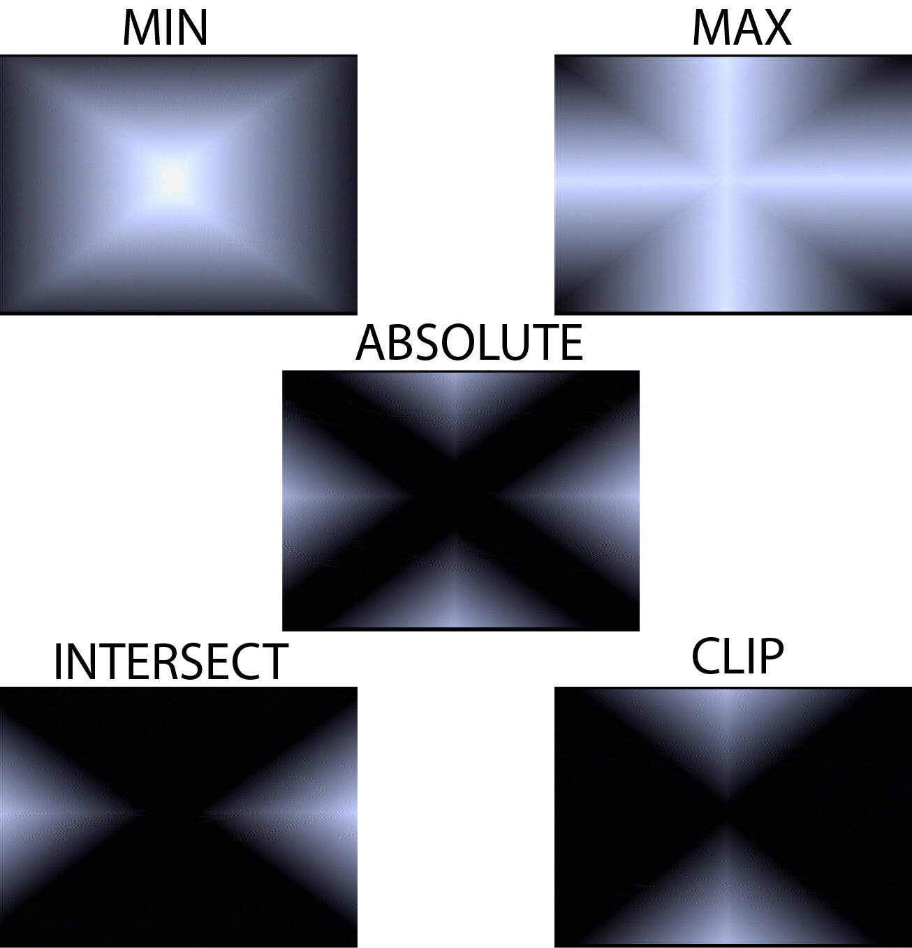

Greetings logicians, would anybody be interested in this for a DIY project? I believe its the same circuit as arch, but I’ve never owned one, so I’m only guessing. Photo below shows the outputs when using an H/V Triangle ramp on inputs A and B. Please excuse the noise its still on a breadboard…
ANALOG LOGIC
In the photo above,
intersect = MAX minus INPUT A
clip = MAX minus INPUT B
is this correct? or should I subtract from ABS instead of MAX?
Anyone have any ideas on how to make it differ from arch? Third input? More logic trickery? It has 6 (or 7) lm6172’s, so its looking like a rather expensive build as it is. Processors, function generators, and faders are real fun with this, but including it within the circuit could make it expensive for those who already have those to spare.

Being 1/2 Arch and DIY-able already seems pretty different to me. You could maybe add a simple sum output as well?

I was also thinking of some inverting/ offset. Would it be better pre or post logic? Adding +/- offset post logic (especially to ABS, intersect, and clip) lets you dial in the overall output (size/intensity) for nice overlays. But attenuvert and offset pre logic allows you to shape an input to effect the way the logic circuit itself is working. (i’ll probably do this with at least one input, clipped to 0-1v?)
What’re yall’z thoughts? We’re getting pretty high on op amps, does anybody care?
