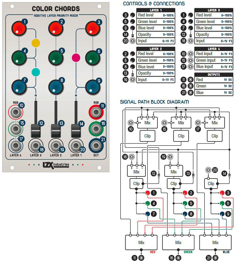

Basically, it clips a signal to 0-1v, and the signal is split to an output (to mixer channel) and an attenuator. The attenuator is the amount that subtracts from lower layers. I’m considering adding an opacity cv input here?
The example is using only two layers due to me being low on op amps, but the same rules apply to all lower layers. It will be an expandable module, so you can add more layers (there will be a limit, not sure how high I’ll go). I would like to make one for chaining rgb backgrounds at some point (yikes, around 10 lm6172’s)

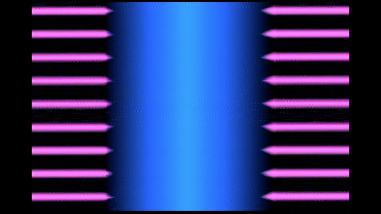

https://www.youtube.com/watch?v=5hftdcB87asIn the example above, layer 1 is the gradient ramp, and layer 2 is the scrolling bars. I’m just turning up and down the opacity of layer 1, as well as adjusting the colors on both channels. I also adjust the opacity when layer 1’s color channels are all the way black (almost behaves like a vca). Outputs are going into @VisibleSignals Matrix Mixer.

Seems similar to Fox’s Veil, but with separate outputs for each layer (if I understand correctly) — which can be handy for colorization, as you’re showing.
Don’t 100% understand having outputs on the back. So the idea is that it would be necessary to hardwire those to a matrix mixer?
#3 — jreinke · 2022-05-24
Yea I love the veil! This is more just for coloring.
The outs on the back are just for subtracting lower layers. The outs on the front are for going to the mixer.
Layer 1 has to subtract from every layer underneath, so if for instance we have 4 layers, layer 1 goes to 3 seperate outputs (subtract from layers 2, 3, and 4). Layer 2 goes to 2 seperate outputs and so on.
Shown in the diagram after the clip block.
