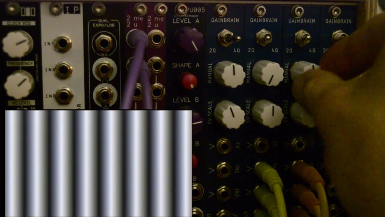

Tried the R4 10k mod tonight, works great! Here’s a short comparison video I’ve made, definitely improves the range on the manual control. Sorry its so short, very little space on my hard drive hahah but hopefully enough detail to get the functionality across.
https://www.youtube.com/watch?v=t7CW6EqBzMA
