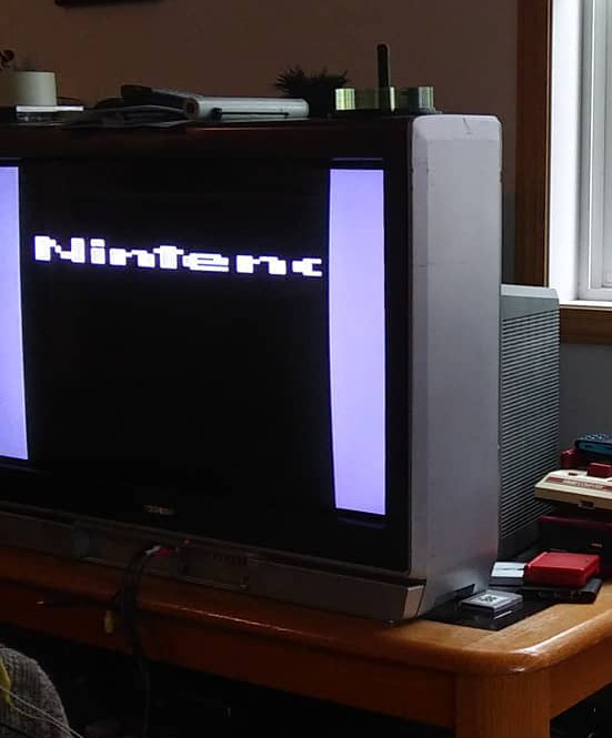

I’ve written a handful of programs for the original gameboy in ASM as well as an old sync gen/frame buffer to convert the gameboy’s LCD data to composite. This was ages ago though, so I doubt I have the sources.
The Atmega168 @ 16MHz was powerful enough to set up interrupt routines for producing the sync signals, but I was only able to fully load the frame buffer and output part of a frame horizontally before my sync interrupt triggered the next line.

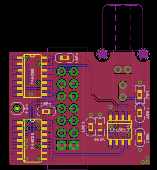

Making an RCA-to-14 pin adapter should be pretty straight forward, but so should adapting the C4 and C9 to use the LMH1980.
If anyone has the ability to hand solder SOIC and 0603 parts, I can send you the untested files for an adapter I was experimenting on. It only solves the issue for users who own a C4 or C9. It does not produce the blanking signal. It could possibly help with a few of the expedition [Visionary] modules that have 14-pin sync. I don’t have any to test it on though.
