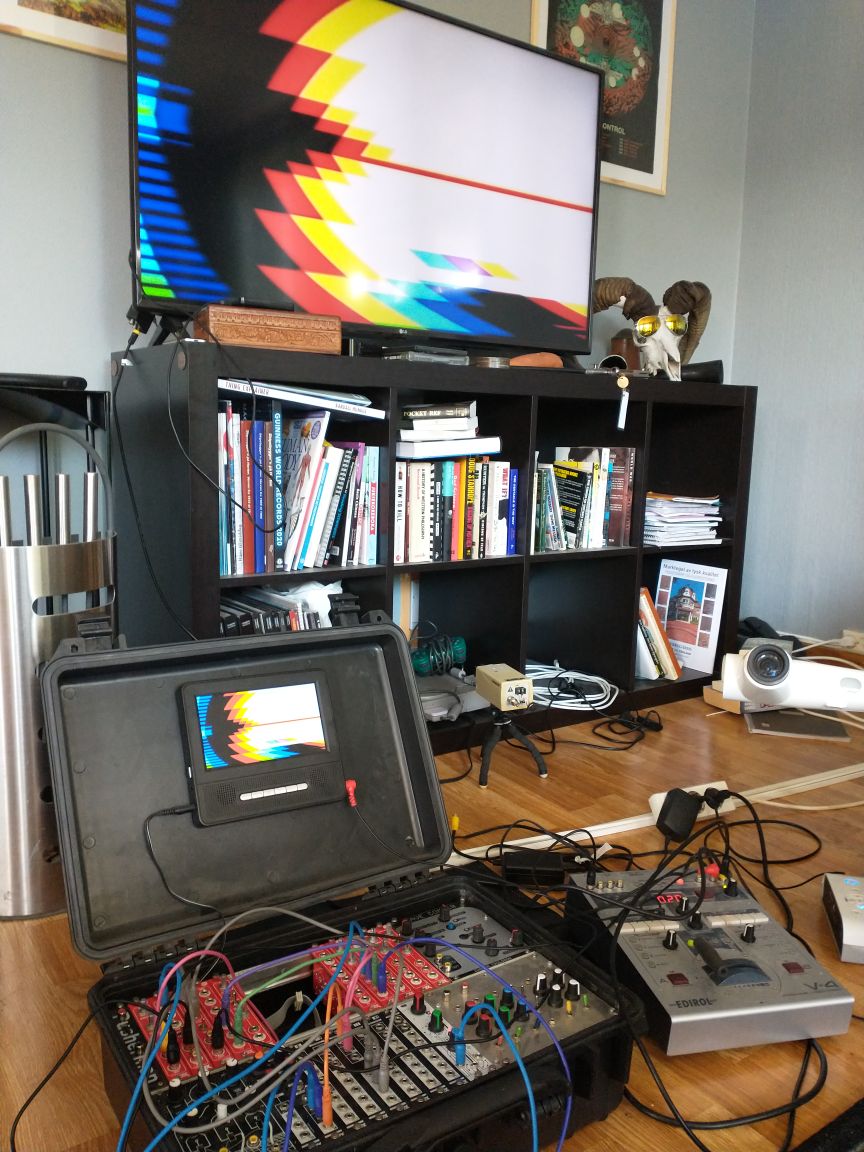

Hey everyone.
I’ve been lurking here for a while, I didn’t feel like making an account until I had something working.
I got into video stuff too late to start a castle system when it was sold.
I was in the process of figuring out my own solution for sync gen and encoding when I saw that
the Cadet system was released into open source with gerbers and all.
So I took the plunge and ordered 10x vcos and 5x of the rest at jlcpcb and began ordering parts.
cadets start
So far I’ve built one of each module. (well 2 vco’s but only one works^^)
Finally today I got the 74hc4538 for the sync generator. The last part i needed to start testing.
I got my VCXO from alibaba, sold as a genuine part but it clearly isn’t when inspecting in person.
I’m happy to report that it does work, though only with an external signal to sync to.
No big deal, but does anyone have an idea what’s wrong?
Having some castle modules from before to play with as well.
I still have a lot of modules to build
I’m very happy with how this is coming together.
Thanks a bunch to LZX for releasing the gerbers!

(Loving that euroracked FFG in the bottom right of your case! Are the extra CV inputs to control the bitswap switches with an external signal? Really neat, would love to see how it looks once modulated!)

(those inputs on the FFG are binary. just a gate flipping the bitswap switch really fast.)
