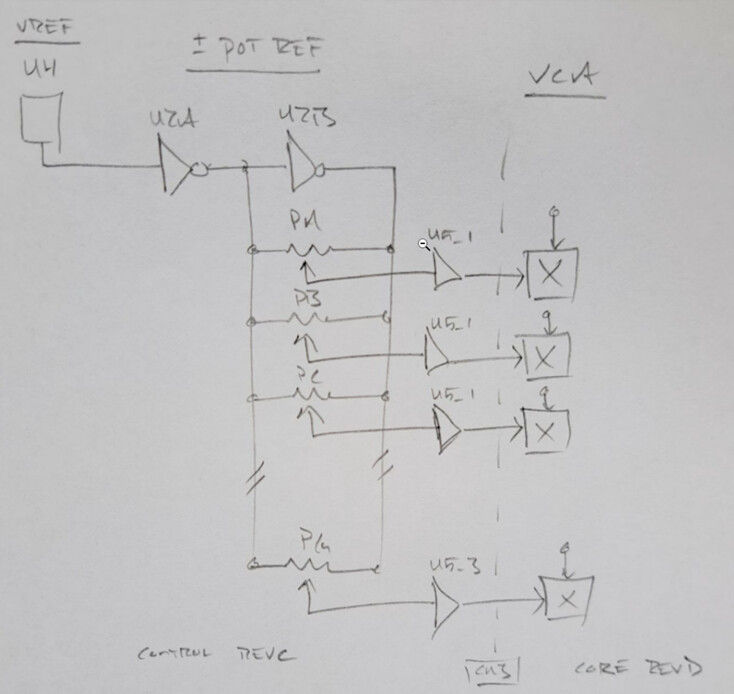

The 9 front panel pots provide a control signal by which each video input is multiplied. Here is a rough outline of how voltage control is configured in this respect.
A reference voltage is generated at U4, buffered and inverted by U2, then supplied to either end of the control pots. The center tap is then buffered and passed onto the one of two multiplier inputs: Each control stage is identical.

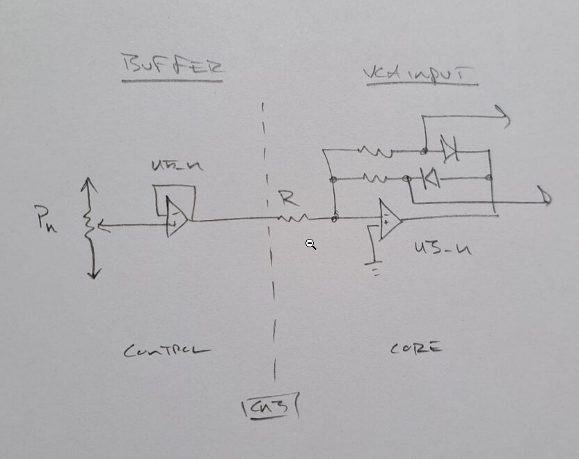

Looking closer at the interface between stages, our control voltage passes through a voltage follower into an inverting full wave rectifier and then onward to VCA town.

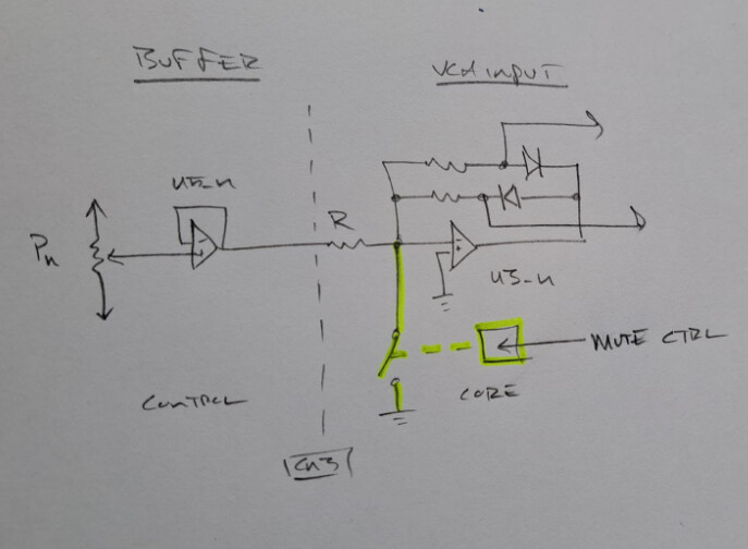

Proposal:
Instead, employ an analog switch or tri-state whatever to short the input of the rectifier.

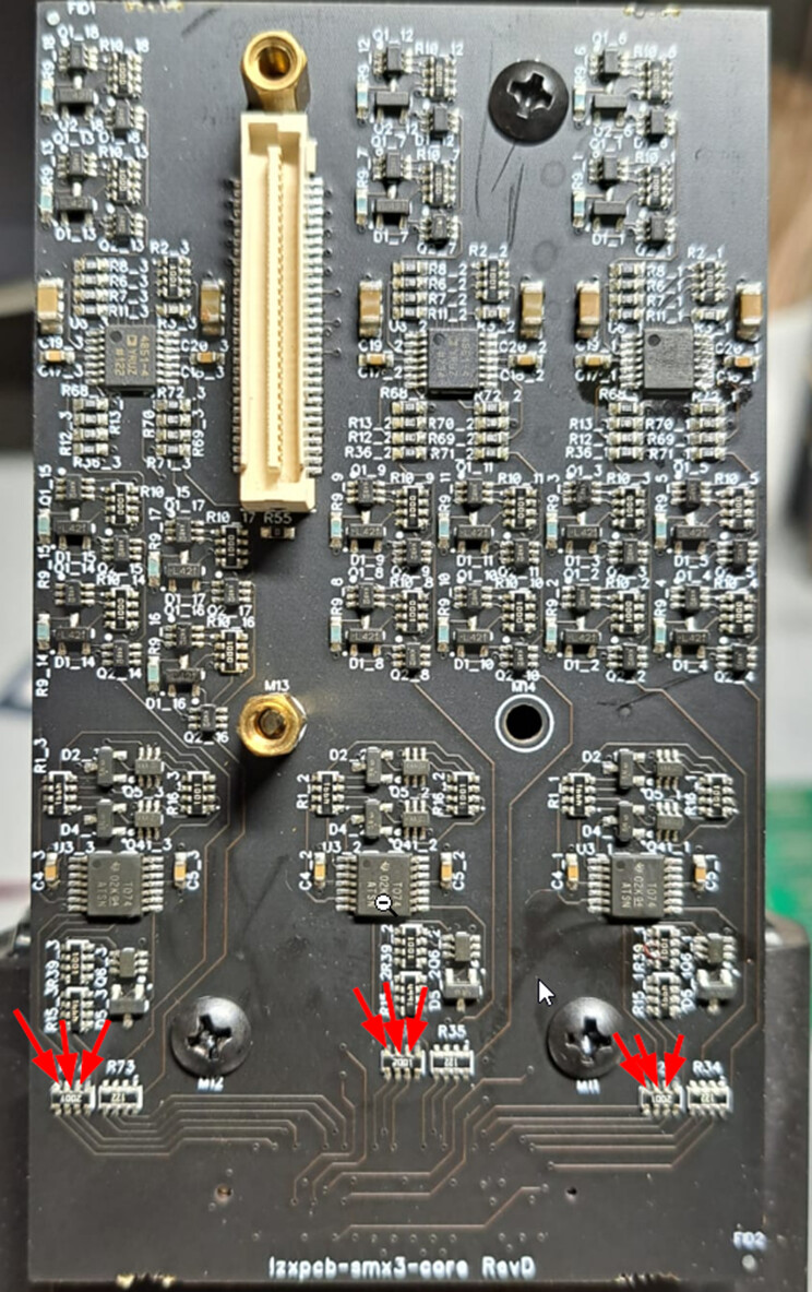

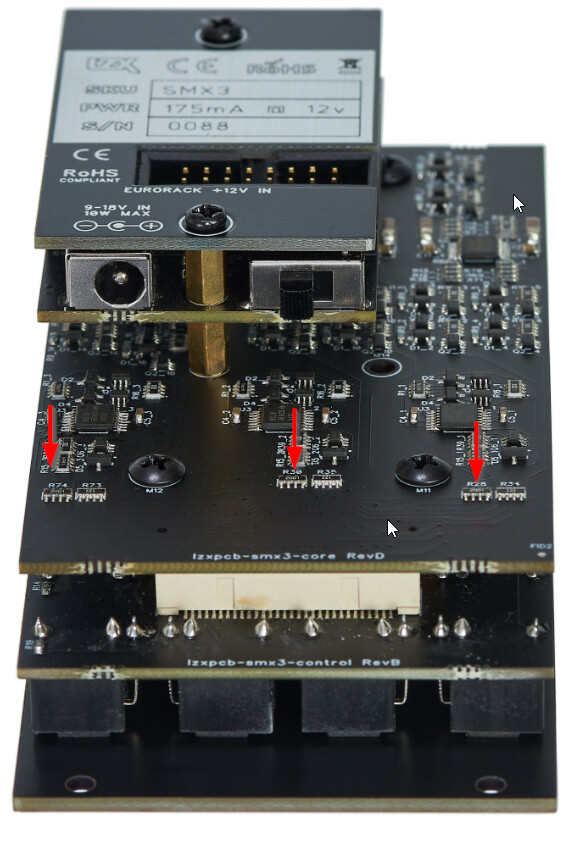

Inputs are located atop resistor arrays R28, R30, and R74 pins 2-4 on the core board. Wonderfully available right at the back.
YMMV.
