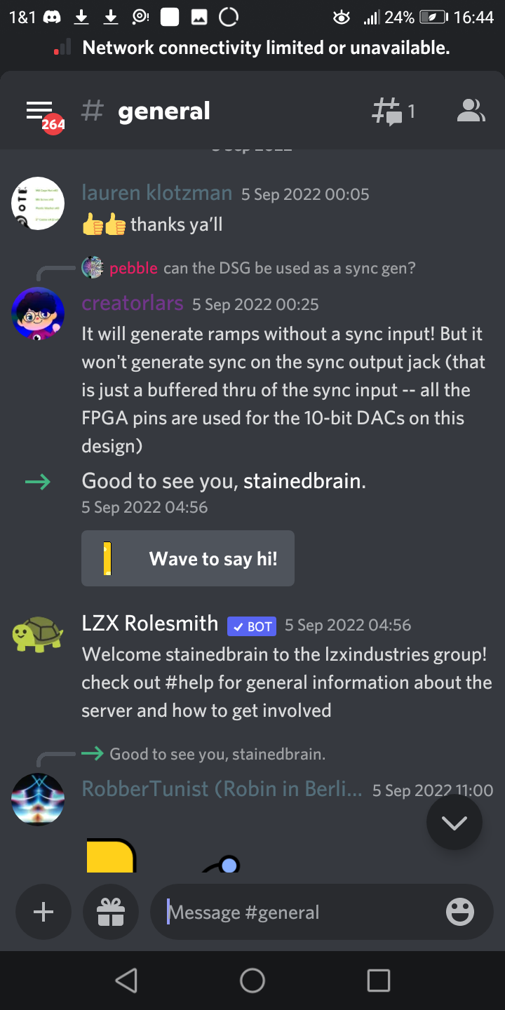

#6 — Robbertunist · 2022-09-07
From Lars on the Discord regarding DSG3’s sync abilities. I thought it might be helpful.
“It will generate ramps without a sync input! But it won’t generate sync on the sync output jack (that is just a buffered thru of the sync input – all the FPGA pins are used for the 10-bit DACs on this design)”
