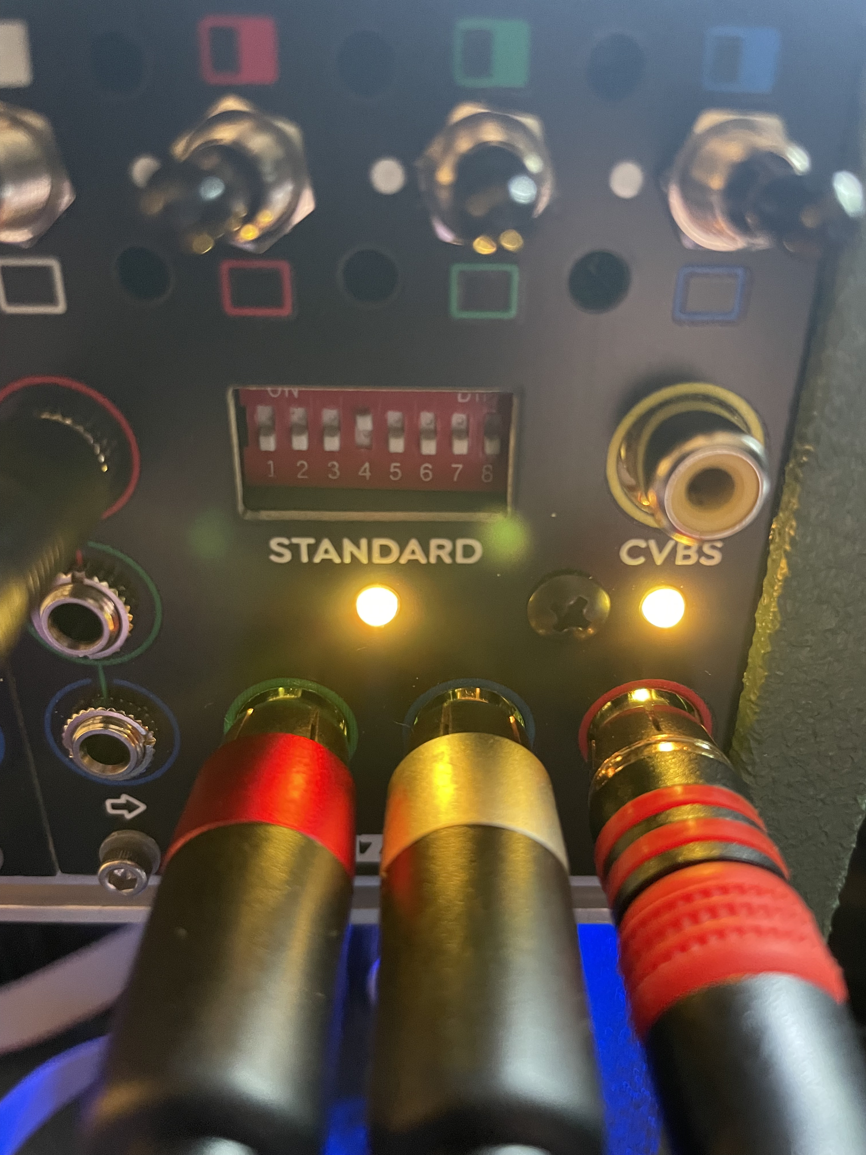

So far I can’t get any signal to the VILTROX. I have tried lots of dip switch settings and toggle switches on ESG3. Also tried dip switches on the BM. I hope this is just a matter of the know problem with the Analog to SDI but I am thinking it is not? My sync lights on the ESG are green, I can get the little white light on the BM to flicker (guessing that is good but cant find anything in the manual about it). The Viltrox shows “no signal” using all the input settings.

You mention the LEDs on your ESG are green. Is this the case no matter what dip switch settings you have on the ESG? Do you have anything plugged into the rear RCA sync input? Do the LEDs ever light up yellow instead?

I don’t think I can change the lights on ESG by flipping the dip switches. I can try when I get home.
#6 — brownshoesonly · 2022-09-16
It appears, due to always green LED, that your ESG is not booting the onboard firmware. Email support@lzxindustries.net and we can get you sorted.

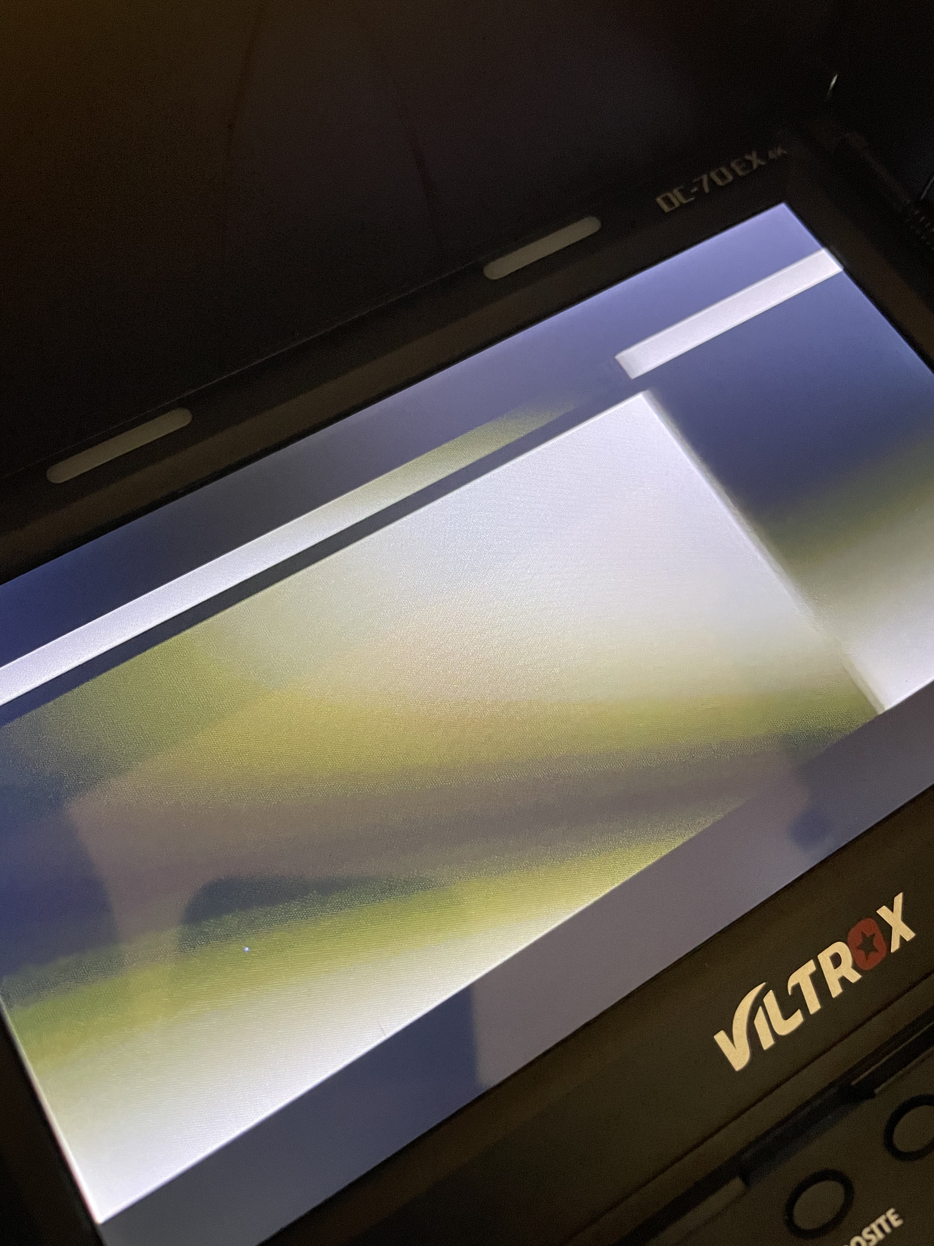

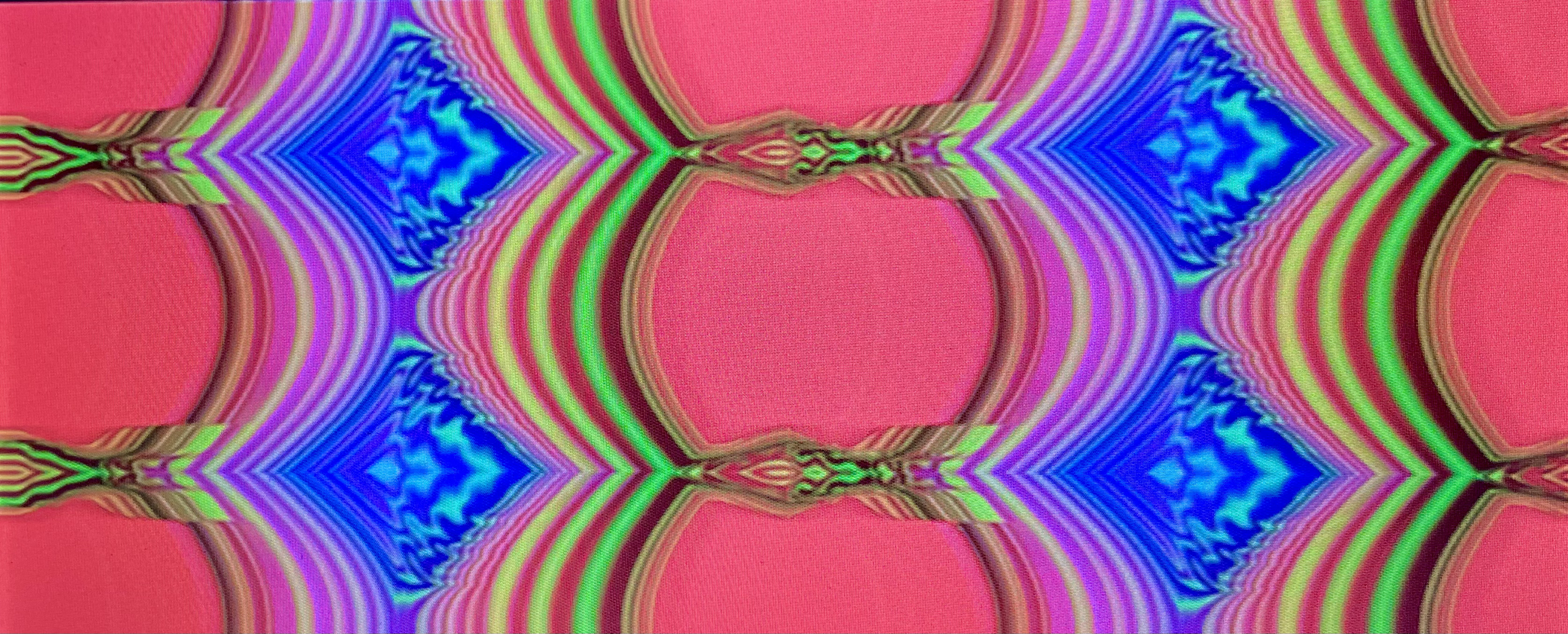

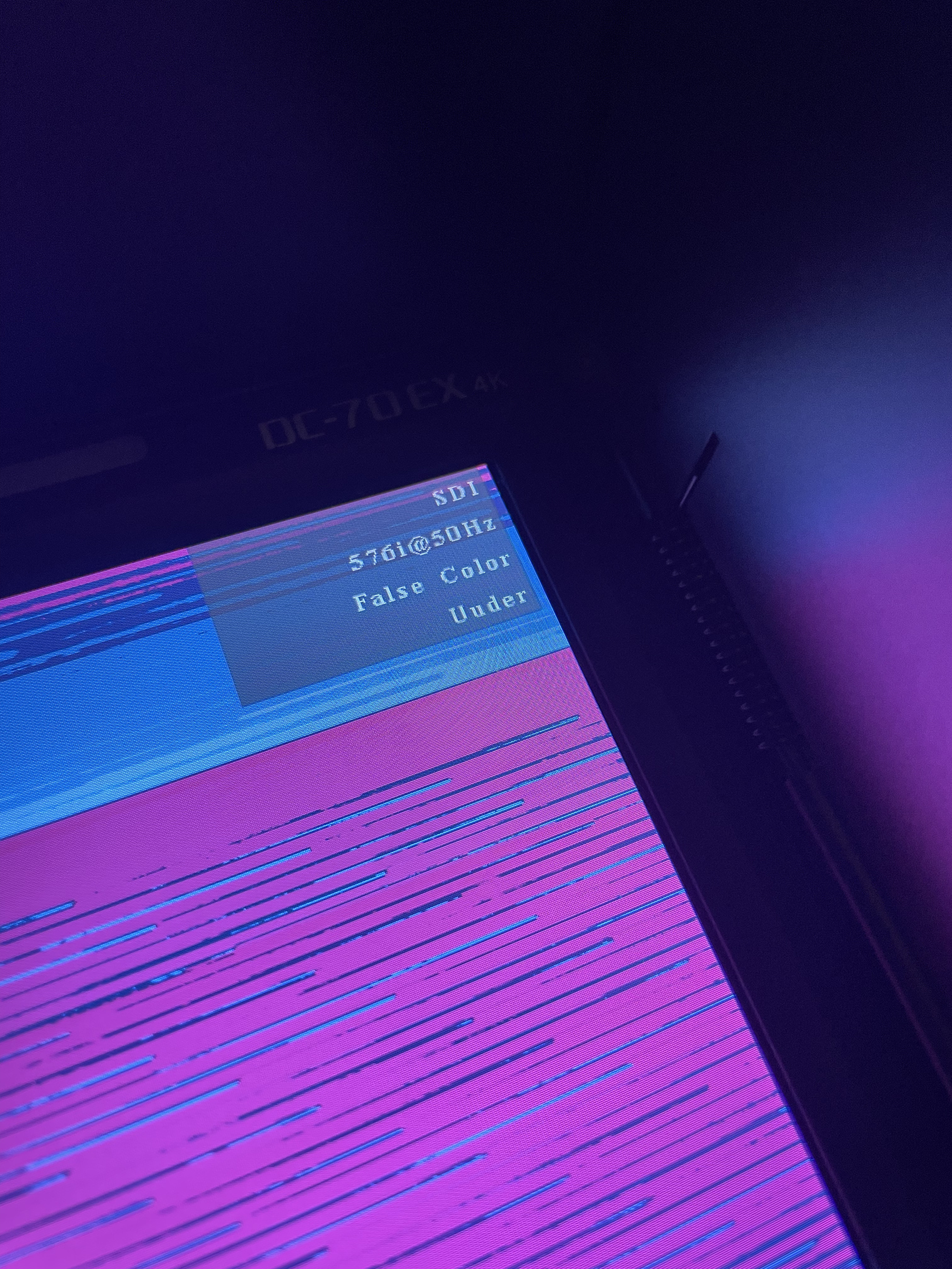

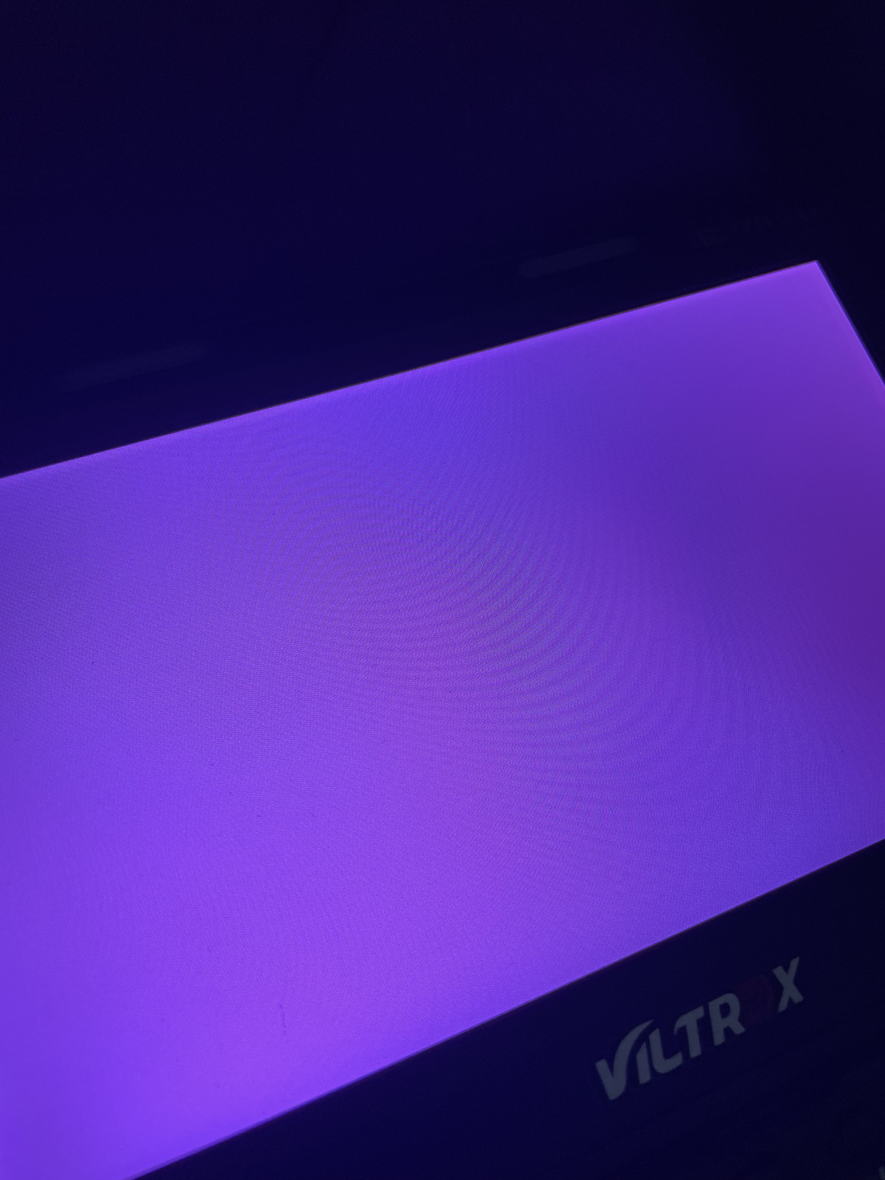

Dip switch 4 in up position gets me a signal but I can’t get anything other than the photos when patching DSG3 or just ESG3 on its own. ESG on its own will produce clean solid color. Adding DSG is all “lines” no matter what i do to the modules.

You may want to check the DIP switches on the DSG now. Theoretically, if the 5th one (from the left) is down, that’ll enable autodetect mode and it shouldn’t matter what position any of the others are in. I think this should be the factory default setting, but you never know, so I’d check it.
If that doesn’t do the trick, you can also try setting the 4th and 5th ones (from the left) on the DSG to up and the rest to down, and that should match the mode you have set on the ESG. (Note: The switch positions for that mode are not the same on both modules.) As far as I know, this shouldn’t be necessary since the autodetect mode should work, but maybe this will help in your particular case. I think the results of this test will probably be useful for further diagnostics.
Yet another thing you could try if you happen to have any eurorack audio oscillators is to plug the oscillator output into one of the ESG inputs and see if you can see anything. Lower rates on the oscillator should make the screen flicker, but if you go to higher rates (nearer the top of the oscillator’s range) you should be able to get some horizontal bars. You likely won’t be able to get them to stay perfectly still, but with some very care adjustments of the frequency you’ll probably be able to get some scrolling bars, at least. This kind of a test should help to show that at least another part of the ESG is working correctly. (Plus this kind of source will let you play around a bit with your whole video system in the meantime while trying to get the DSG or sync issue resolved.)

4th switch up on DSG does indeed produce a better ramp (I think that’s what it is called!) but it is scrolling slowly across the screen and not centered. Unlike the static results in the beginning of the video that was recently posted. Ill run an audio OSC into ESG and see what I get.

White light in the BM analog to SDI box flickers when everything is connected
This should be a steady light when the unit is operating correctly and means it is having trouble syncing to ESG’s output. This explains the erratic behavior you are seeing downstream on the display as well.
It’s always best to simplify your signal chain in these scenarios. Remove any converters and patch directly into a tv with a composite video input (or the AV in on the Viltrox). Set your ESG to NTSC and start with the CVBS output on ESG.

White lite in BM converter is solid now.
Tried a bunch of dip switch combos but this is the best so far. Trust me, I am on the hunt for a non converted display.
this is the current results test - YouTube
Without any new hardware or cable options today I guess I can unload all the other modules and see if that does anything. EDIT: pulled all but DSG and ESG and the ramp is now stationary on screen. Power issue? The Konstant Lab power has parts of the bus filtered as well. I guess I could move these two over to that section and start adding modules back in to see what happens. I had a feeling I would be needing to go the 12v barrel route. Just something else to order and wait on I guess!
#17 — Pagoda · 2022-09-18
Guessing its a power issue at this stage. I now am just running ESG DSG FKG and Matrix mixer with good results. I am still getting issues with the signal just dying for a sec and then it will return. Lights on ESG and converter do not change when it goes out, Just the signal at the monitor. I ordered the DC Distro and some cables and plan to offload all or most of the LZX modules to that. Hopefully that makes my signal more stable because now I’m having a blast! first cruddy patch
