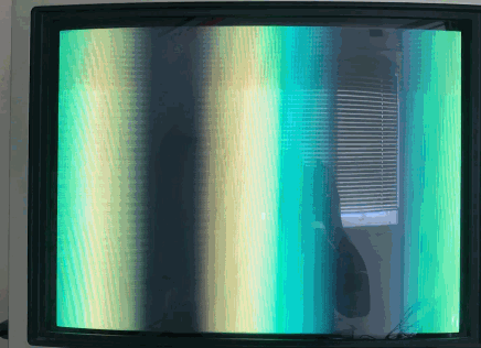

I think I am having a different problem with syncing Cadet modules and the Vidiot.
Syncing the Cadet to the Vidiot, Vidiot sync out > Cadet 1 input, works fine and everything is happy and stable.
Syncing the Cadet to the Vidiot is a different story though. With Cadet 2 out > Vidiot input oscillators scroll from right to left. This works one of two ways. When monitoring the output of the Vidiot, Vidiot oscillators will be stable while Cadet oscillators drift. When monitoring the Cadet 2 output, Cadet oscillators are stable, but Vidiot oscillators drift.
I think the problem might be with the Vidiot. I have an early production unit that doesn’t seem to go into PAL mode. When I set my Cadet 2 to PAL, my colors pretty much go away. When I set the vidiot to PAL or NTSC I don’t get similar results (colors remain). I know that some early production units are flipped so PAL is NTSC and vice versa. I run mine in the PAL position because I get some jagged diagonal lines when using the keyers when I’m set to NTSC. When testing out this syncing issue I tried every combination of PAL and NTSC positions with no luck.
So is this an issue with the Vidiot or my Cadet modules?
I’m not too worried since I have a fine workaround, syncing the Cadet to the Vidiot, but I would like to have the full flexibility.
vidiotCadet_Slip2
Thanks for any input!

Here are some photos of the Vidiot on its own in PAL and NTSC modes. It’s weird.
Vidiot set to NTSC image
Vidiot set to PAL
#16 — creatorlars · 2018-09-28
Looks like some extra capacitance or dry pad in the subcarrier oscillator circuit causing that anomaly in the NTSC subcarrier (which is definitely not correct.) We’re happy to clean it up and get it looking pristine any time. Does changing the loopthru switch setting change it at all?

In both modes with loopthru turned off after the Vidiot is powered on the image turns black and white with thin, subtle red and blue diagonal (from upper left to lower right) lines. I’ll just post a picture.
IMG_9935
In PAL mode, powering up with loopthru off results in the same image pictured above, but rapidly scrolling from top to bottom.
Powering up in NTSC mode with loopthru off results in the same rapid scrolling, but with a full color image.
#18 — creatorlars · 2018-09-29
Cool, I would expect some instability with loopthru on but sync out/in not connected to anything. But definitely seems like your subcarrier is teetering on the edge of frequency range. Usually a quick fix with some hot air and isopropyl in the areas around the crystals on the rear assembly.
