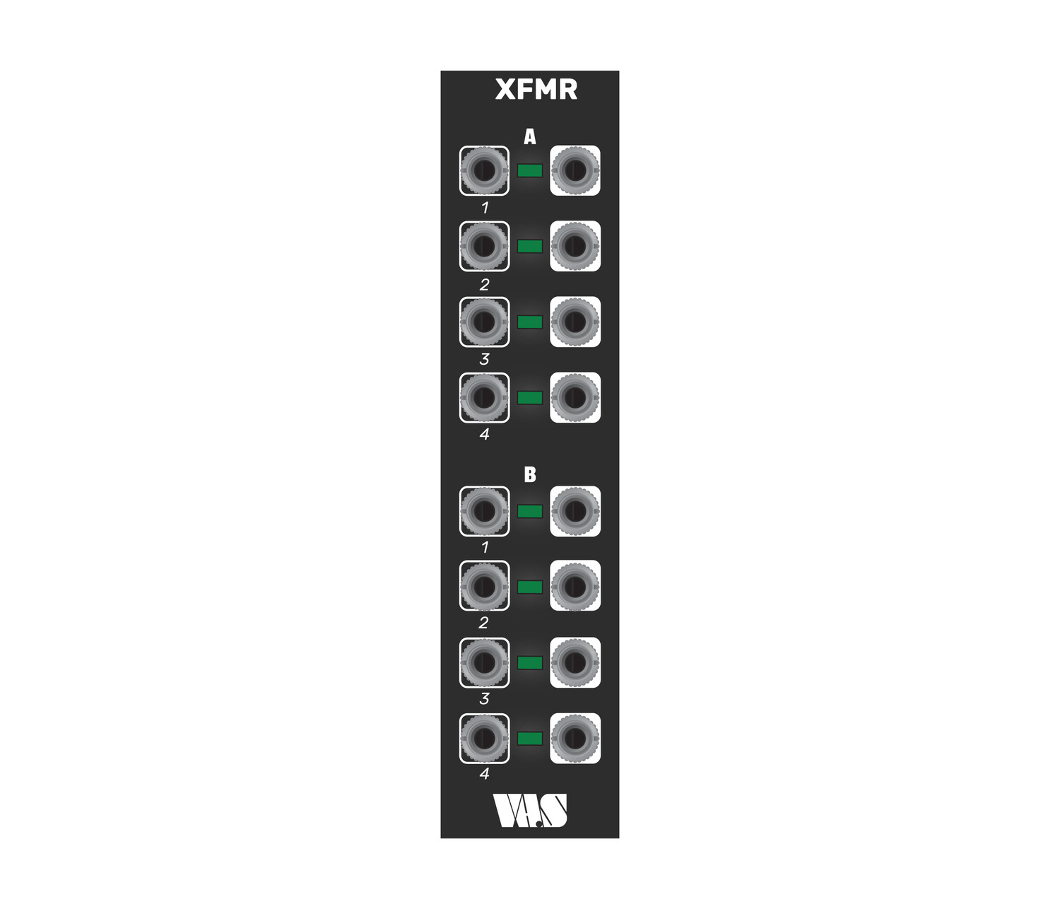

BTW, I am aware of the VH.S 5v transformer in development by @brownshoesonly … this looks great but I ended up going with the Cadet Scalers because A) alternative build can handle bipolar signals, and B) they can be modded for 10v operation.
https://www.videoheadroom.systems/storefront/p/xfmrAmplitude Converter 1V to 5V or 5V to 1V in development
Price: USD 109.99
Link: XFMR — videoheadroom.systems

I think the new one is probably a 12HP module, but whether it’s all patchable (like Sum/Dist) or has switchable blocks (like a DSG3 style layout) I’m not sure yet. Another approach is the “universal super function” - or an 8HP module that is multi-modal (with lots of amp/atten modes) but only processes a single signal. It’s a big footprint for a single function.
I wouldn’t be in the market for an 8HP module that only handles a single signal. That’s just way too big of a footprint.
My preference would be for switchable blocks. Any way we can reduce the spaghetti is good. It is often difficult to grok a patch due to noodle clutter. The only problem with the sexy Gen3 switches is the amount of surface area they take up. But clarity and durability / longevity are higher priorities.
A 12HP converter module with a DSG3 style layout would be great. Four inputs / outputs, each with the following switches:

a 10v input signal will be reduced to 2v with existing converters (divide by 5). this is well within the processing range of video modules and their attenuators. A 10v input to video with NO 5:1 converter will definitely clip ahead of the attenuator, which is not desirable
as far as video to audio system patching. yes. depending on the osc. and your goals. You could re-bias a 0-1v signal to be bipolar -0.5 to 0.5v, and then go 5x gain or more. But this bias is just changing how your signal interacts with the possible attenuverter controls on said audio module. modulation will only move positive of your bias compared to swinging on both sides of your bias control with a bipolar input.
