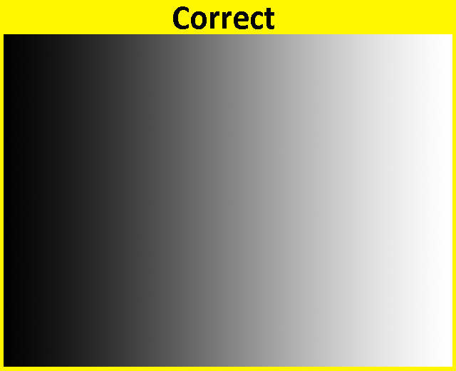

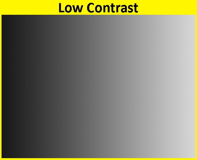

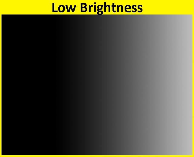

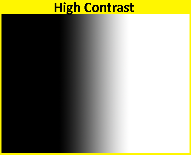

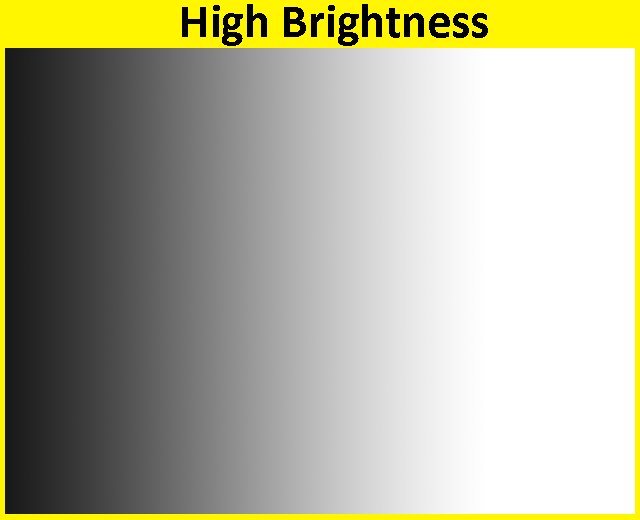

  5. Adjust the Red Gain & Red Brightness trimmers to maximize the range of your ramp input. When properly trimmed, the ramp signal will be 0% Red (Black) at the left edge of the screen, and 100% Red at the right edge of the screen.

Here are some images showing correct and incorrect calibration with an input ramp source.
