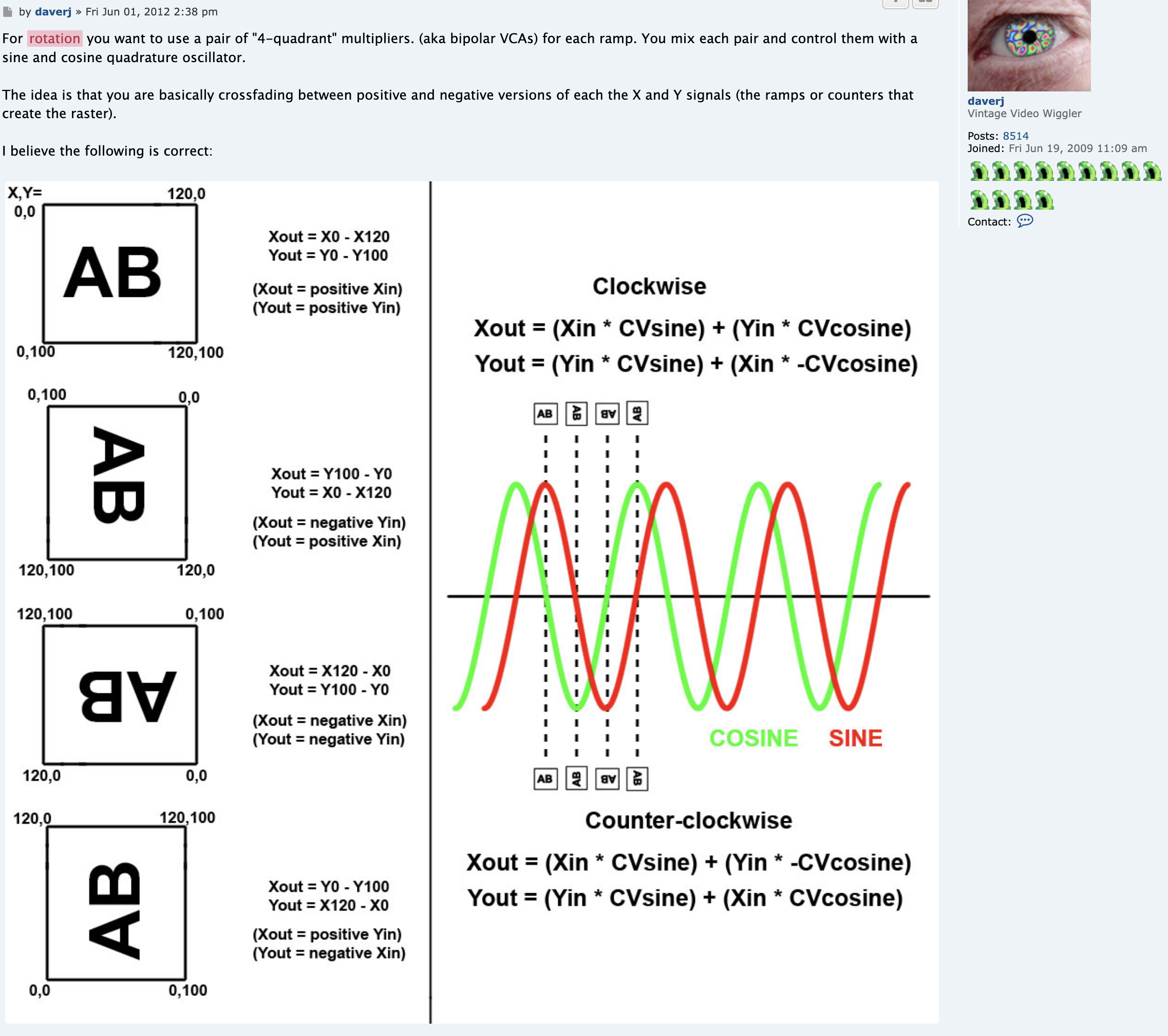

Martijn of Reverse Landfill posted a couple of helpful pictures here:
These? > > > [1136_2032_ruttetra_1_1%20(1)]>
The 2nd picture has five (maybe 6, I only Weißglut looked) “X” blocks marked, those are the required Multiplier modules, they control the volume of a signal & can be thought of as a VCA (Voltage Controlled Amplifier) if you’re familiar with audio synth jargon.

There’s another such picture/illustration that shows how the quadrature Osc & its 4x 90° phased outputs bring the various ramp signals in & out to create the rotation effect.

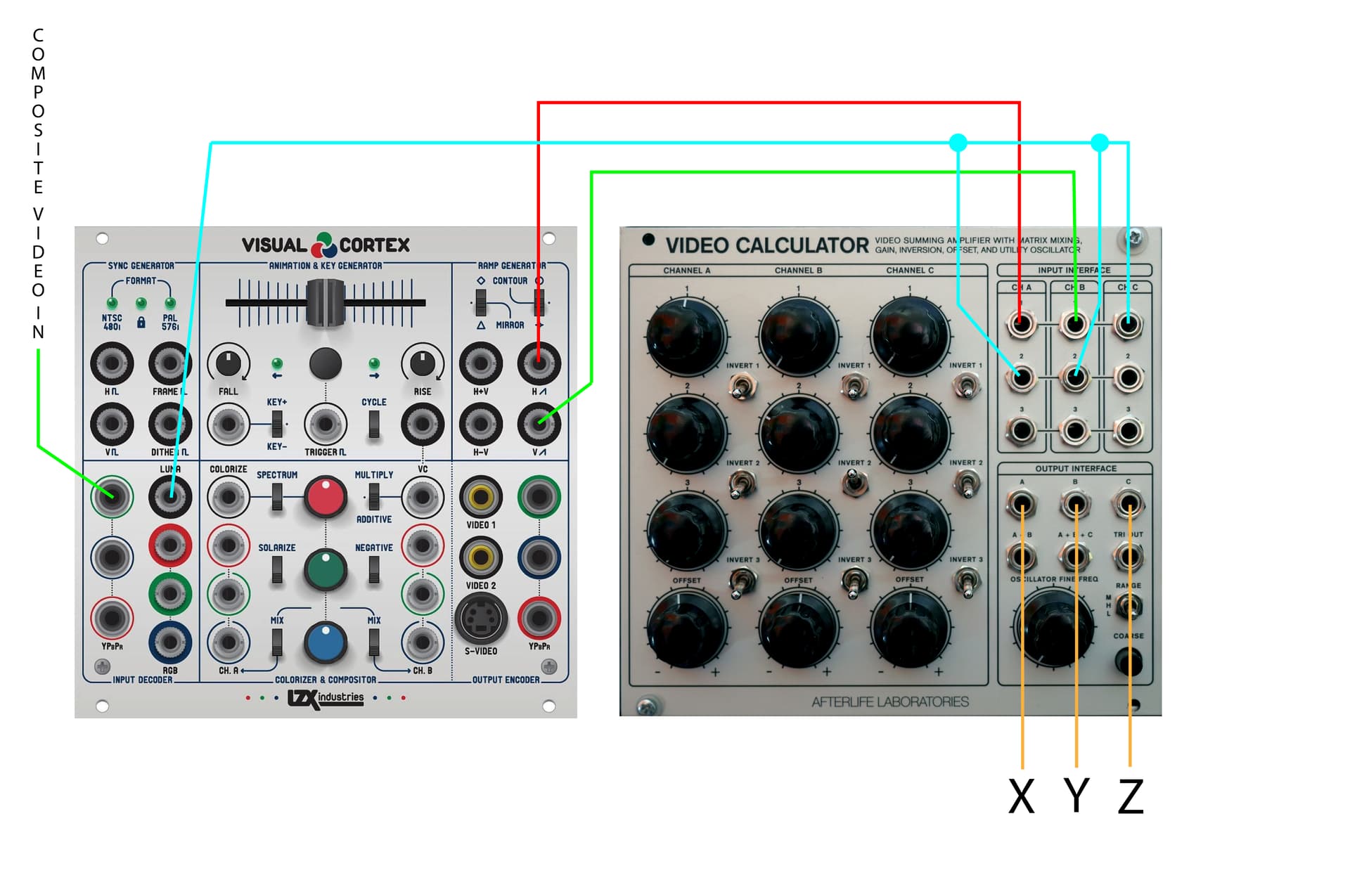

It’s possible to use the Video Calculator from Afterlife Laboratories to do a Rutt Ettra style patch.
The company shared this image with me. They said With Gen3 LZX modules you can use ESG3, and the DSG3 for ramps. I’m not sure how to get CVBS into a luma signal using the ESG3 without the TBC2. I asked but did not (yet?) receive an answer. Does anyone have any thoughts on that?

Use Syntonie’s VU003B to get an external source’s Luma into an ESG-based system.
