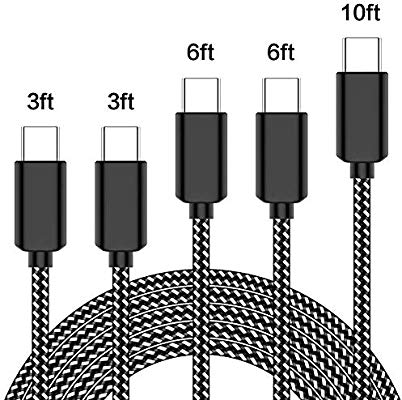

This is the one I ordered (I got the Andor1 Basic) and it worked - I ended up ordering a second just in case. I tried a really cheap one off ebay that didn’t work.
amazon.com
https://www.amazon.com/gp/product/B000IXLHOMBuy Zune A/V Output Cable (Discontinued by Manufacturer): Electronics - Amazon.com ✓ FREE DELIVERY possible on eligible purchases
Link: Amazon.com: Zune A/V Output Cable (Discontinued by Manufacturer): Microsoft:...
Ignore the picture - for some reason it shows a USB C cable. If you look at the reviews, it shows the proper cable.
