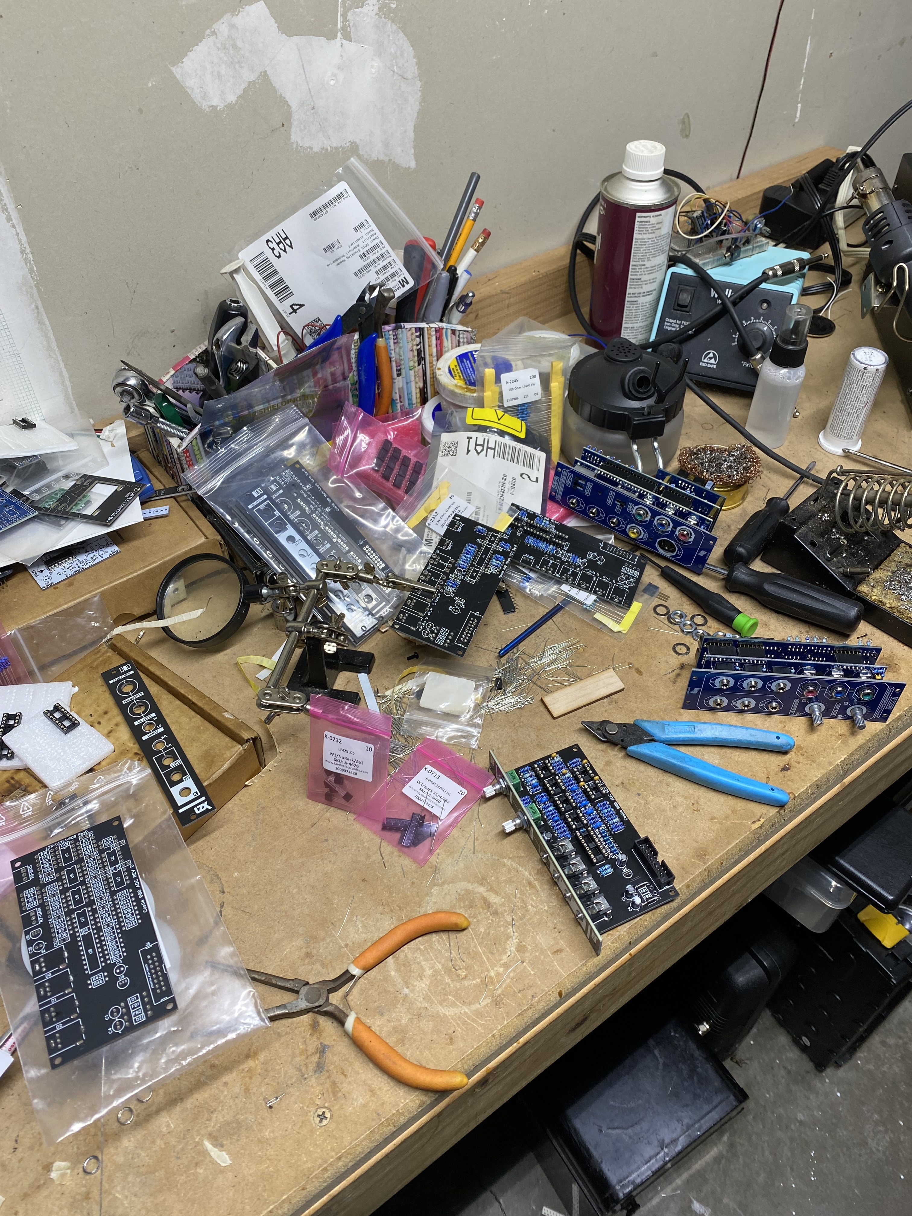

I thought I’d share my progress here. The castle builds so far have been super easy - all of the resistors are easy to place, pretty common components, and honestly not a lot to really worry about. As per any build both of the Syntonie modules are like 2 parts shy each from being completed and in general my cheap ass will need to buy more LM6172s. All in all really straightforward builds.

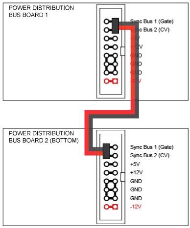

Not really sure where the answer is or the best place to ask the following but here we go:
I’m probably a month off from having these modules completed but I’m aware the Castle VCO needs sync and that sync on this module is received through the CV/Gate headers from the busboard. Does one bus expect to have horizontal and the other vertical sync? Which expects which? Horizontal of CV or vice versa and etc? On the RCA standard are the two mixed or modulated together to be extracted down the line? In order to implement sync with the VCO from a VU007b would there need to be some additional circuitry to make that happen? Is there something available for that application?
Thanks in advance, a lot of new to soak up here.
#14 — 337is · 2022-12-30
This is not 100% related to your questions but it’s been a helpful image for me when it comes to running sync through eurorack power. The images gets lost in the shuffle of websites over time so I’ve kept a reference copy on hand. Hope it may be of use to you or others
