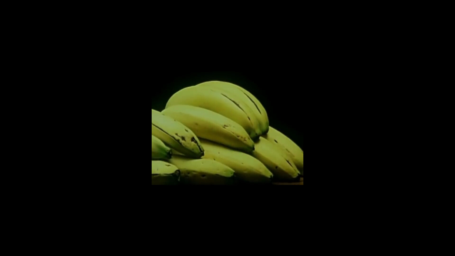

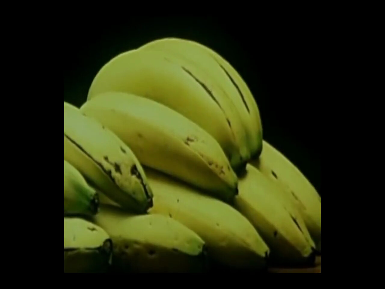

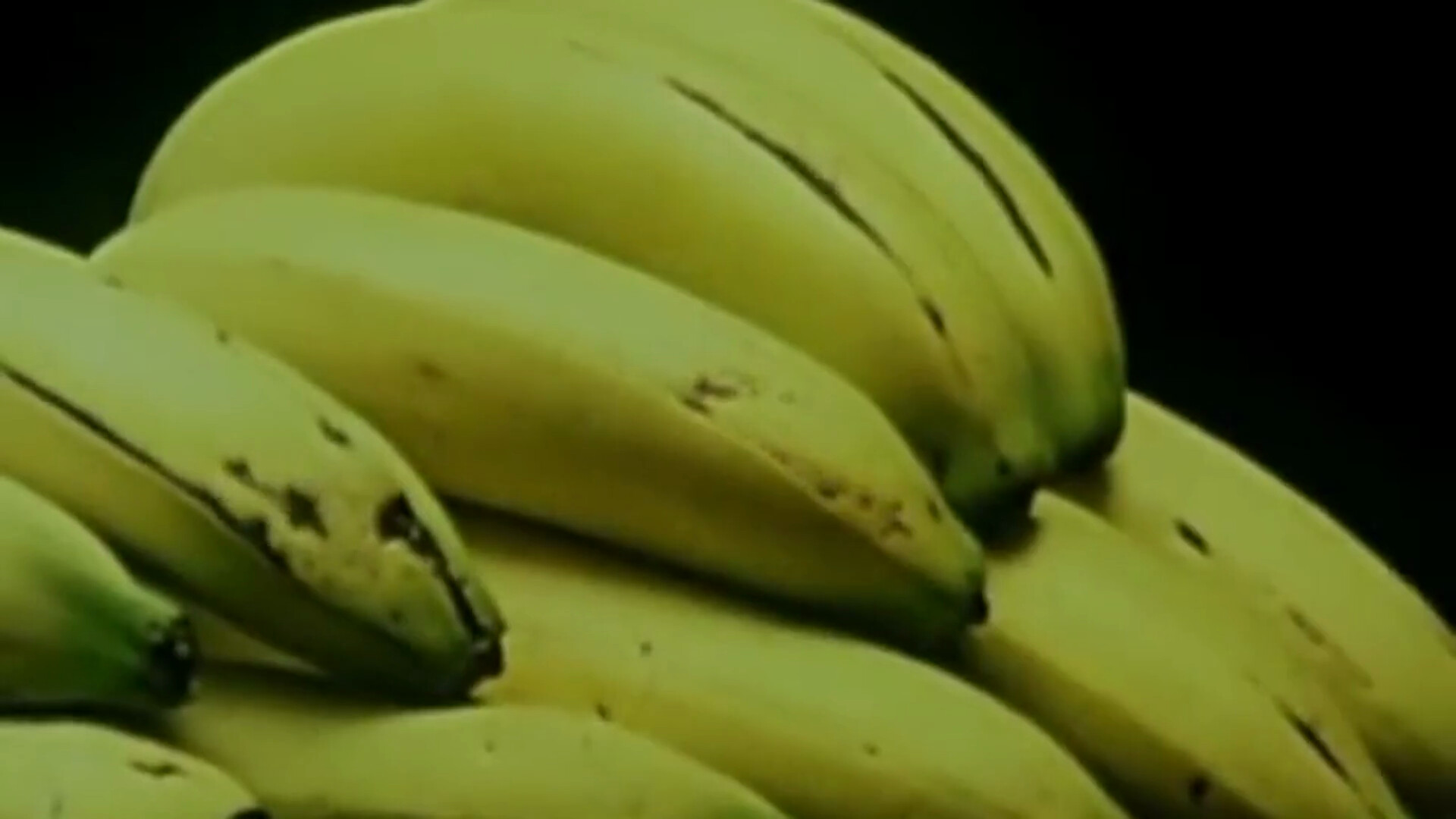

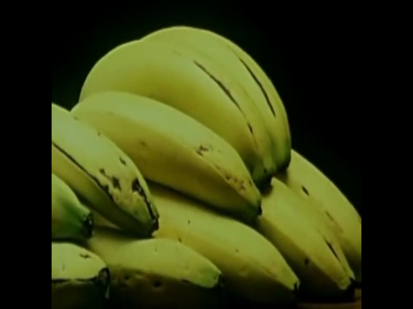

now that even more people will combining two different resolution systems together I think it would be good to start discussing the creative possibilities of that kind of workflow.
so a good starter question is how are you thinking about scaling SD to fit with HD?
I’m assuming the following for these examples
SD = 640 x 480
HD = 1920 x 1080
ffmpeg snippets included in case you want to try yourself.
no scaling, pad to 16:9 screen center
480 center
ffmpeg -i soul.mp4 -vf "scale=-1:480:flags=lanczos,setsar=1,pad=1920:1080:(ow-iw)/2:(oh-ih)/2" soulU.mp4
scale up to 1280 x 960 then pad to 16:9 screen center
480 to 1280 integer
ffmpeg -i a.mp4 -s 1280x960 -vf "scale=-1:960:flags=lanczos,setsar=1,pad=1920:1080:(ow-iw)/2:(oh-ih)/2" aU.mp4
scale up to 1440x1080 then pad to 16:9 screen center
480 to 1440
ffmpeg -i a.mp4 -s 1440x1080 -vf "scale=-1:1080:flags=lanczos,setsar=1,pad=1920:1080:(ow-iw)/2:(oh-ih)/2" aU.mp4
640x480 cropped to 640x360 upscaled to 1920x1080 Fullscreen
480 to 1920 fullscreen
ffmpeg -i b.mov -vf "crop=640:360,scale=1920:1080:flags=lanczos,setsar=1" bU.mp4
there are plenty of other options I’d love to hear any thoughts
you also have the other direction for creativity…
HD>SD
1920x1080 > center crop @ 640x480
1080 center crop
ffmpeg -i a.mov -filter:v "crop=640:480" -c:a copy aC.mov

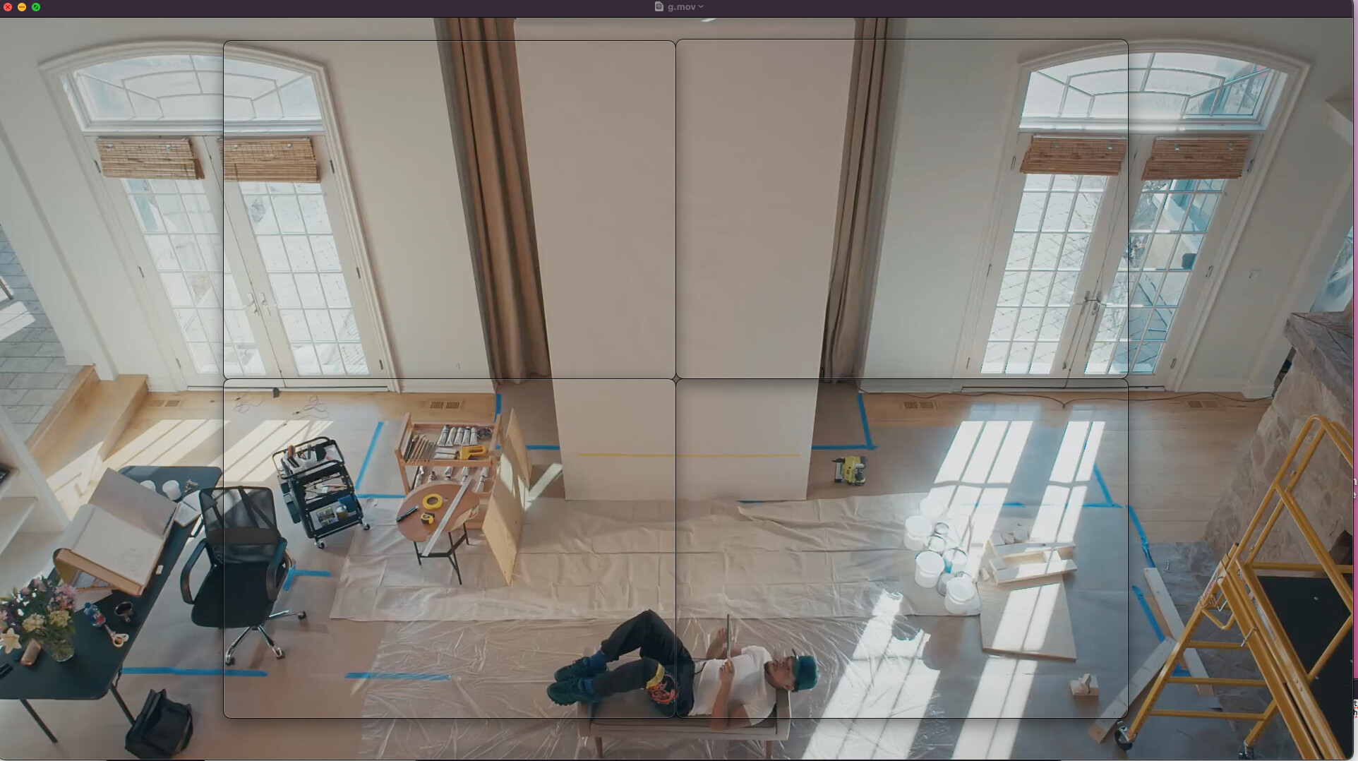

1920x1080 > 4 quadrants @ 640x480 centered
1080 quadrants
ffmpeg -i gc.mov -filter_complex "[0]crop=640:480:380:60[tl];[0]crop=640:480:1020:60[tr];[0]crop=640:480:380:540[bl];[0]crop=640:480:1020:540[br]" -map "[tl]" topleft.mp4 -map "[tr]" topright.mp4 -map "[bl]" bottomleft.mp4 -map "[br]" -c:a copy bottomright.mp4

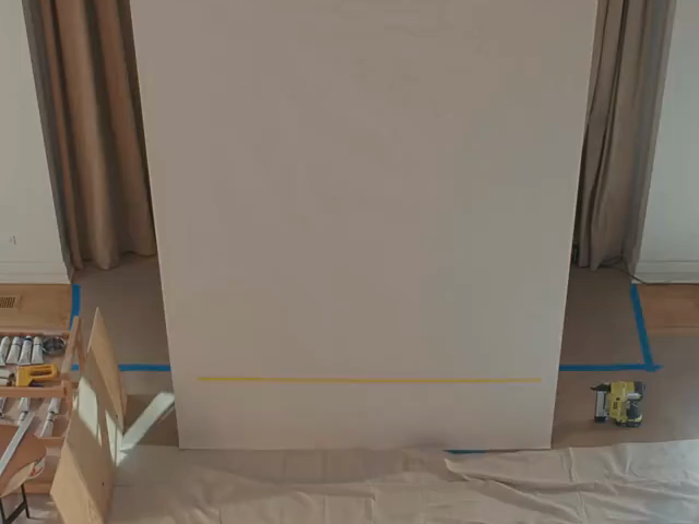

One of the things I like doing with the quadrant outputs is to process them separately and then recombine into a full image. When I’m back at my main computer I can post a version I did using regular and predictive datamoshing on different quadrants.
#4 — nerdware · 2022-12-29
Speaking of… Quadrants 2022-11-30 UHD2160
#5 — wednesdayayay · 2022-12-29
yes!!! now this is what I’m talking about what a cool way to think about upscaling
I’ve got to give this a shot
I’d like to try a 2x1 version where you have two 960x540 videos on top of each other on the left side and one 1920x1080 under the whole thing to show through on the full right side.
