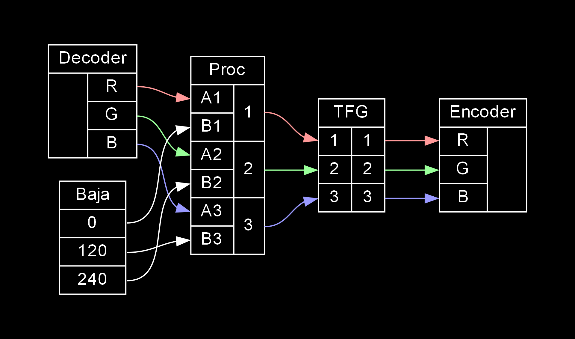

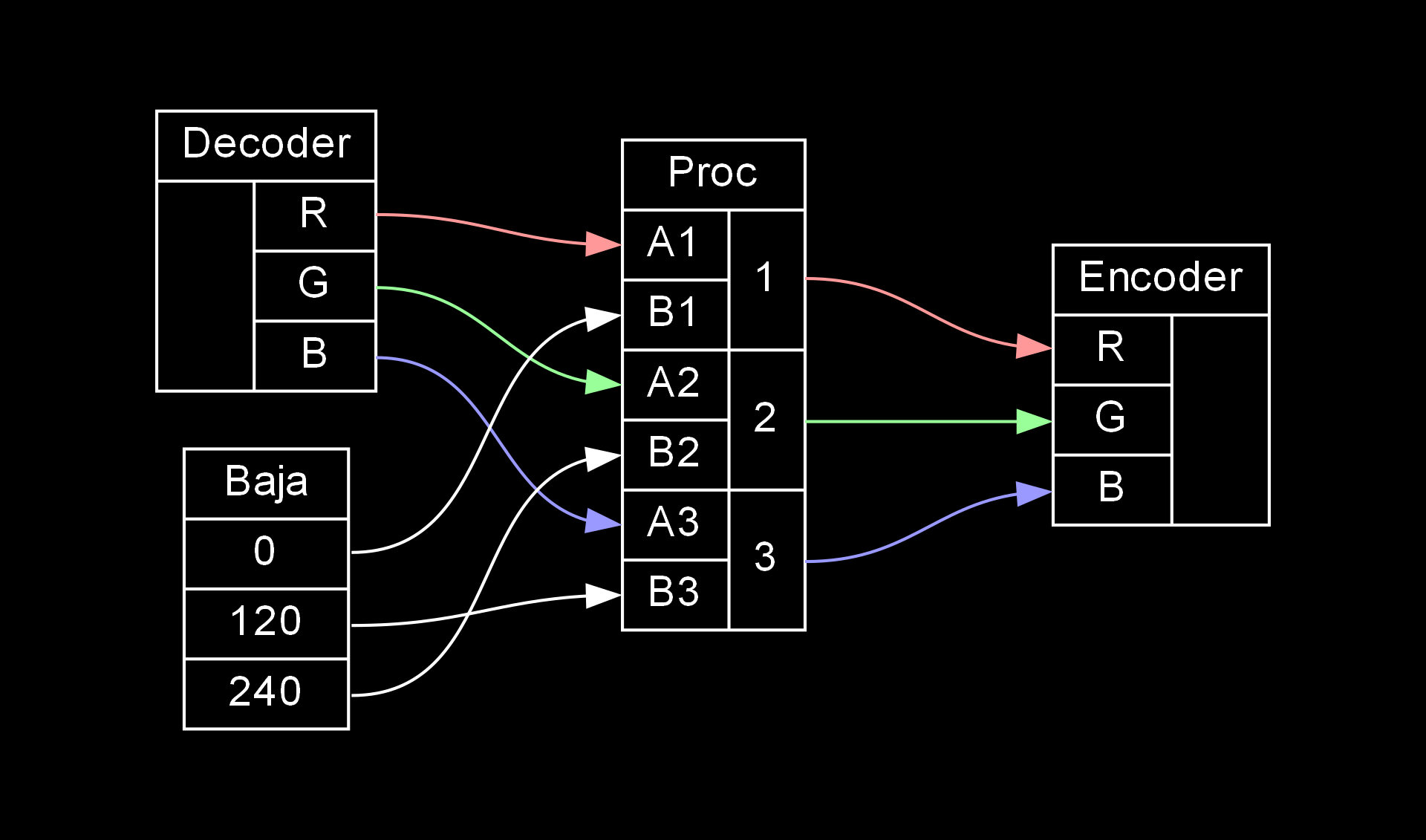

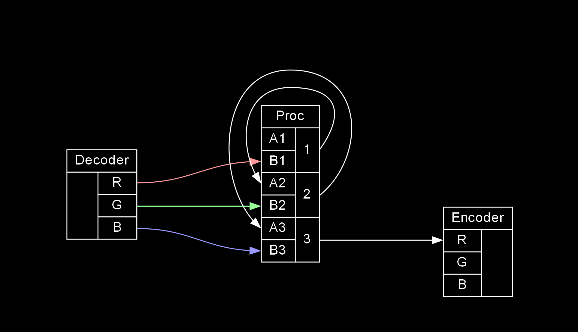

Heyo, I’ve updated the Proc video for accuracy, added patch diagrams and pro tips. Cheers!
baja_proc_01_video
baja_proc_02_video
proc_03_video
