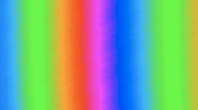

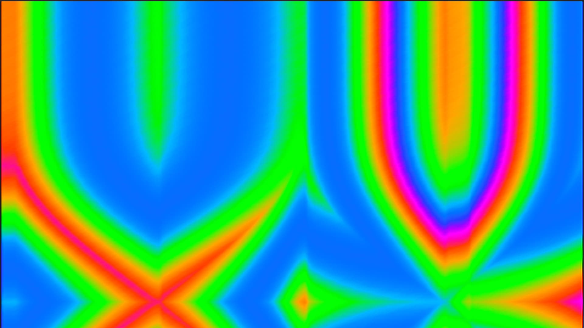

Installed DWO3 today, still working on testing it, but seems stable and clean so far. I removed Chronenberg / Scanners and the noise in my Mapper was gone, reinstalled it and it’s back. Using rail power from the TipTop Mantis case, but it shouldn’t be at fault here. I do have the DC module and can try that with some case remixes, but feel like something is amiss somewhere on the module, as I’ve never seen interference this bad with anything else. (note that Visual cortex is in the same power group and don’t see any interference in it’s outputs, I believe there should be no issue with amount of power, but haven’t double checked yet)
Here is a clean mapper
and the diagonal interference once Chronenberg is installed next to it on same power system (not being used at all in patch)
it’s a bit hard to see when recompressed by Vimeo, here is screenshots
Screen Shot 2023-01-24 at 11.43.20 AM
Screen Shot 2023-01-24 at 11.43.28 AM
#14 — Dr_Rek · 2023-01-24
Installed Shutter next to mapper and moved Chronenberg to the other case, but still seeing interference in Mapper… Tried removing shutter and now interference is still there when it was gone before… hmm maybe something about Mapper? super weird, doesn’t seem to be specific to other third party module combos
Note that I had tested this with Mapper going direct to ESG3, and when there was interference present, in previous tests I found using the input source ramp that was going to mapper direct to esg3 was clean, thus Mapper is where it’s happening.
I moved Mapper to a different power bus and it’s looking better for the moment
