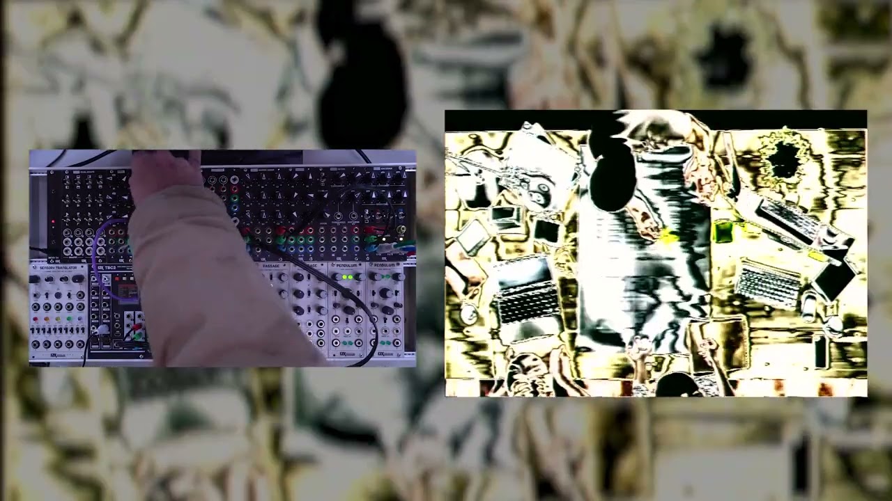

#25 — Z0NK0UT · 2023-02-20
Illustrated!
https://www.youtube.com/watch?v=CZx8ssyfYds
#26 — joem · 2023-02-21
That colorizing patch at the end! Wow. It made the Swatch jump a lot higher on my modules-to-buy list.
