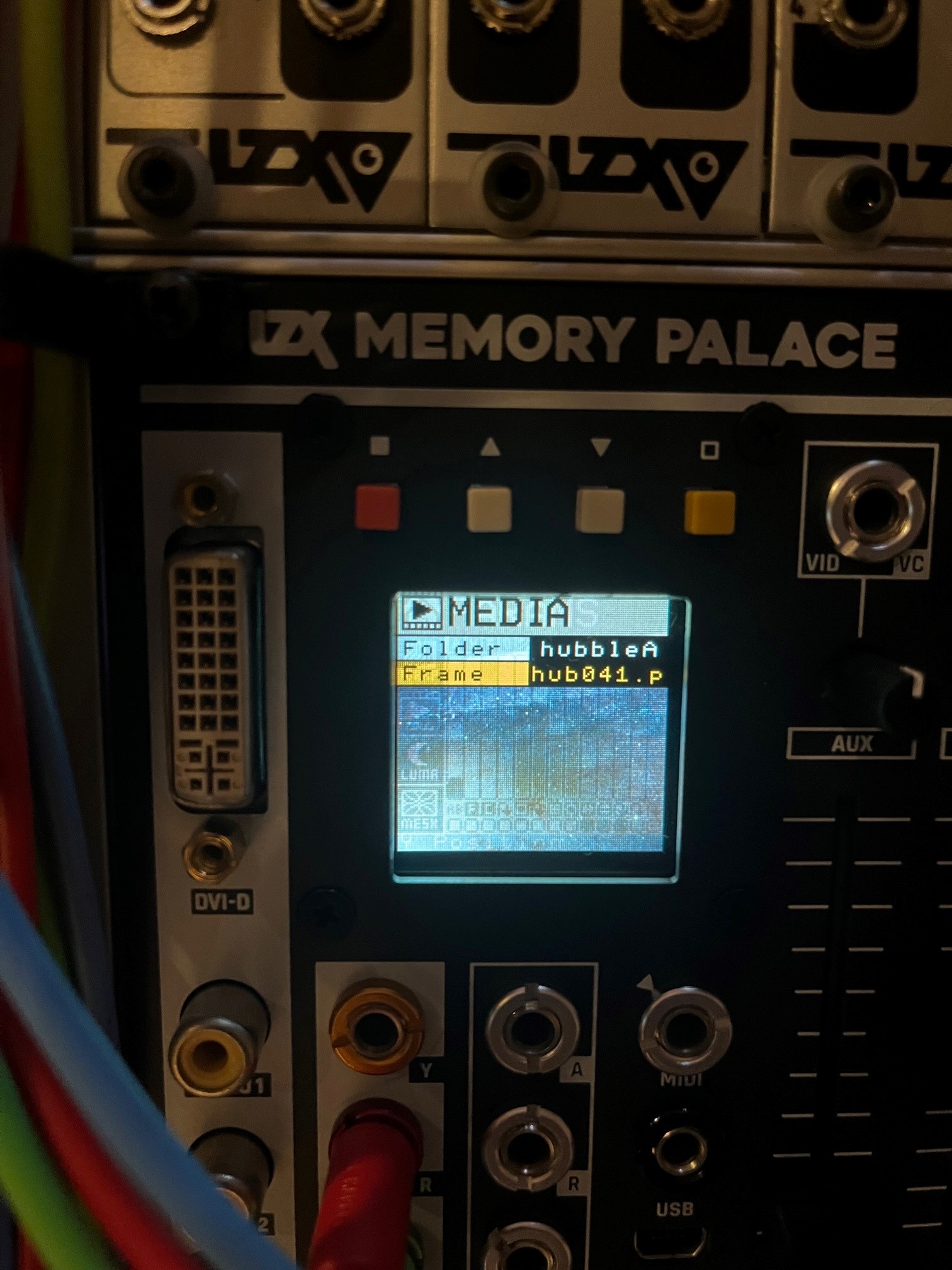

#17 — monads · 2024-01-11
Just sharing a photo of screen burn-in. Wish screen saver mode was implemented
:frowning:
TBC2 owners should expect the same down the road w/o screen saver mode.
