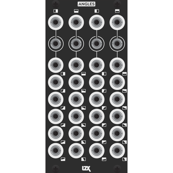

Also:
LZX Industries
https://lzxindustries.net/products/anglesANGLES is a 12HP ramp generator with 24 fixed outputs at 15 degree increments from 0 degrees (H-Ramp) to 345 degrees. It can also be used as a general purposed fixed ratio mixer by patching the inputs. It's a protractor for your patch! LZX Gen3...
Price: USD 329.00
Link: ANGLES
