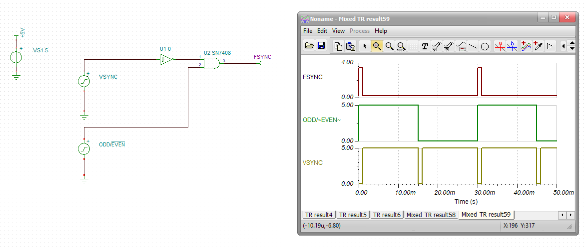

Frame Sync Extractor
What do we do if we want a pulse that starts at the beginning of each frame? We can’t use VSYNC, as in interlaced formats it pulses twice per frame, at the start of each field. This simple circuit uses the ODD/~EVEN~ field flag, VSYNC, a NOT gate and an AND gate to create a positive-going pulse at the start of each frame. This signal is useful for feeding to clock dividers or sequencer clocks. Since the ODD/~EVEN~ flag is high when the input format is progressive, all of the VSYNC pulses are passed to the output.
LMH1980_FSYNC

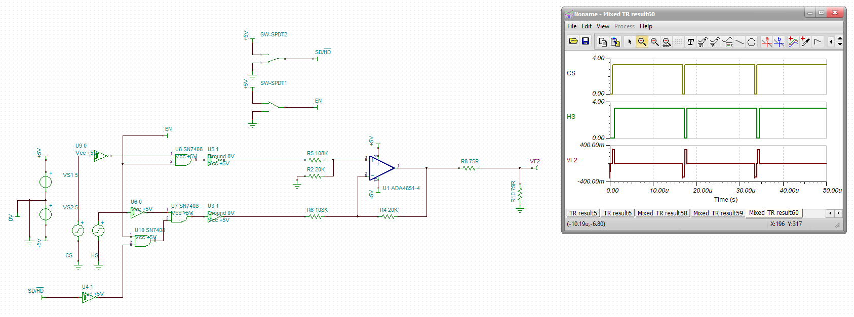

Trisync/Csync Regenerator
HD sync formats require a tri-level sync pulse with both negative and positive going spikes, instead of just the negative pulse of the SD formats. The circuit below generates +/-300mV Trisync or -300mV Csync and buffers them for distribution to the sync inputs in your system. Note that the SD/~HD~ flag outputs are used to disable the use of HSYNC as the positive trisync level when SD video is detected.
It can probably implemented with less logic gates; I am only being careful here that propagation delay is identical relative to both sync signals.
