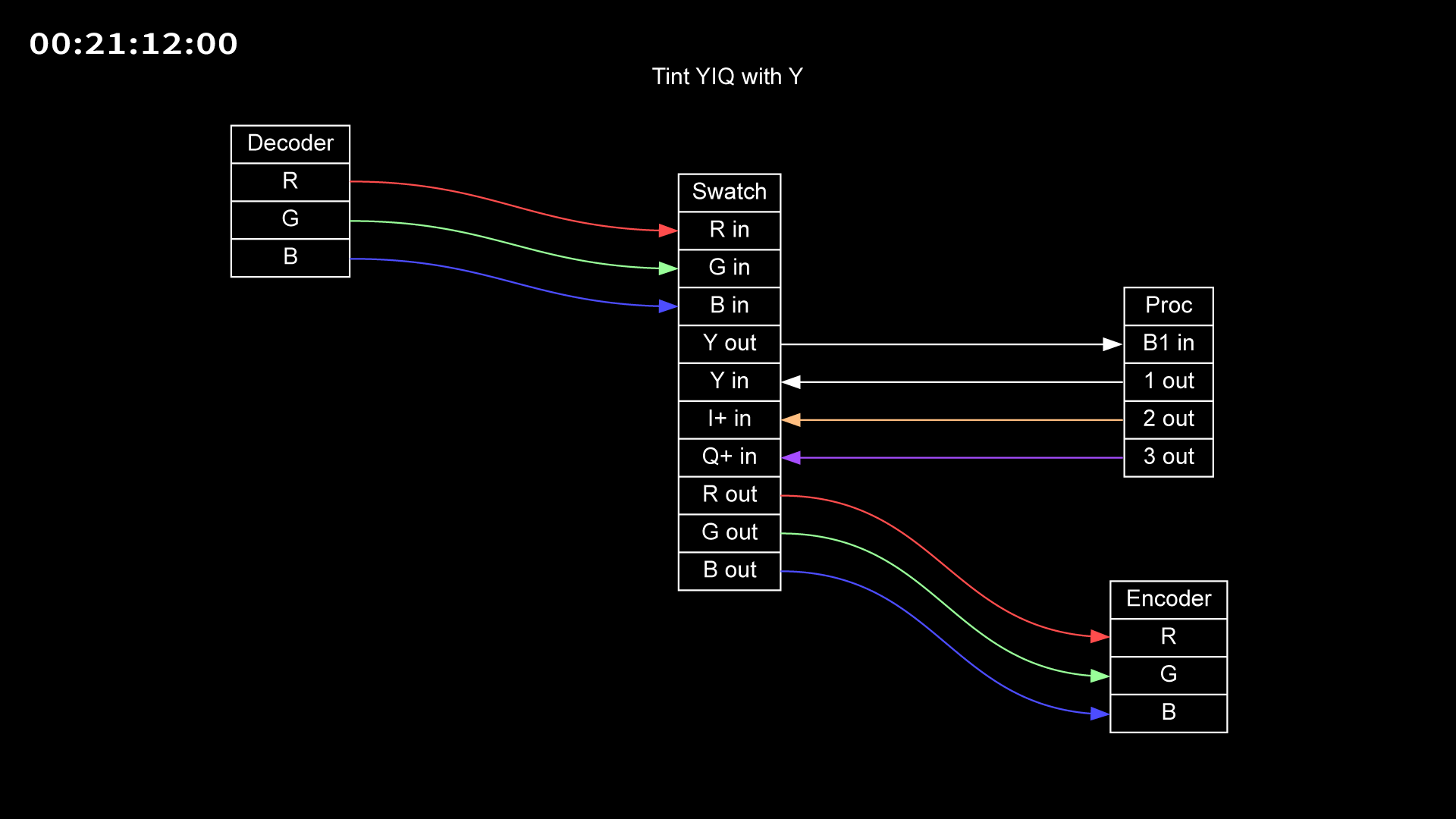

21-12_tint_YIQ_with_Y

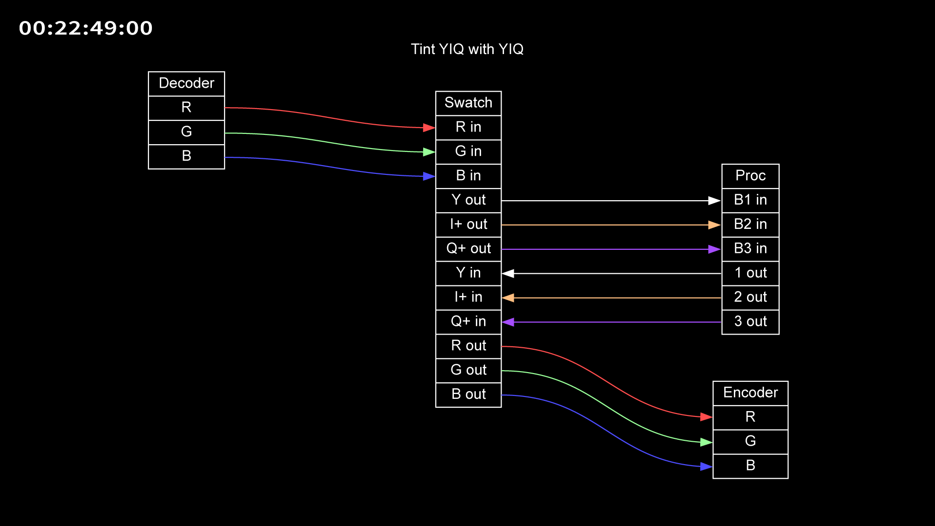

22-49_tint_YIQ_with_YIQ

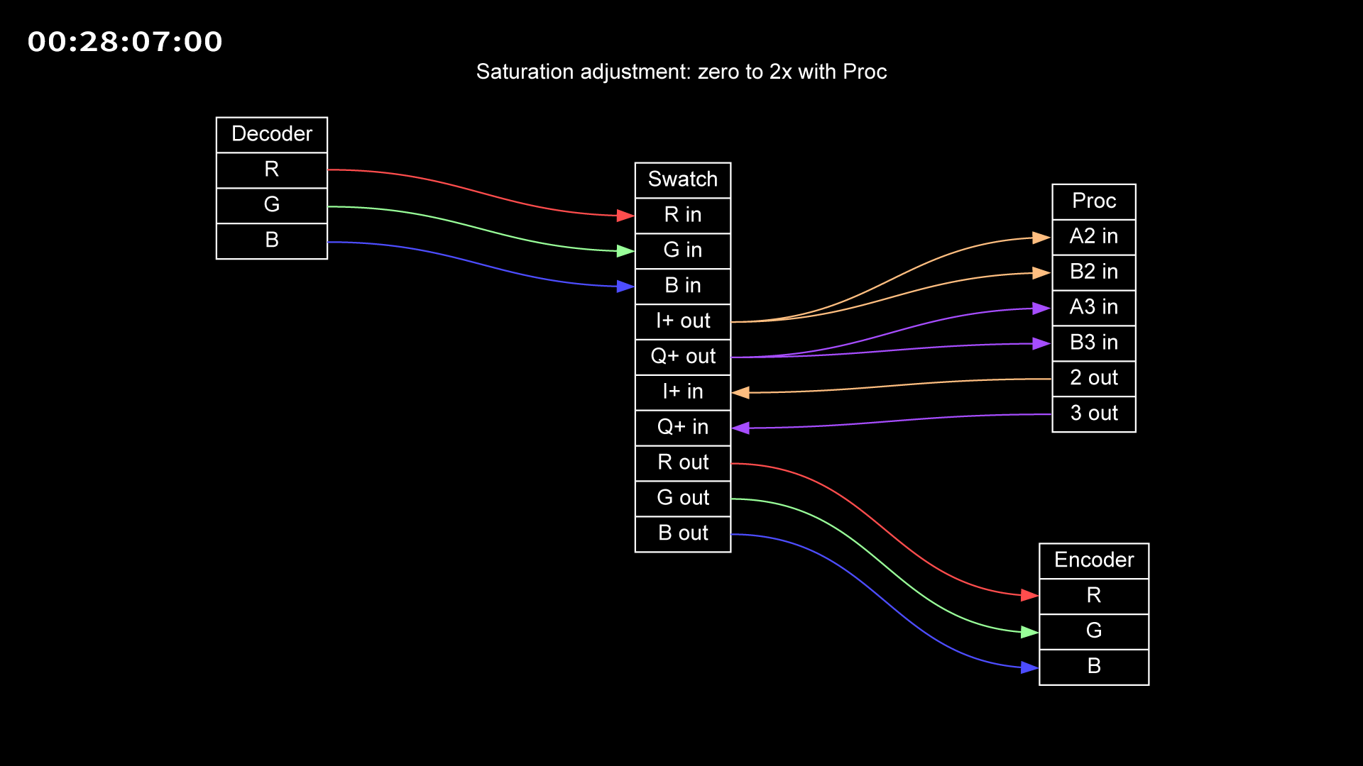

28-07_saturation_adjustment_with_proc

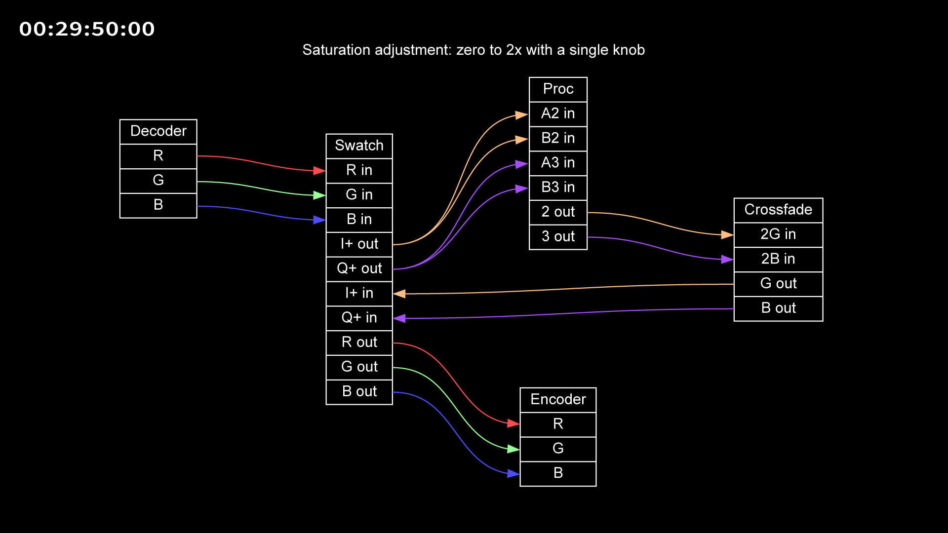

29-50_saturation_adjustment_with_crossfade

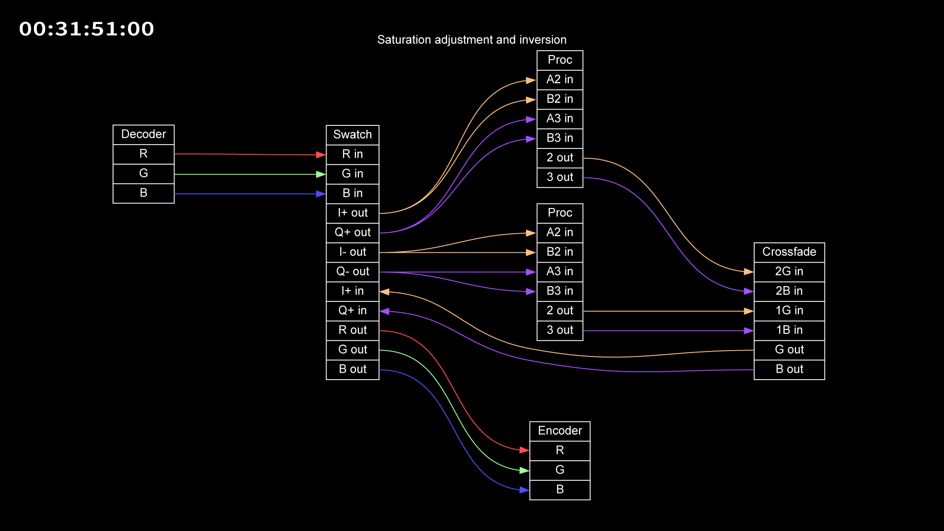

31-51_saturation_adjustment_and_inversion

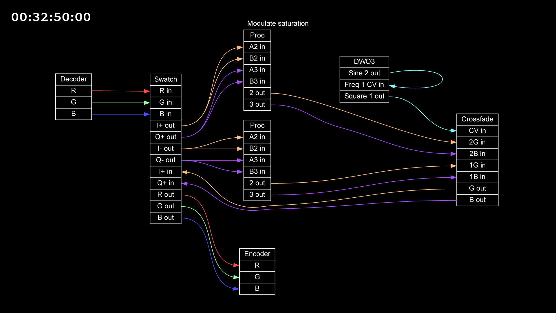

32-50_modulate_saturation

quick note. crossfade null setting for cv would be 12 O clock

Yeah I realized my mistake during editing but didn’t know what to do about it. Maybe I can add a lower third. The great thing about Vimeo is I can update the video and the URL stays constant.
