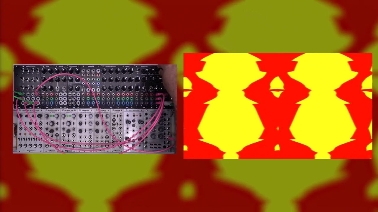

The patch book is still a work-in-progress, but the first link gives you a good idea of how to begin with ESG3 and DSG3. Be sure to watch the DSG3 Youtube video to see the module in action.
https://www.youtube.com/watch?v=hFIWKNjcbPg
