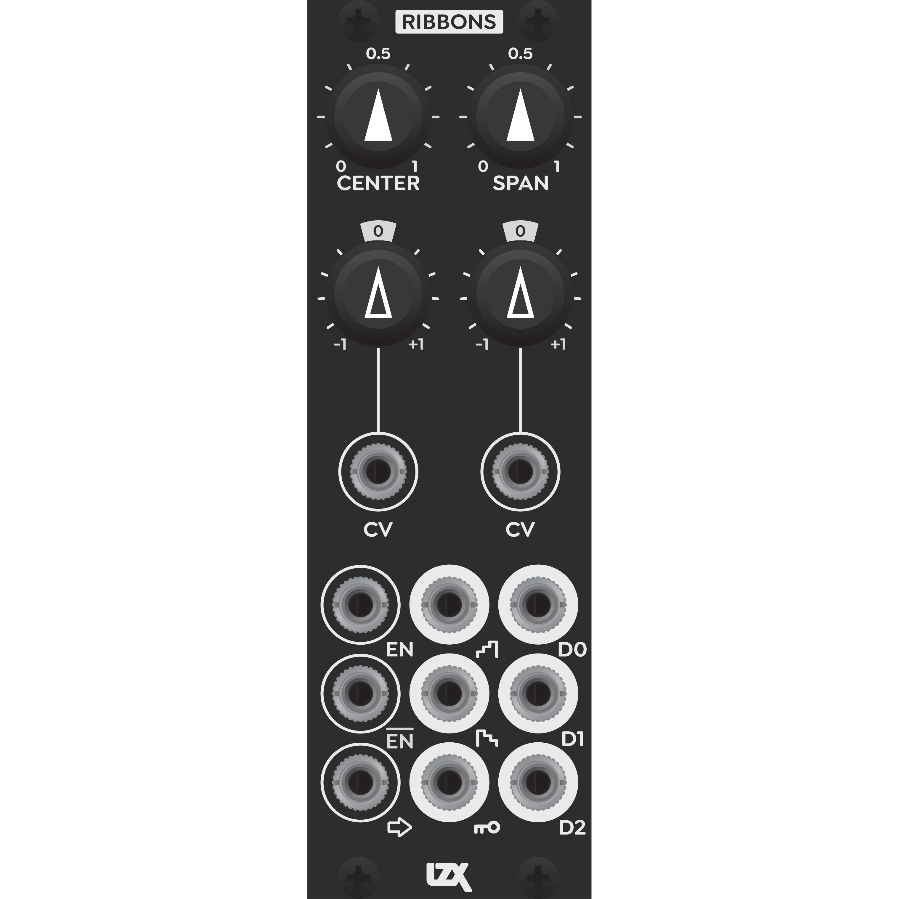

Facebook question: I’m guessing the lower left jack (arrow) is the input to be digitized? And D0, D1, and D2 are equivalent to the similarly named outputs on the Castle ADC. And I’m guessing that Center and Span are equivalent to Bias and Gain from the Castle ADC so the CV inputs are CV controls over that. But what do the other jacks do (EN, ~EN, ramp up, ramp down, and key)?
Lars answer: You have the input and D0-D2 output correct. The center & span controls are a bit different. They are a new analog CV processor design with thru-zero modulation of span. The outputs of this internal circuit generate upper & lower thresholds. The area between the upper and lower thresholds is sliced into 8 equal bands, and then encoded to a 3-bit number. When Span goes negative, it inverts – allowing you to create ADC patterns that compress and expand under modulation (to do this with Castle or Fortress, you needed external VCAs). The Ramp up/down are DAC outputs (stair step waveforms) and the Enable/Disable inputs are video rate masking inputs to enable or disable he outputs (so it’s like having a compositor built in, so that you can combine or exclude the outputs from an external key/mask source.)
