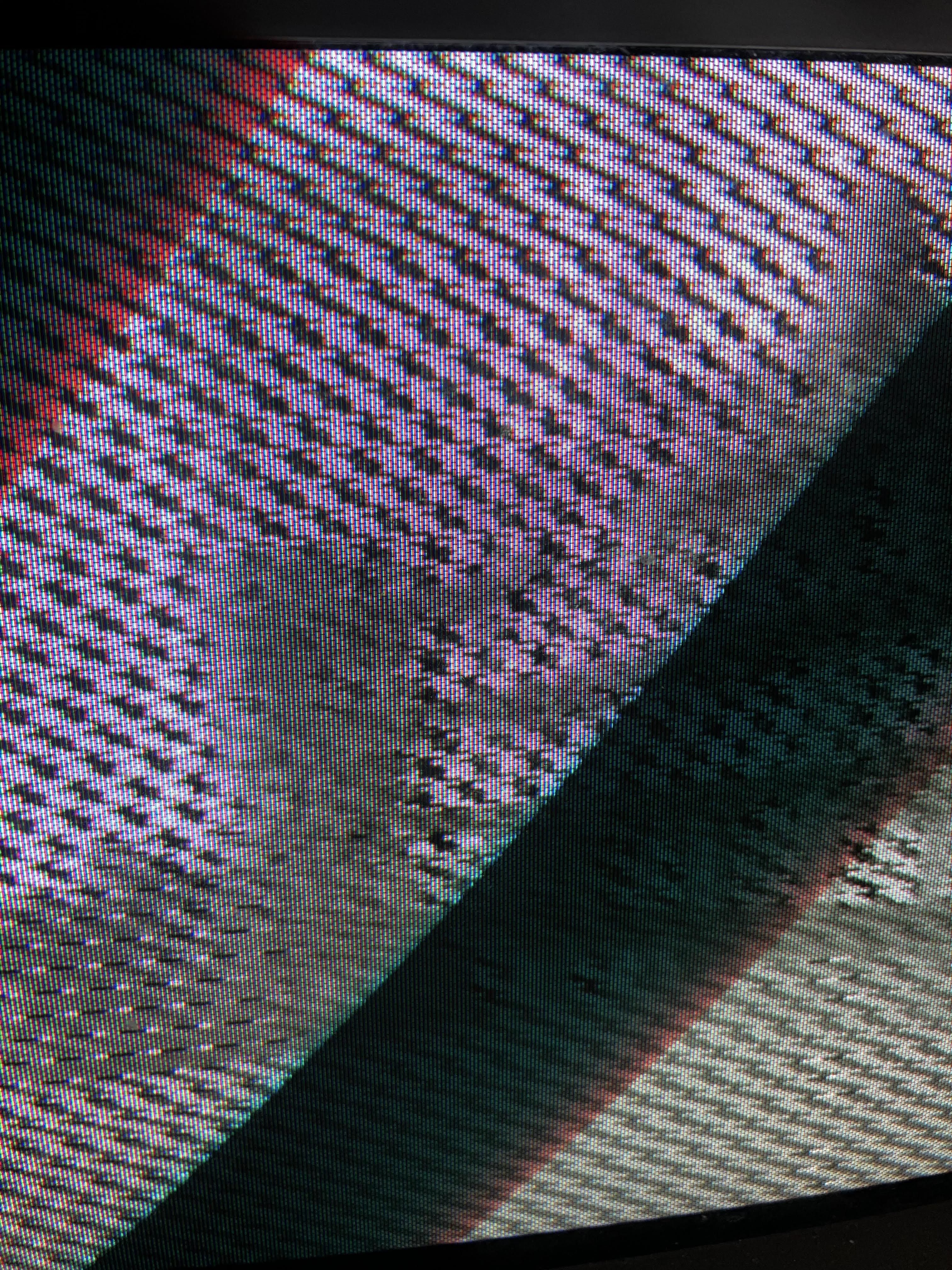

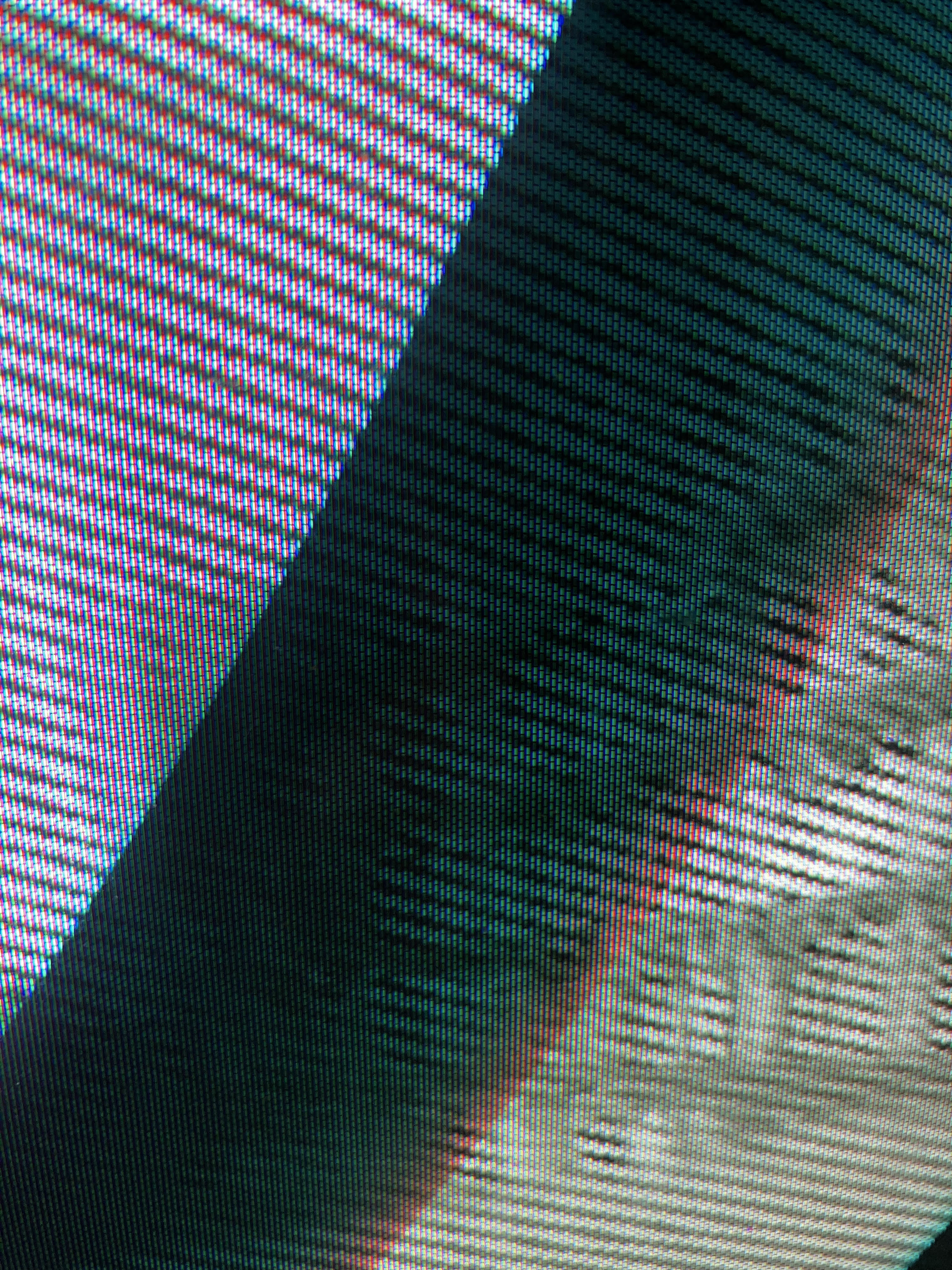

The behavior is that the output is noisy and B&W.
Tried different things:

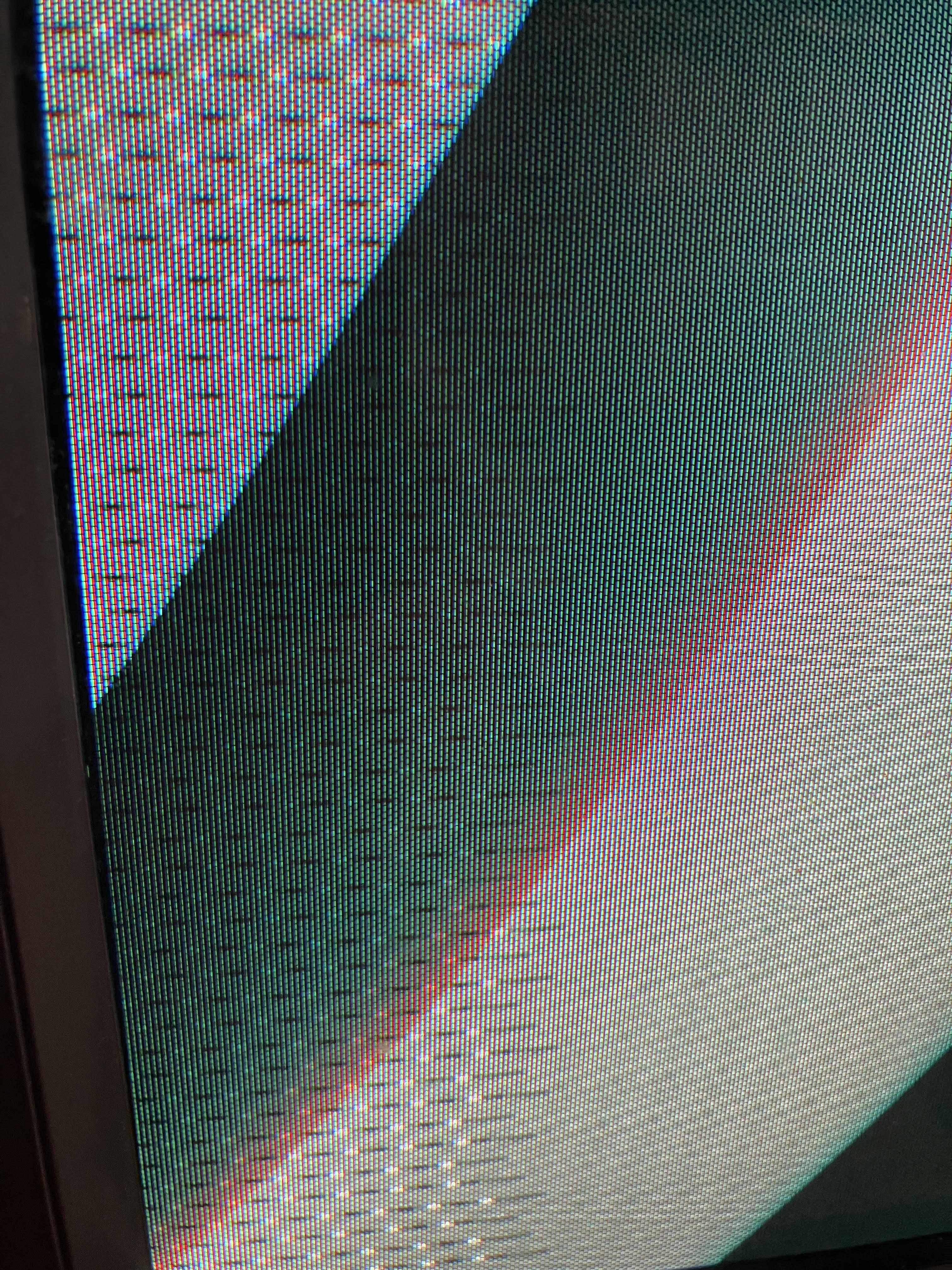

  1. No input, Encoder connected to Sync generator → B&W screen, noise (dotted lines) on the left side with Encoder set to PAL, no noise with Encoder set to NTSC (strange because the monitor is PAL)
RGB_putput_with_sync_no_input_PAL

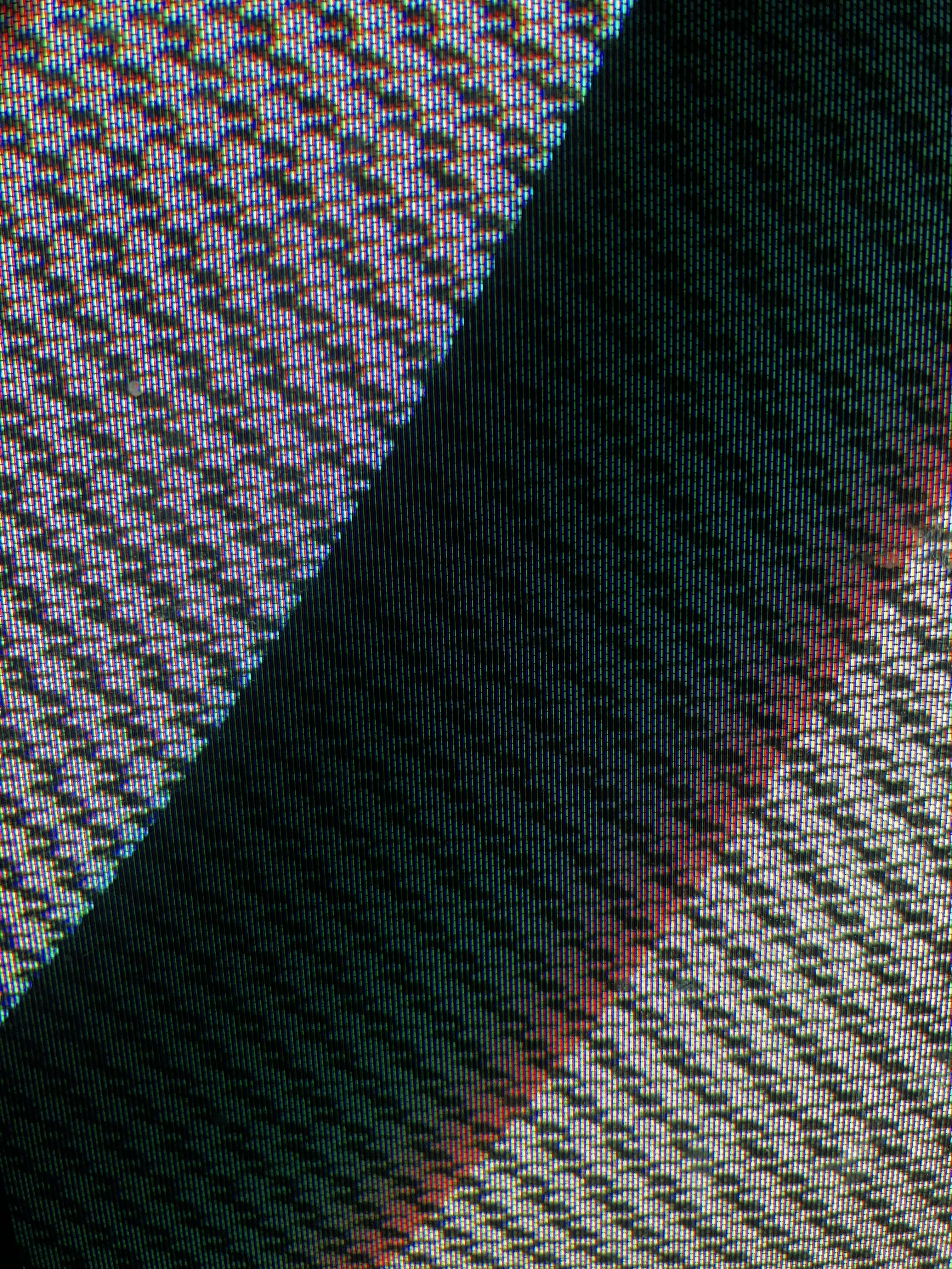

  1. Cadet Processor as input, Encoder connected to Sync generator, Encoder = PAL → B&W screen, noise (diagonal saw-like lines)
RGB_putput_with_sync_Processor_input_PAL

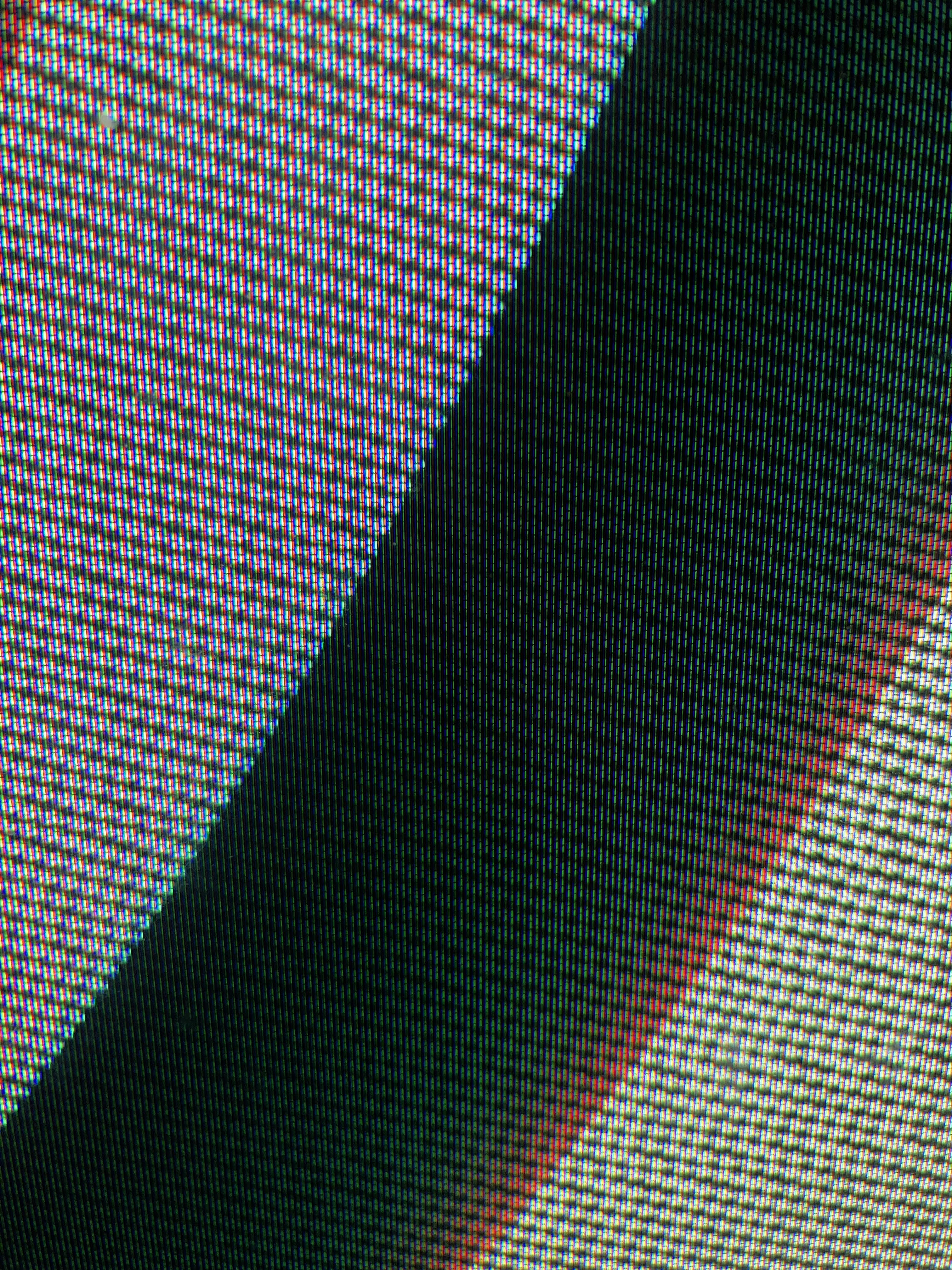

  1. Cadet Processor as input, Encoder connected to Sync generator, Encoder = NTSC → B&W screen, noise (diagonal more straightened lines)
RGB_putput_with_sync_Processor_input_NTSC
  1. Camera as input (via Cadet III), Encoder connected to Sync generator, Encoder = PAL → B&W screen, camera output is visible and more-or-less in sync, noise (diagonal saw-like lines)
RGB_putput_with_sync_Camera_input_PAL
  1. Camera as input (via Cadet III), Encoder connected to Sync generator, Encoder = NTSC → B&W screen, camera output is visible and more-or-less in sync, noise (diagonal more straighten lines)
RGB_putput_with_sync_Camera_input_NTSC

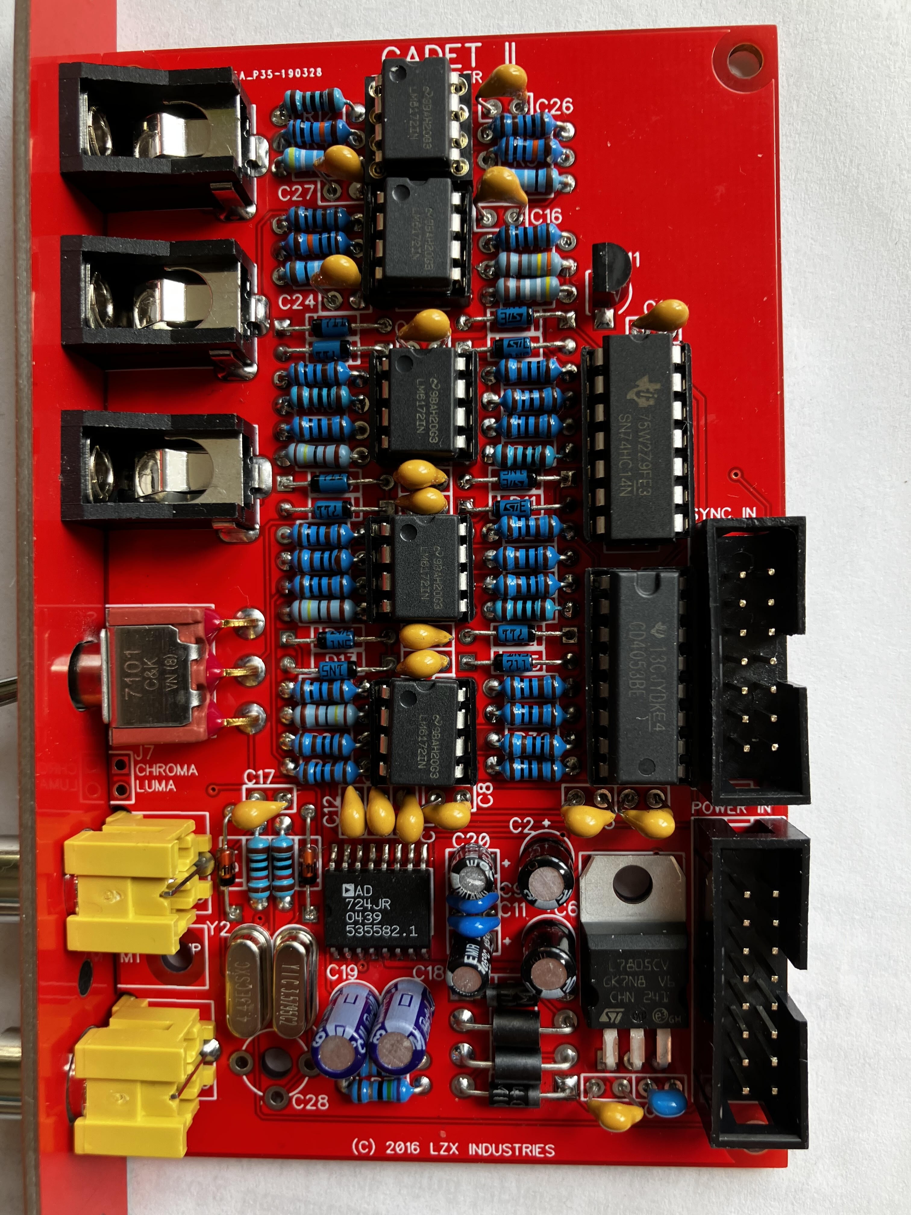

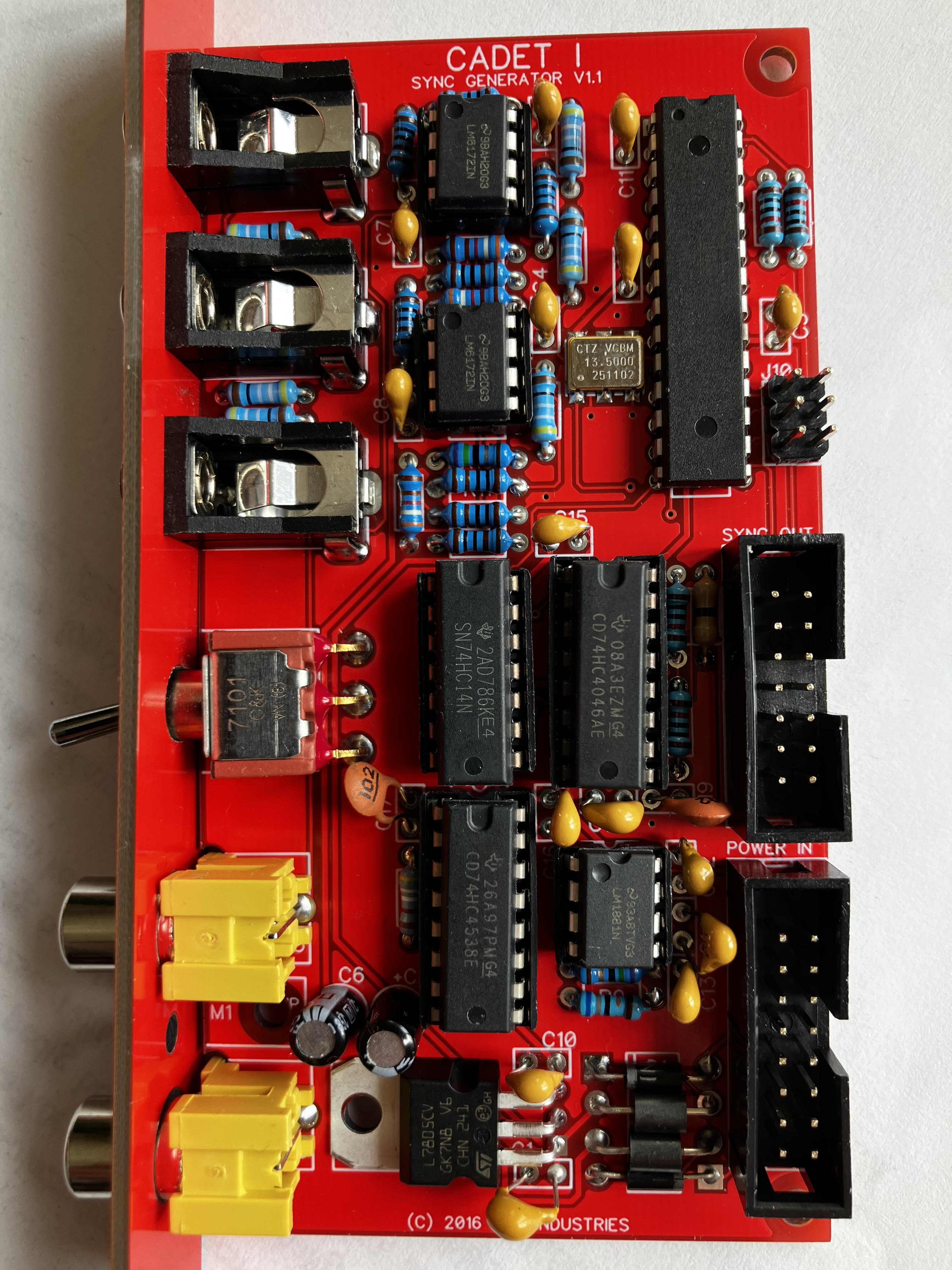

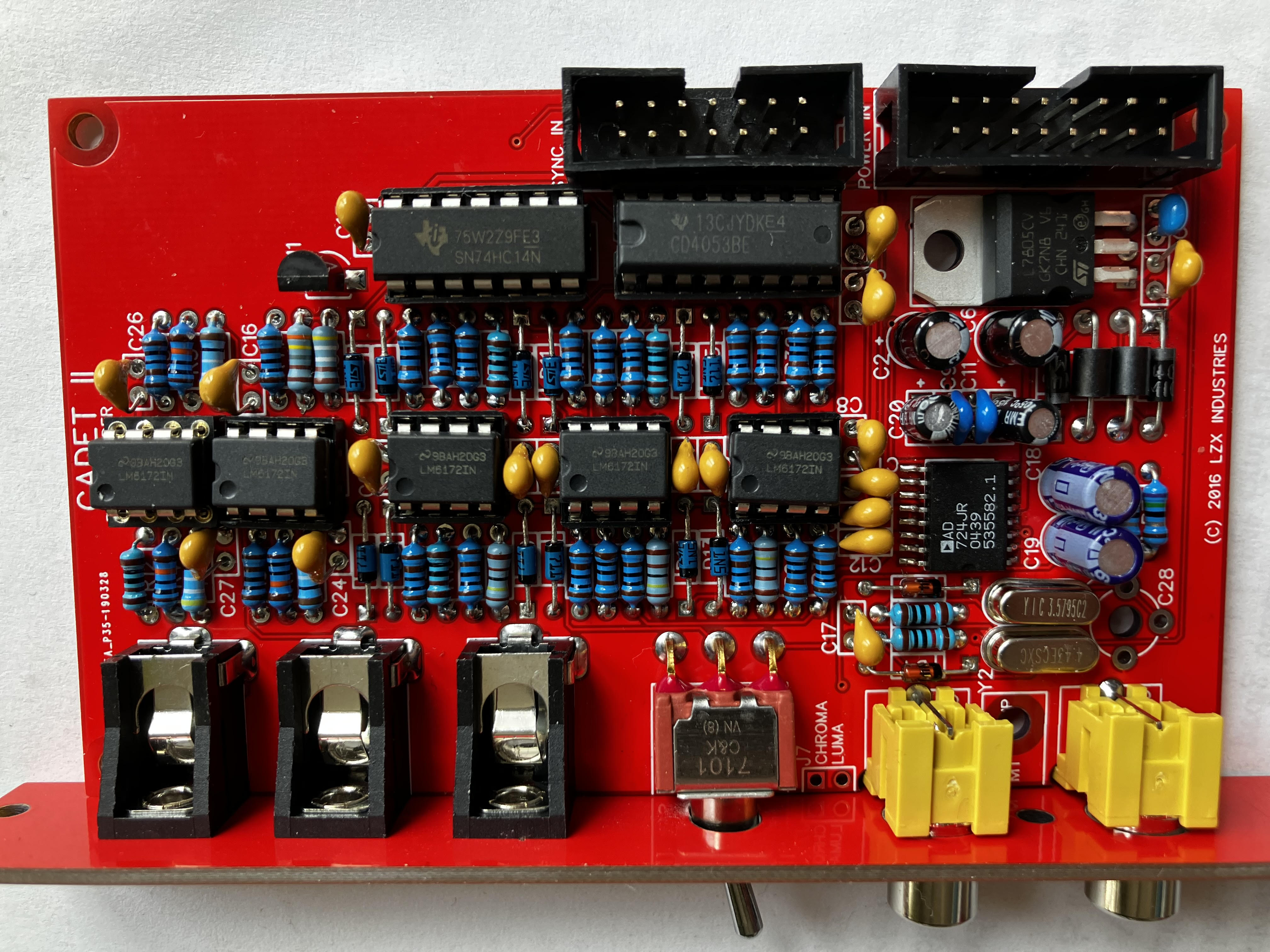

Pics of the PCB also attached:
Cadet_II_02
Cadet_I_02
Cadet_I_01
Cadet_II_01
Any suggestions on where to start fixing it?

Seems like the color subcarrier is out of spec. I see you have C17 populated, does it change if you remove it? It is listed as DNP in the BOM, so it should work without it. I had a similar issue on VU007B, mostly on the production/SMD version, some units would display black and white with similar noise as you have, the solution was adding a small capacitor (2.2pF) in parallel with the crystals (same spot as C17 on Cadet II). There might be some variation between AD724s and also the layout seems pretty critical, as a few pF can deviate the color subcarrier frequency enough that it cannot be picked up by the receiving device.

#4 — videotom · 2023-05-02
ohhh, thanks for the hints!
good question how I missed this C17…
I will try to remove it and see if it solves the problem
#5 — videotom · 2023-05-02
Bastien, you’re a genius!
That was the problem! Now everything works fine!
#6 — syntonie · 2023-05-04
Good to hear you got colors now! The captures you sent looked oddly familiar with what I had experienced, the noise is actually the subcarrier being interpreted as luma since it’s outside of the tolerated frequency range of the AD724.
Out of curiosity, what was the value of the capacitor placed in C17?
When debugging VU007B units, I did try 10pF initially and it was too much, 4.7pF did work on a few units but not all, so in the end 2.2pF was the right value in my case, it’s crazy that a tiny change in capacity has such a drastic effect. Cadet II anticipated this with C17 and also a trimmer capacitor, C28, so it could be tuned precisely if there was too much frequency deviation, but looks like the layout was made right so both capacitors ended up in DNP (do not place).

not even close to pico… it was a standard 0.1 uF (104) capacitor (don’t ask me how did I find this for C17
