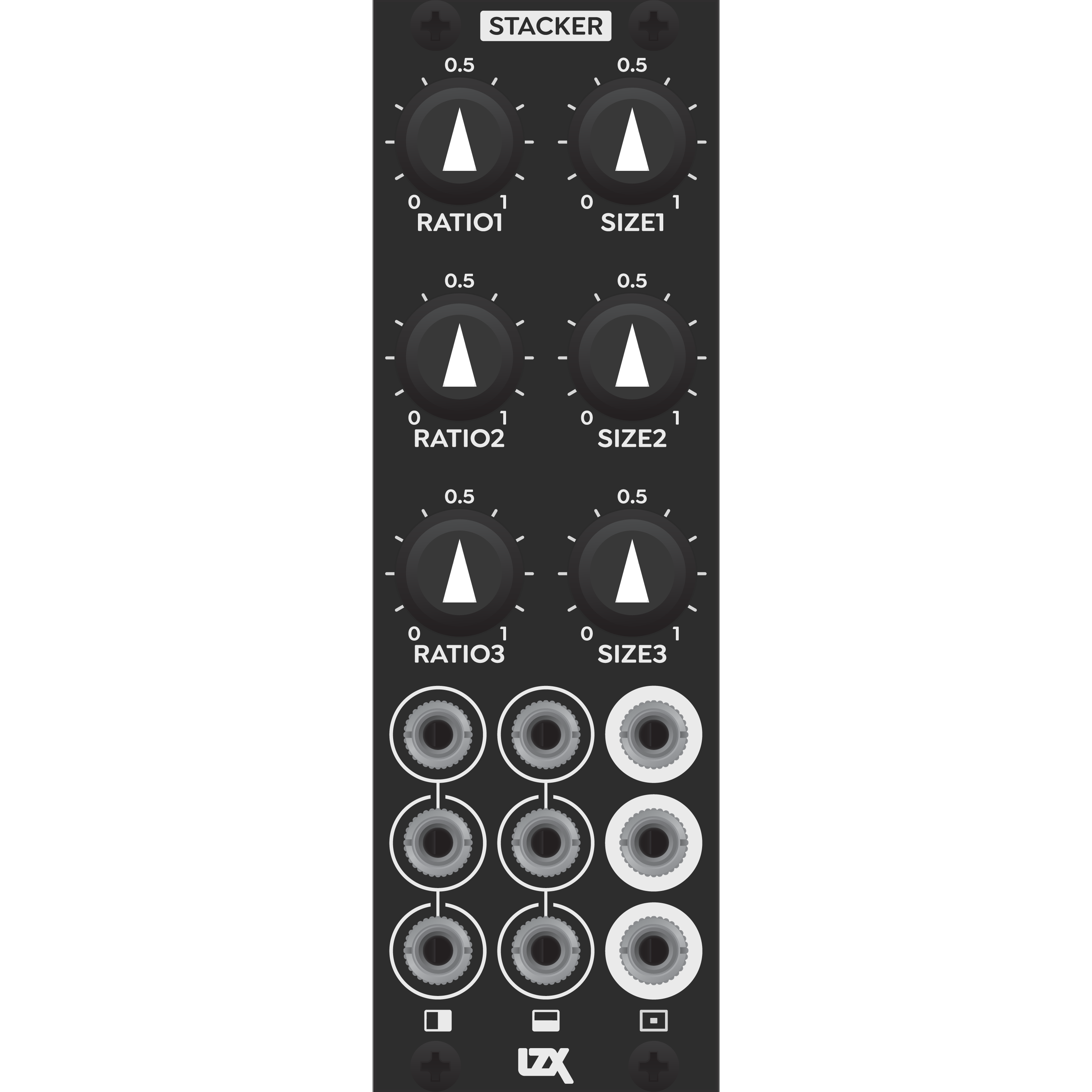

https://lzxindustries.net/products/stackerStacker is a triple quadrilateral key generator and priority compositor. LZX Gen3 Design Standards Long lifespan jacks Integrated ultra low noise power ...
Link: Stacker | LZX Industries

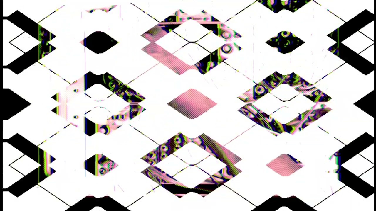

Stacker will fill an interesting niche in a lot of systems – and 3x quadrilaterals in 8HP provides a big impact with tools like Angles, DSG3 and DWO3. I think of it kind of like a tool to generate mosaic fragments.
How do you modulate it?! Mixers and VCAs before the HV inputs. For example, Proc would give you voltage controlled XY position, if a CV or bias is applied before a ramp is then patched to Stacker. We have some motion control modules planned that will fill this role well.

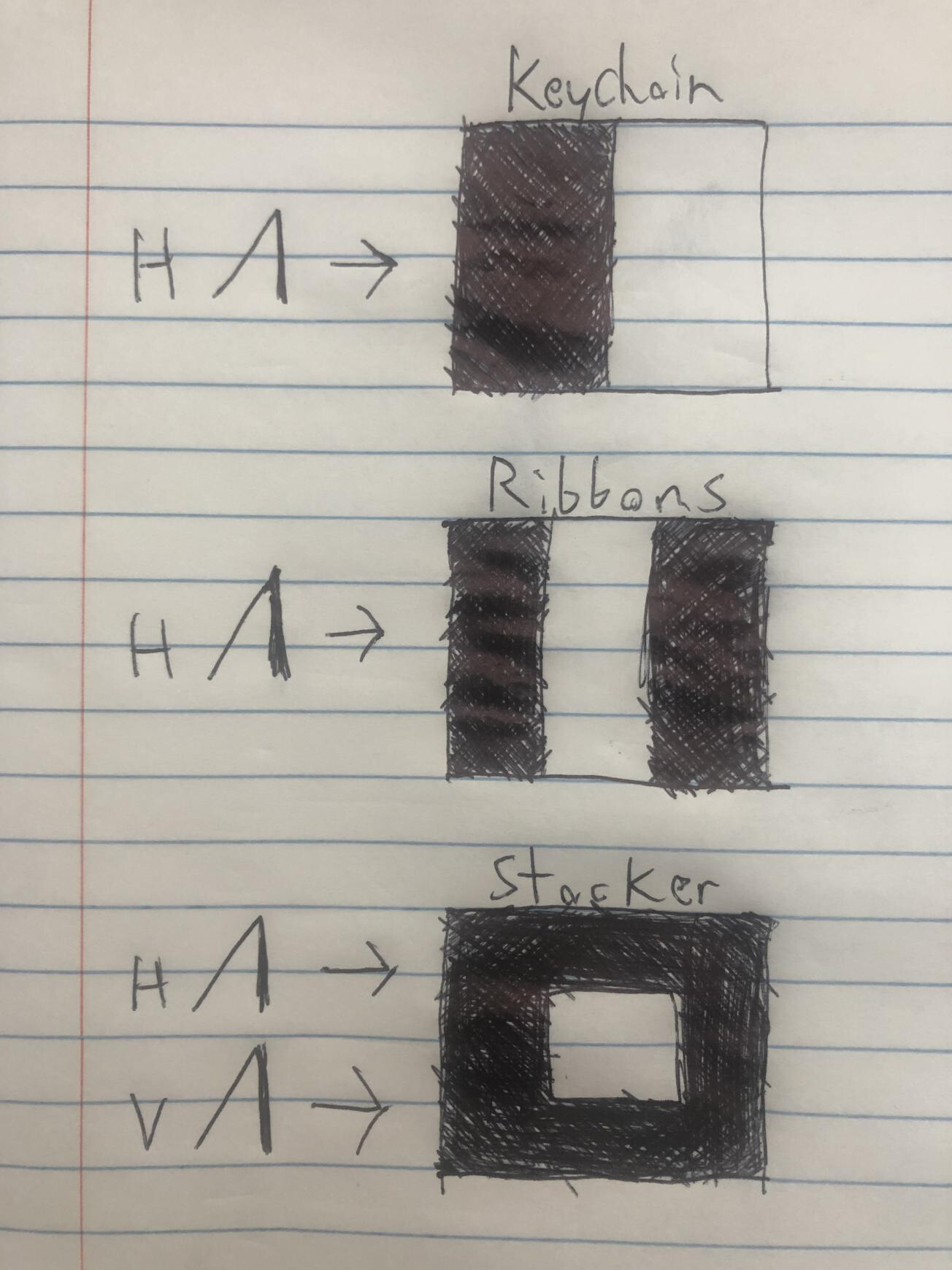

Keychain has one threshold (hard keyer), Ribbons has two thresholds (hard window keyer), Stacker has four thresholds (hard quadrilateral keyer).
#5 — joem · 2023-05-12
Thanks. That definitely helps.

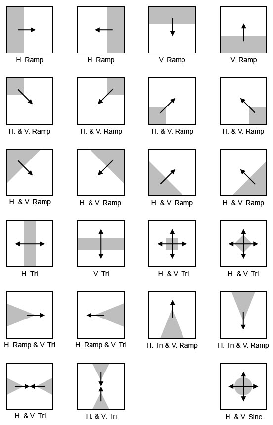

Dave Jones’ wonderful guide to making shapes from ramps rears its head again!
Yes, the most efficient way to get a keyed square with discrete functions is frequency doubling (mirroring) your H and V ramps to get triangle waveforms, then hard keying each triangle ramp separately and lastly combining those two signals with a logical AND / maximum. The last step could also be done by summing your two keyed triangle ramps with a mixer and then hard keying them one more time. The brightest area where the two overlap is where you want to set your threshold.
You could gain additional control of the bounds of your keyed square by not frequency doubling the ramps but adding additional hard keyer stages and logical AND / maximum (or summing + additional hard key). This is basically window keying so that you can independently set the left / right bounds of the H ramp and top / bottom bounds of the V ramp.
EDIT: Replaced the incorrect ORs with correct ANDs, whoops.
#7 — joem · 2023-05-13
Wonderful! That clears it up perfectly for me! Thanks so much @rempesm! That helps me better understand what’s going on in those demos videos.
