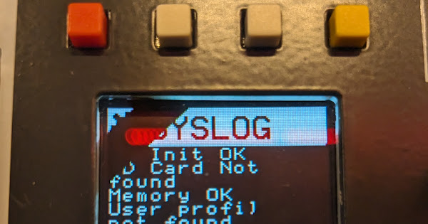

1st problem:
tried to format it and use some others, but without success - tried to enter via usb-port, which gives me access to the device folders /jsn with media.jsn & system.jsn - tried to install a recent firmware but the device crashes at boot time - also cleaned the SD slot :[
visibly the device seems to be in good condition

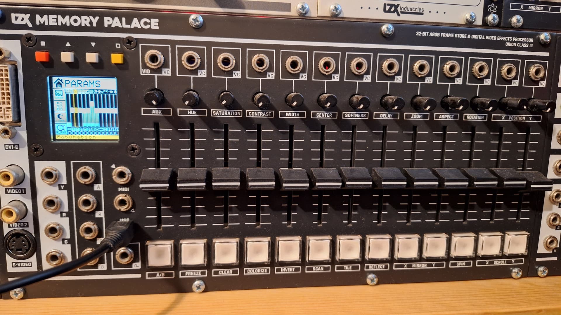

https://photos.app.goo.gl/pjdJvgSVQPPR799v52nd problem
the faders seem to be out of calibration and wiggle by themselves slightly

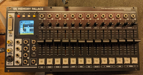

Google Photos
https://photos.app.goo.gl/QgKWM8KAuhWZMu388 Google Photos
https://photos.app.goo.gl/17Ws3aE9hsN4t1Zp6Thank you very much for your tips and advice

Sorry the MemPal is giving you trouble. What are the specifications of the SD card(s) you are using?
You can recalibrate the sliders by selecting Restore Defaults in the System menu. If they are still misbehaving after default restore, please send a message to support@lzxindustries.net to arrange for repair.

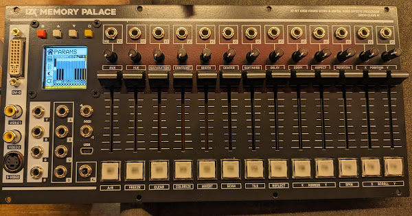

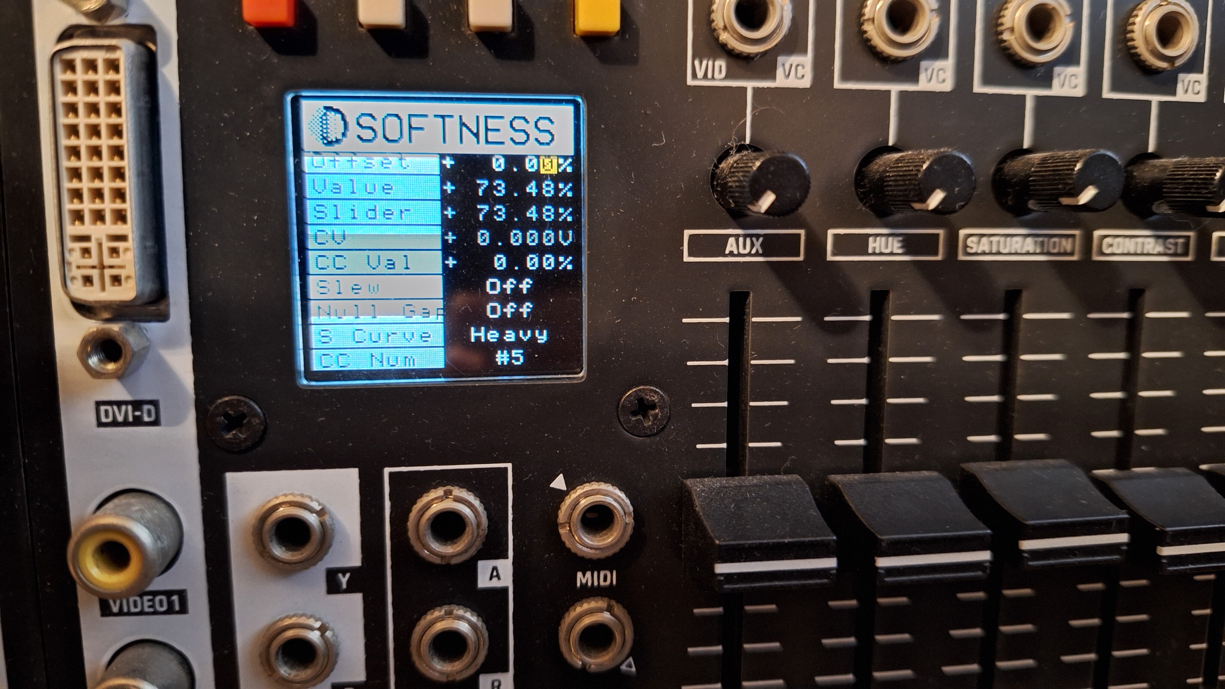

#3 — Entropist · 2023-08-03
My unit has that same slider behavior when loading default settings. It appears that the SOFTNESS slider has S Curve setting on Heavy that causes it to sit at 73.48%. Changing the S Curve to Off puts it at 50% (centered)
20230802_225737
20230802_223628
Regarding the my AUX slider, the bottom half of slider is a dead zone. Only the top half of slider changes the value. Not sure if this is intended behavior. Hitting the Yellow button on value screen causes the unit to hard lock too.
For what its worth, this is serial #35 Memory Palace purchased new from pre order has been used lightly and stored carefully over the years.
#4 — Z0NK0UT · 2023-08-03
These are definitely firmware issues. The AUX slider bug is on our list of issues to fix in the next firmware. Apologies for the issues–we’re excited to dig back into Memory Palace, leading up to its reintroduction.

yeha, thanks for all the replies. so seems the slider issue is fw based. the softness slider is from time to time completely locked, a “restore defaults” unlocks it again but with the implied misbehavior. @Entropist S-curve to Off fixes this indeed. The AUX value lock i can also confirm.
my main problem is still the unfindable sc card
SD cards i tried:
San Disk edge 8gb hc1
san disk ultra 16gb hc1 (10) A1
san disk extreme 32gb v30 hc1 (3)A1
Toshiba 64gb xc1
toshiba 8gb hc1 (4)
netac 8gb hc (6)
#8 — Z0NK0UT · 2023-08-08
In that case, it sounds like a broken SD card slot.
