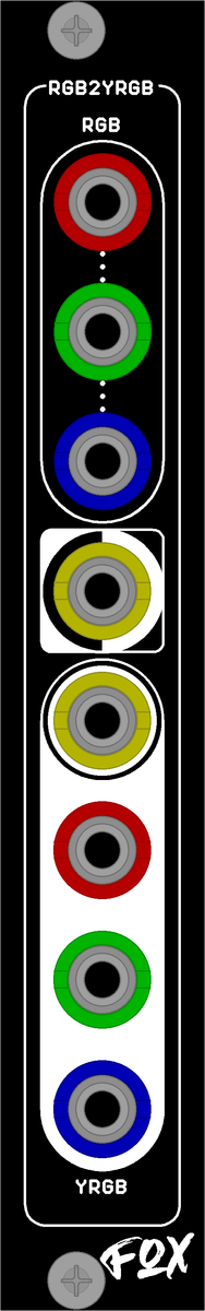

#5 — rempesm · 2023-09-19
https://foxinghour.com/products/luma-rgb-to-y-greyscale-converterLUMA converts an RGB image into the greyscale equivalent Y. Y is the specially weighted mix of R, G and B that accurately represents the luminance intensities of each color as they are perceived by the human eye according to the “International...
Price: USD 22.00
Link: LUMA - RGB to Y Greyscale Converter
Don’t you also have a module that precisely converts RGB to Luma?
