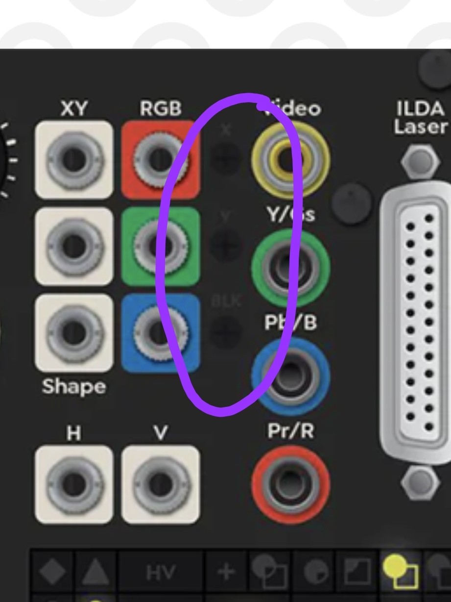

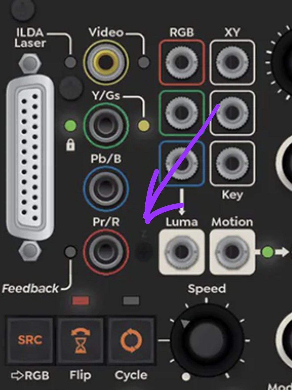

#5 — Rik_bS · 2023-09-28
Screenshot_20230928_163151_Chrome
Screenshot_20230928_163227_Chrome
I believe these are all trimpots that have been mentioned in distant discussions about features…
#6 — dryodryo · 2023-09-28
Thanks Rik. Those are invisible.
