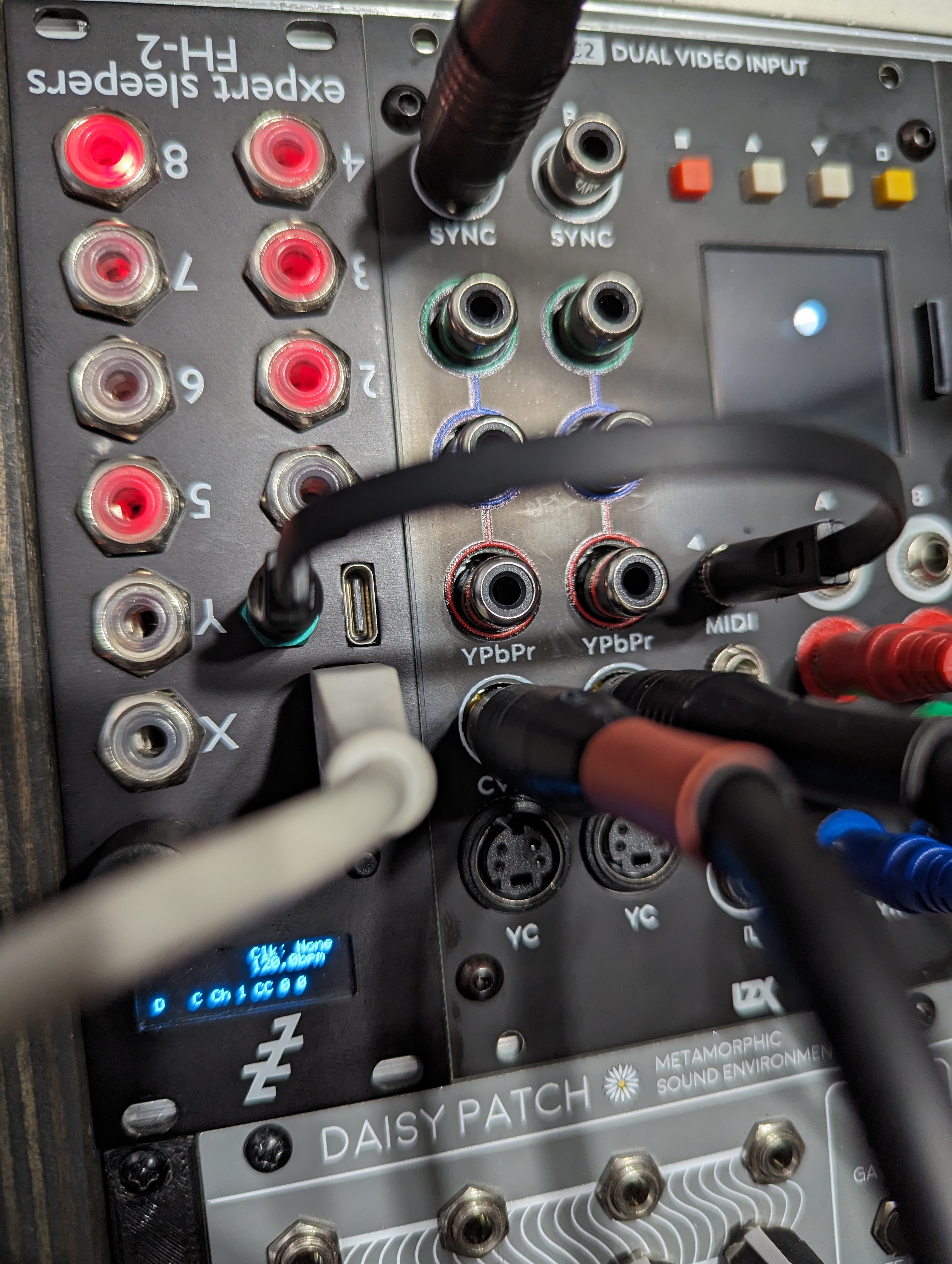

I use an Expert Sleepers FH-2 to connect USB MIDI controllers to my rig. The DIN-MIDI I/O is on the back on pin headers. I could just make another 2HP TRS breakout but, that row is now FULL. Is there a connection to the MIDI port somewhere on the back of TBC2? Just unboxed it and had a little poke around with my meter but, didn’t find anything.

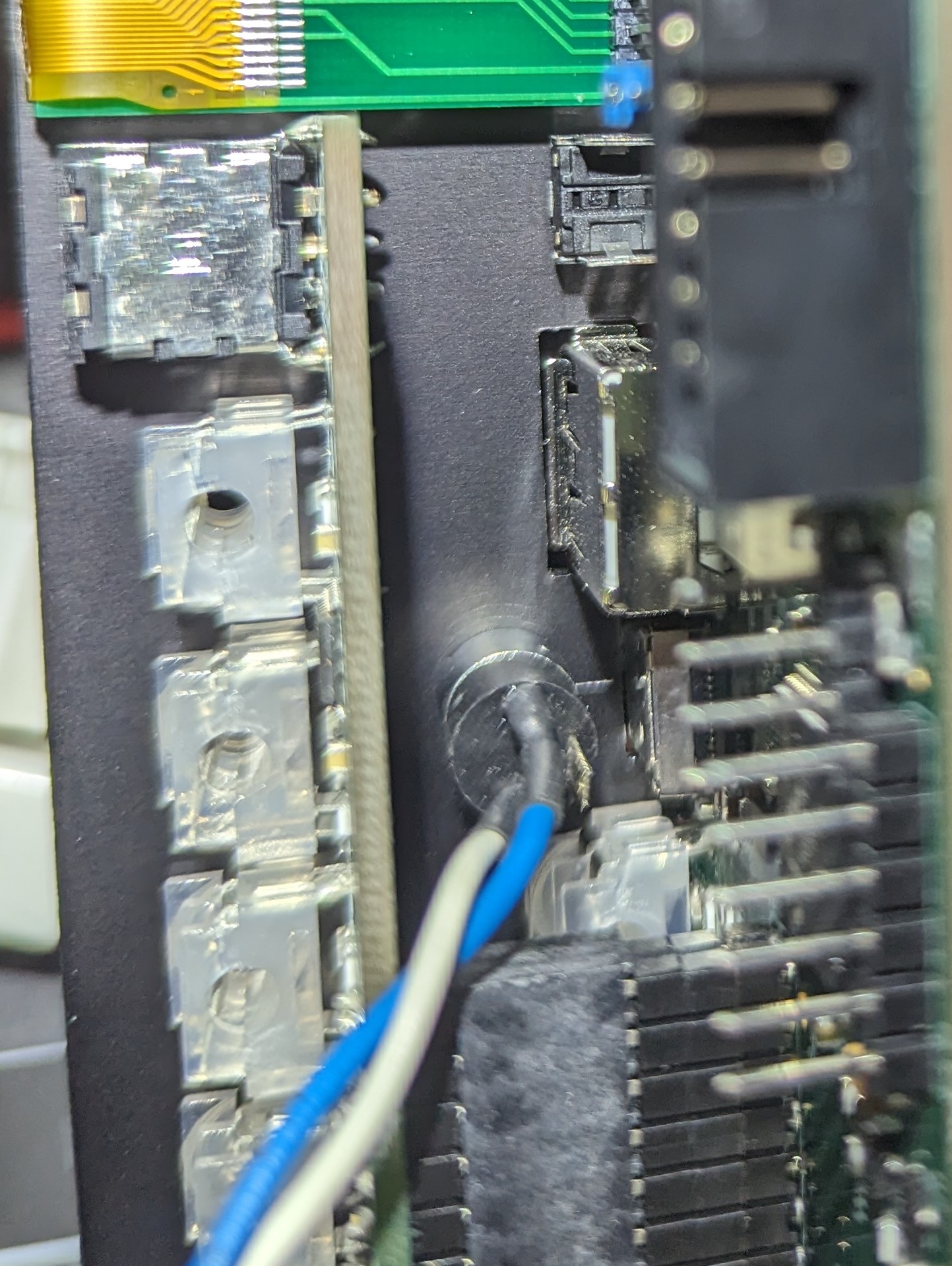

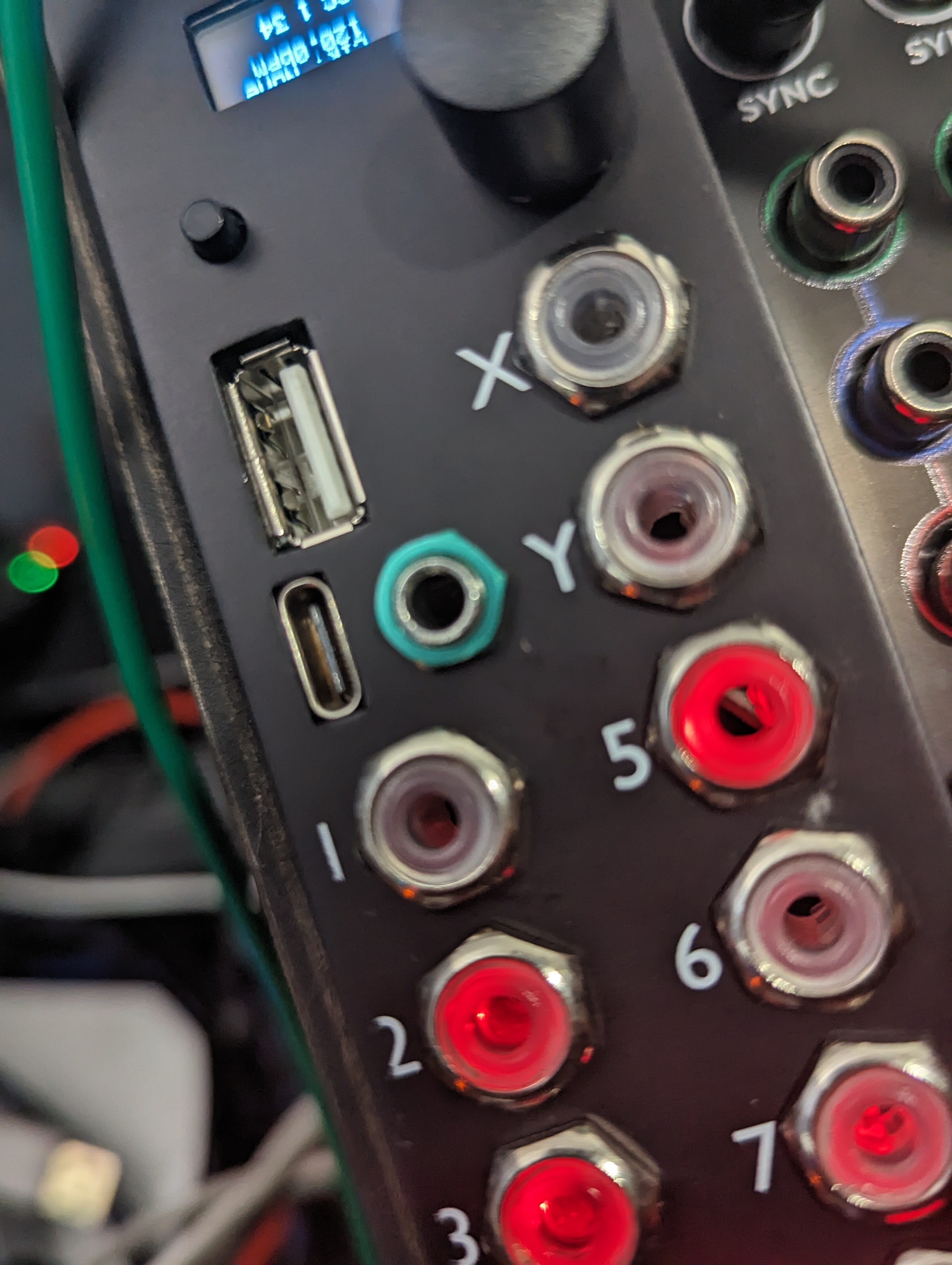

#3 — j4s0n · 2023-09-28
PXL_20230928_021411806
PXL_20230928_022458334~2
Plenty of room between the boards right there…
#4 — jwsmithwick1 · 2023-09-28
:clap:
That’s very impressive!
