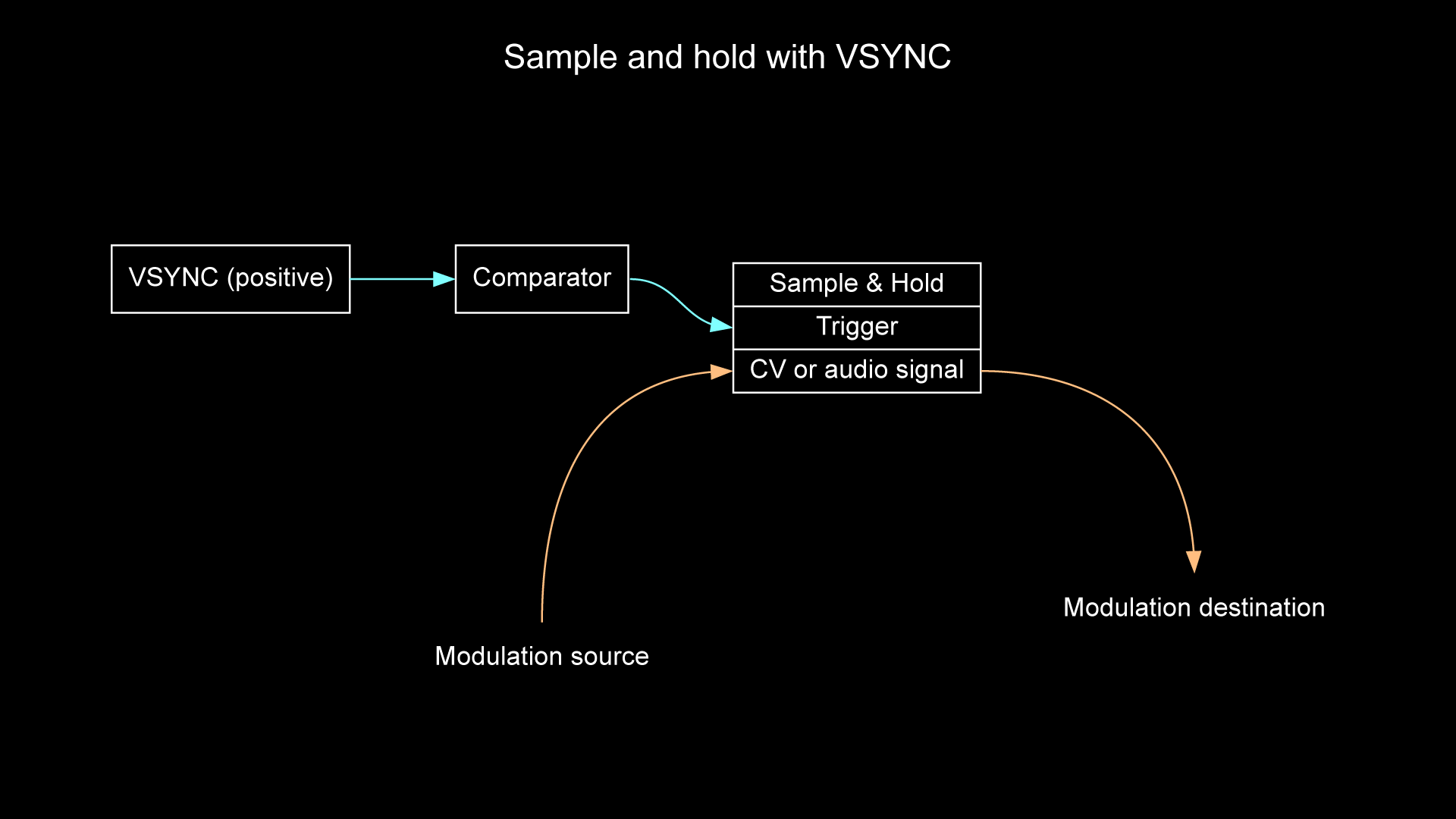

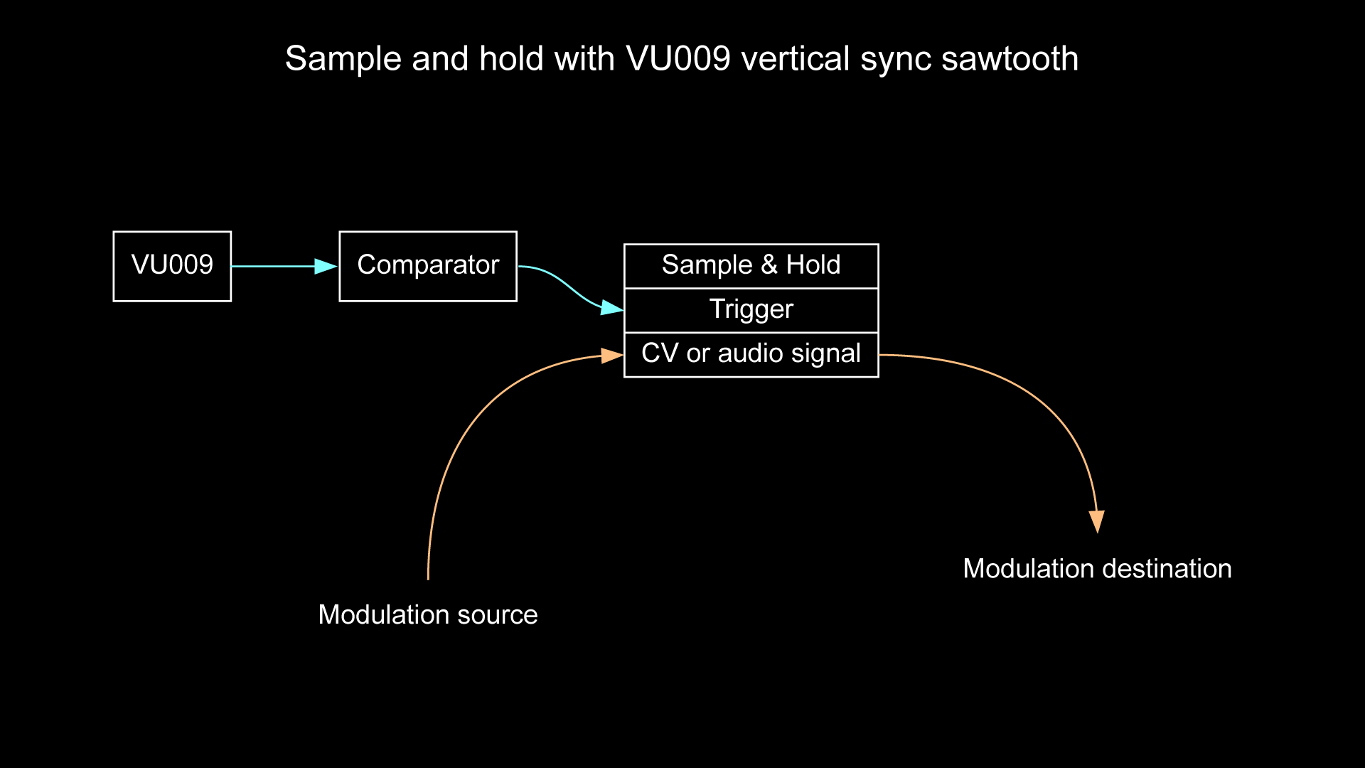

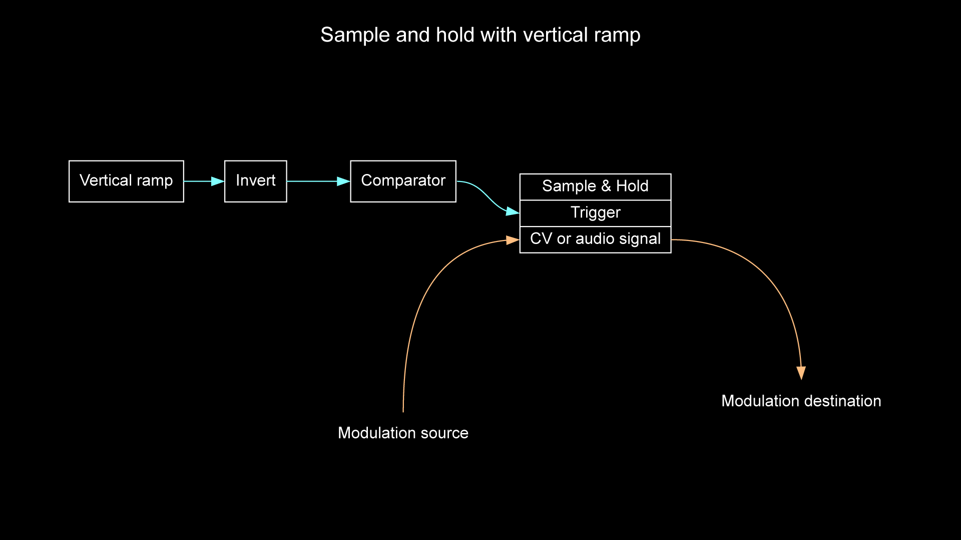

Video Synth Tools & Techniques: Sample & Hold to prevent frame tearing and shape distortion
Patch diagrams below
sample_hold_vsync_01
sample_hold_ramp_01
sample_hold_vu009_01
