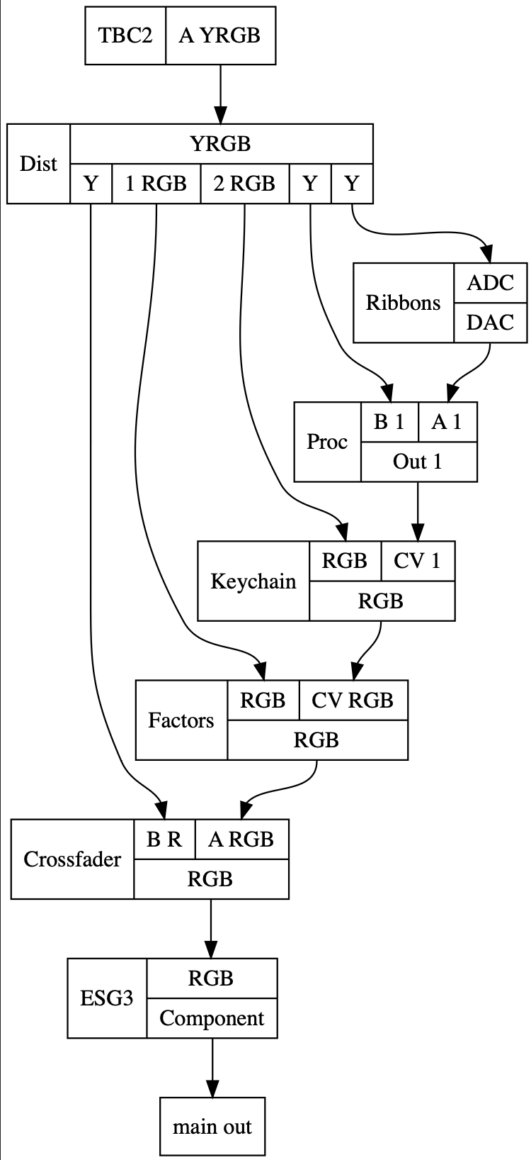

one of the colorization workflows I was patching out last week had keychain > factors at its core.
the main idea is multing an external input and getting 3 keys from its RGB output (from keychain in this case) then taking one of the clean mults into the inputs of factors and then the 3 keys into factors CV inputs.
In the patch I’ve also multed the Y out from TBC2 and it is going to several places. The first is a little sub modulation that mirrors the structure of the core. Multing a video output, processing it in some way then mixing between the original and the processed version. In the sub modulation I’m processing the Y out with ribbons to bring in more stepped color changes by mixing some of the original Y output to achieve the desired effect. This goes into the top CV input on keychain so that the same signal effects all the keys if desired.
At the end I’m mirroring the same kind of processed/original mixing setup to have a VHS crossfade fade between a multed original Y output and the main colorizer output from factors. This was you can bring in extra detail where you want it depending on how much of the Y is getting used in the ribbons>proc section as well as pulling all the color out to provide some nice darker hue zones to play around with.
I really enjoy making these patch visualizations. It is rewarding to make a patch you like enough to document in the first place but then once I’m to the cleanup stage of the viz the structure of the patch really starts revealing itself. I certainly wasn’t consciously thinking about mirroring the structure in several different variations one after another.
Screenshot_2023-12-17_at_1.50.36_PM
https://www.youtube.com/watch?v=VRRbvq_aOoI here is a short demo using a still image as external input
I’ll look around in my patchbook and see what other colorizer patches I’ve got

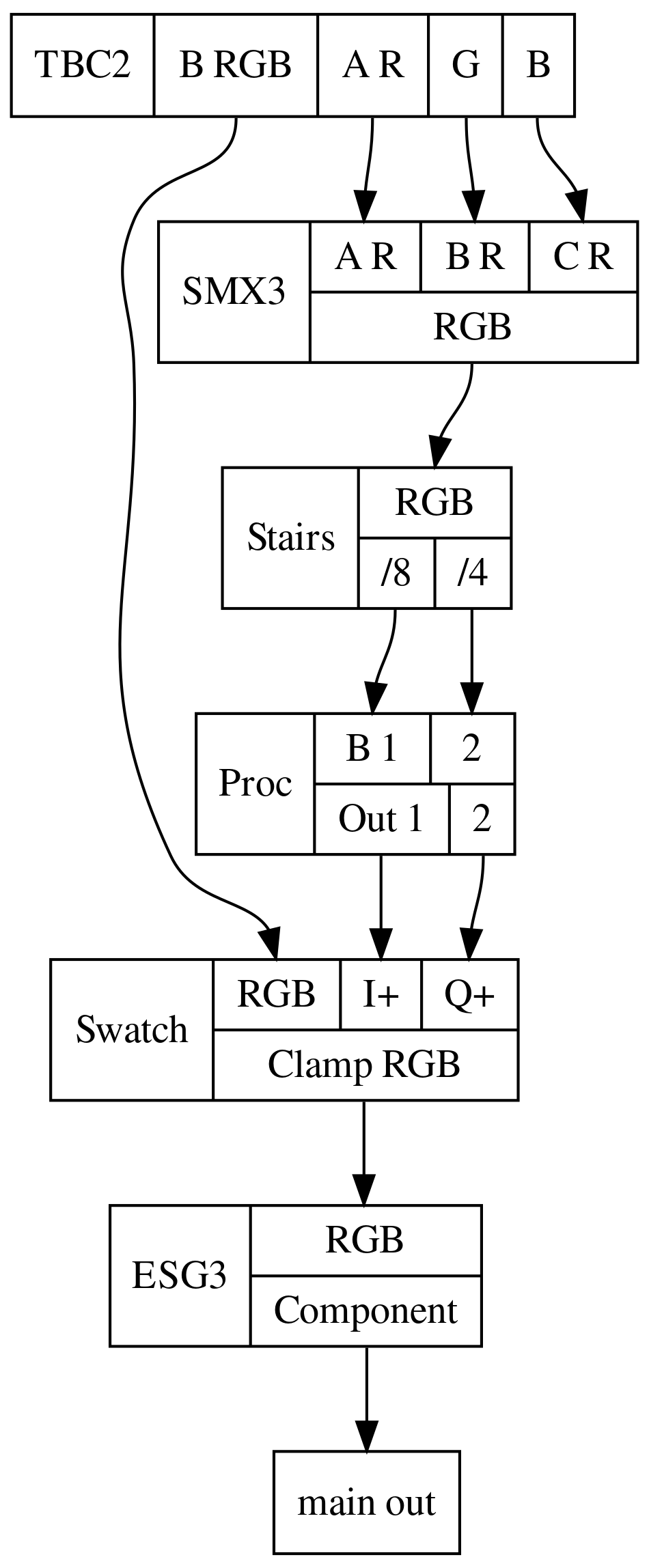

#19 — wednesdayayay · 2023-12-30
structs-6
another colorizer riff from our patchbook
I would most likely mult one TBC output to both SMX and swatch instead of setting it up like this. At the time I was doing this patch originally I set it up as a simple colorizer start and then started playing with fading (via TBC2 menu/midi) the second TBC input to other things while keeping some of the original.
