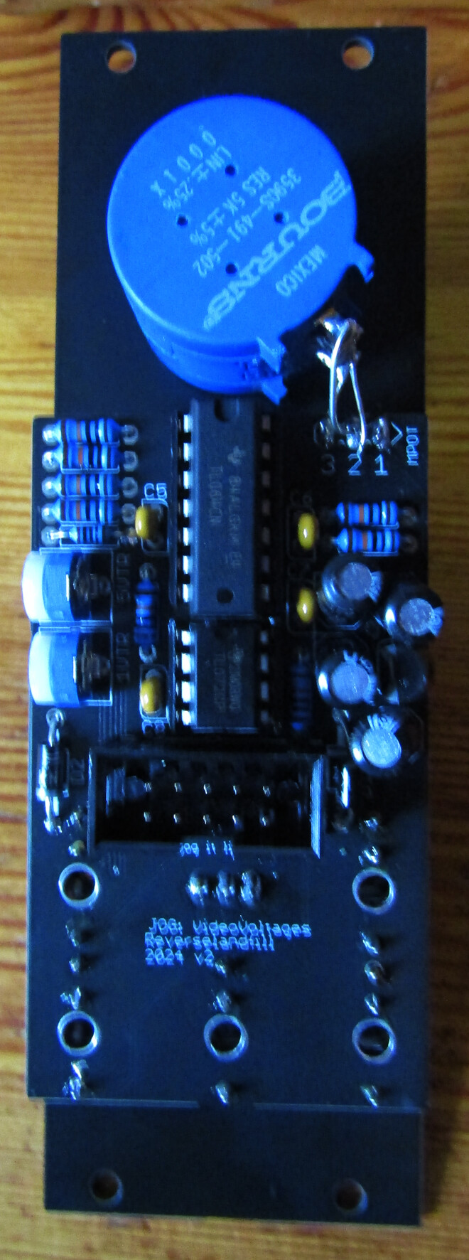

I’ve made a precision voltage source with a Bourns multiturn potmeter just for this.
The prototype is ready to be tested. I might have some time to do that today.
Jack output details:
trimpot 1 sets the 5v input to a 0v to 5v range (set to 1v for video purposes)
trimpot 2 sets the ‘trimpot 1 value output’ to a 0 to 1v range (set to 0.5v for example)
so then :
jack1 : -0.5v
jack2: +0.5v
jack3: -1v
jack4: +1v
jack5: variable voltage 0 to 1v or -1 to +1v (selectable with the switch)

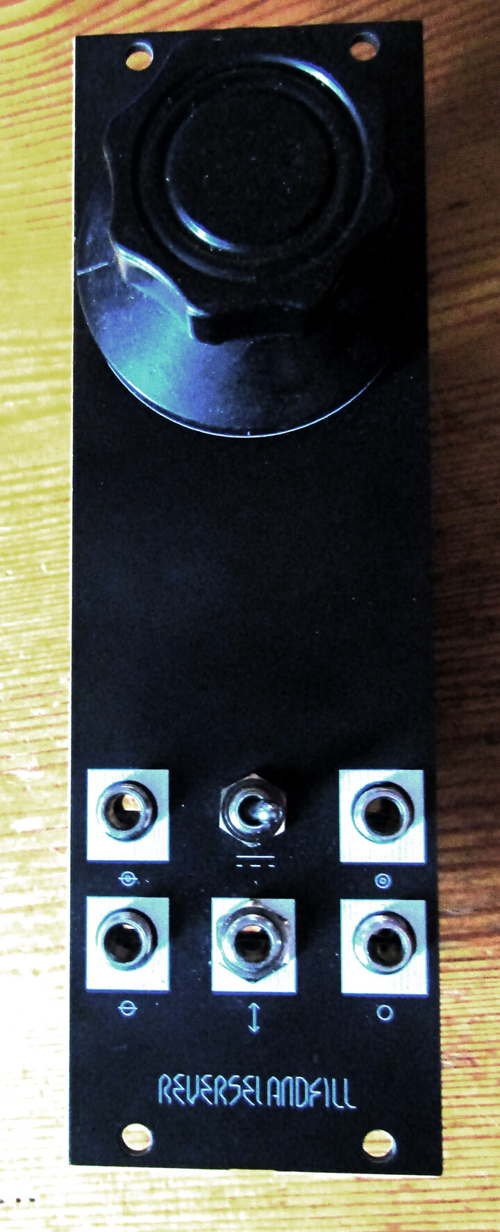

The prototype works and is ready for release.
Here is an example picture with a large vintage knob
:skull:
The module name is “JOG” Jog v1

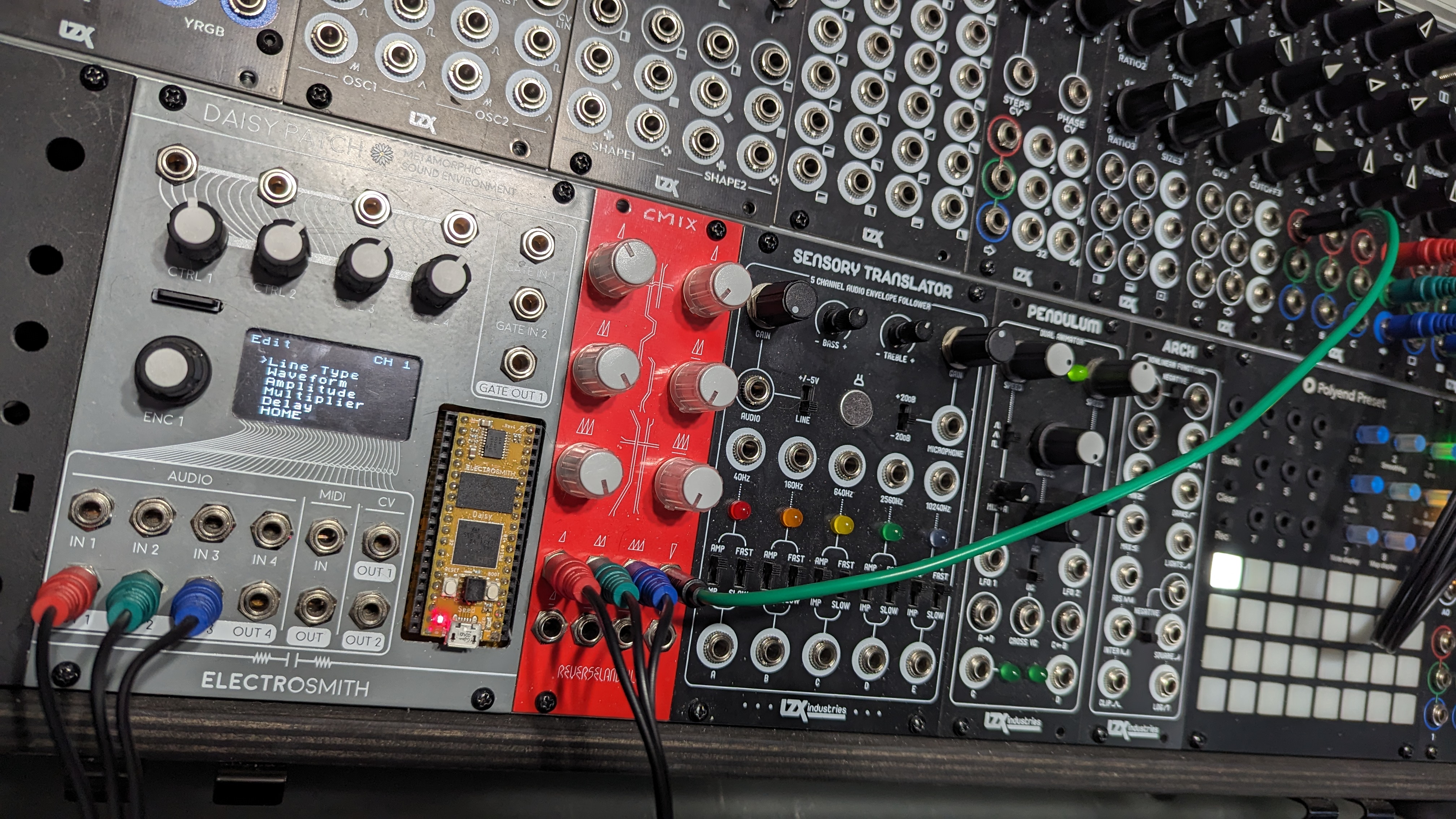

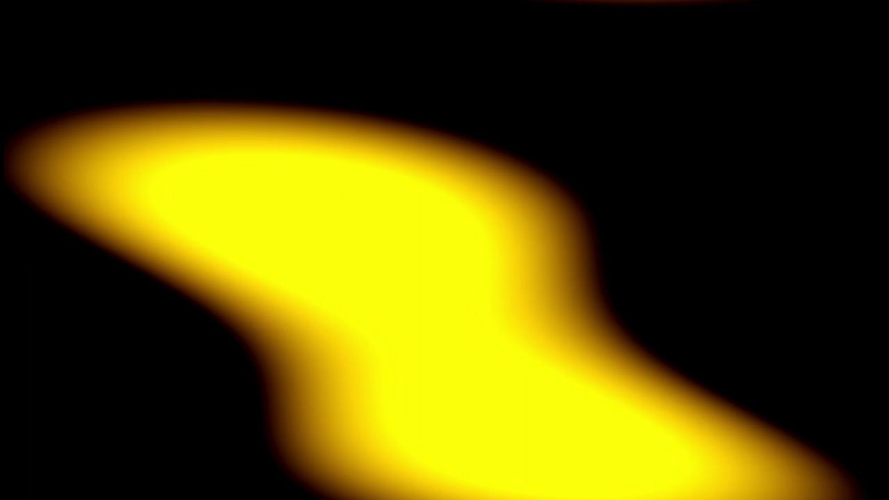

I use an Electrosmith Daisy Patch for exactly this. 4 free running oscillators with adjustable waveform, amplitude, multiplier, etc… It can even produce 1 clean cycle of a vertical or diagonal bar (in SD) before we’re above 20khz then it’s just a mess. Even that can be used as a nice chaotic/noise texture in the right patch though… Makes nice lava-lamp-ish blob shapes when mixed together…
PXL_20240225_230741628
https://www.youtube.com/watch?v=S5TRyq-VgPI
