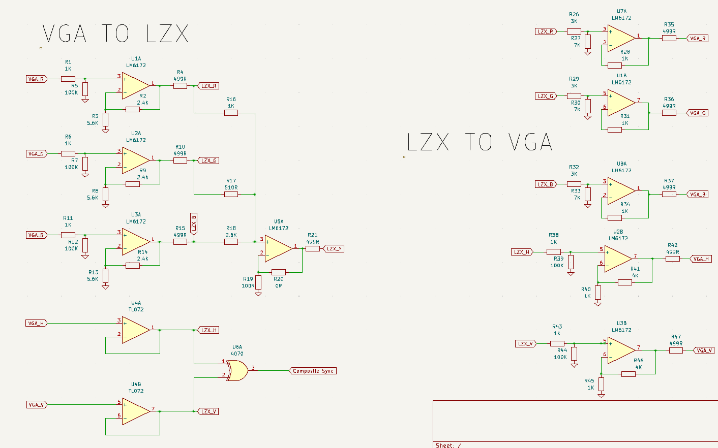

Thanks for the reply! I didn’t know that existed already. I guess I was hoping for a more DIY solution as I haven’t invested into LZX architecture quite yet. Here’s a preliminary schematic I put together - probably should be using LM6172s but I’m curious if a cheaper IC will satiate my intent
Cheaper ones will work, but you’ll loose some detail. Sharp edges won’t be as sharp.
The bigger problem will probably be timing. Most uses of LZX gear require sync at some point, so you’ll need your VGA device to output a VGA signal that uses a timing that will be accepted by whatever LZX modules you’re using that need sync. Some older modules might be more forgiving with timing, but if you’re using an encoder module or any of the Gen 3 stuff that needs sync (since they have sync generators that lock to the sync signal), you’re going to need the timing to be one of the supported timings. Not every VGA device will let you change the timing. Sometimes a resolution change will do it, but you might not be able to change it to a resolution that has timing that will be accepted for composite/component video. You’ll also want DC restoration, but you’ll still get picture without that, just the levels will probably be off. Here’s a modwiggler thread where Lars mentions some this stuff a bit: VGA in and out of LZX? (aka VGA in video synthesis?) - MOD WIGGLER
There are some pretty cool LZX modules that don’t require sync at all so they would be relatively easy to interface with, like any of their 8hp Gen 3 modules. Some that need sync, like the Gen 3 VCO, the DWO3, might work without (rear) sync if you plug sync into the front panel reset jacks, but I’m not sure about that.
If you do end up using a module that needs sync, you’ll need to combine the H and V sync signals, which I think should be as easy as a 50/50 mix between the two. But I’m not sure if VGA sync differs from composite/component sync (besides timing as mentioned above). It originally drove CRTs also so it’s probably close, but I’m not sure if it’s close enough.

LZX H and V sync are 5V (at least in the cadet series) and buffering them from the VGA device is a good idea but I think you can do away with the TL072 as you have a 4070 with unused gates. Tie 1 input of an XOR gate to ground and whatever you feed into the other input will be buffered at the output and will be 5V.
I believe H and V sync can be XOR’ed to get C sync, but I think you will need to do something to drop the output voltage down. If you just take the 4070 output it’s going to be 5V and it needs to be 700mv to truly be composite sync. TTL level sync has the potential to damage downstream equipment. Also don’t forget to tie the inputs of any unused gates in the 4070 to ground.
As you have seen I plan to update the cadet range. I had a plan to do a VGA in and out module that works with the updated modules. The plan was that the VGA out module would have the same blanking circuit from the cadet RGB encoder, but this requires the blanking signal from the cadet sync generator or possibly modifying a Syntonie VU007 (which has the signal generated by an FPGA) to get the blanking signal into the VGA out module. I haven’t yet found how to get the blanking signal without an MCU or FPGA interpreting the output of a sync separator IC and generating a blanking signal.

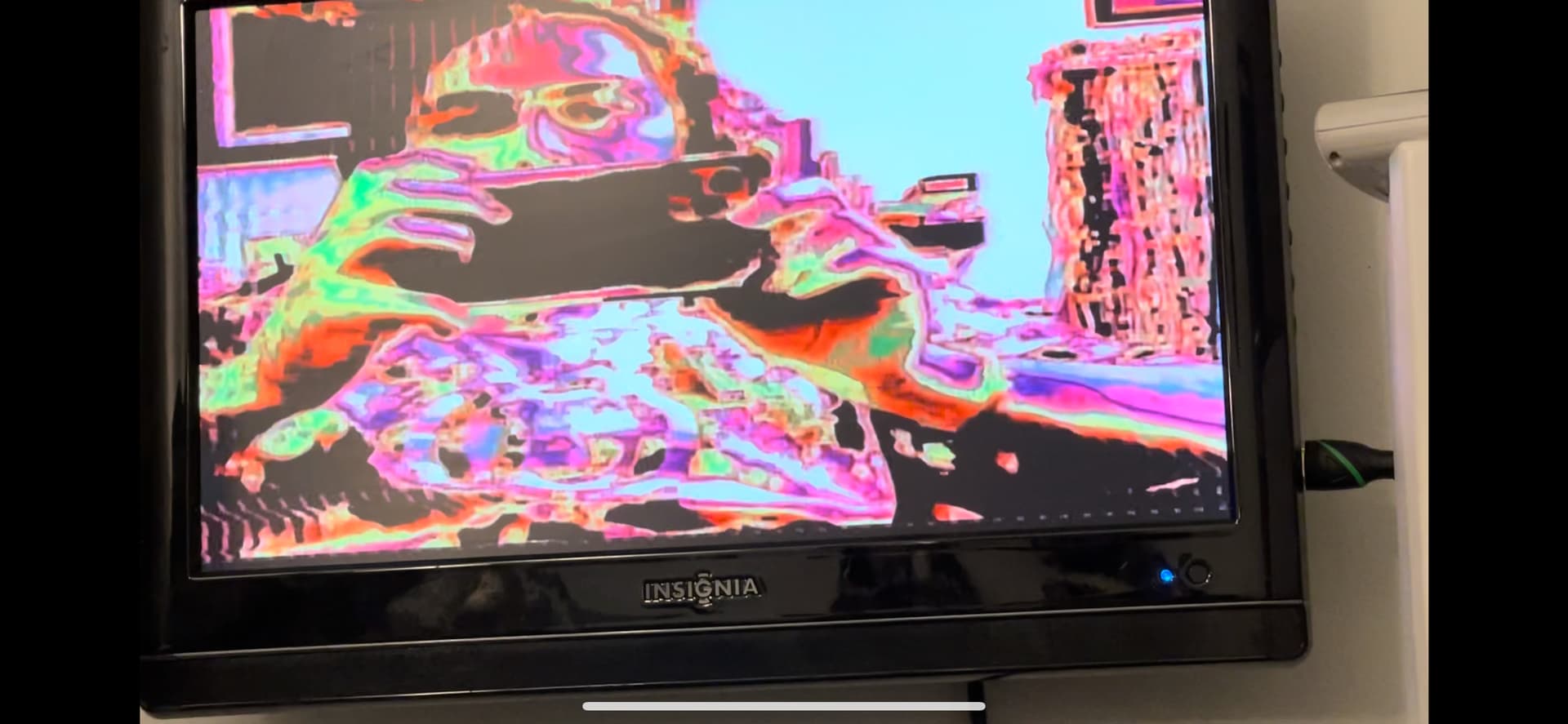

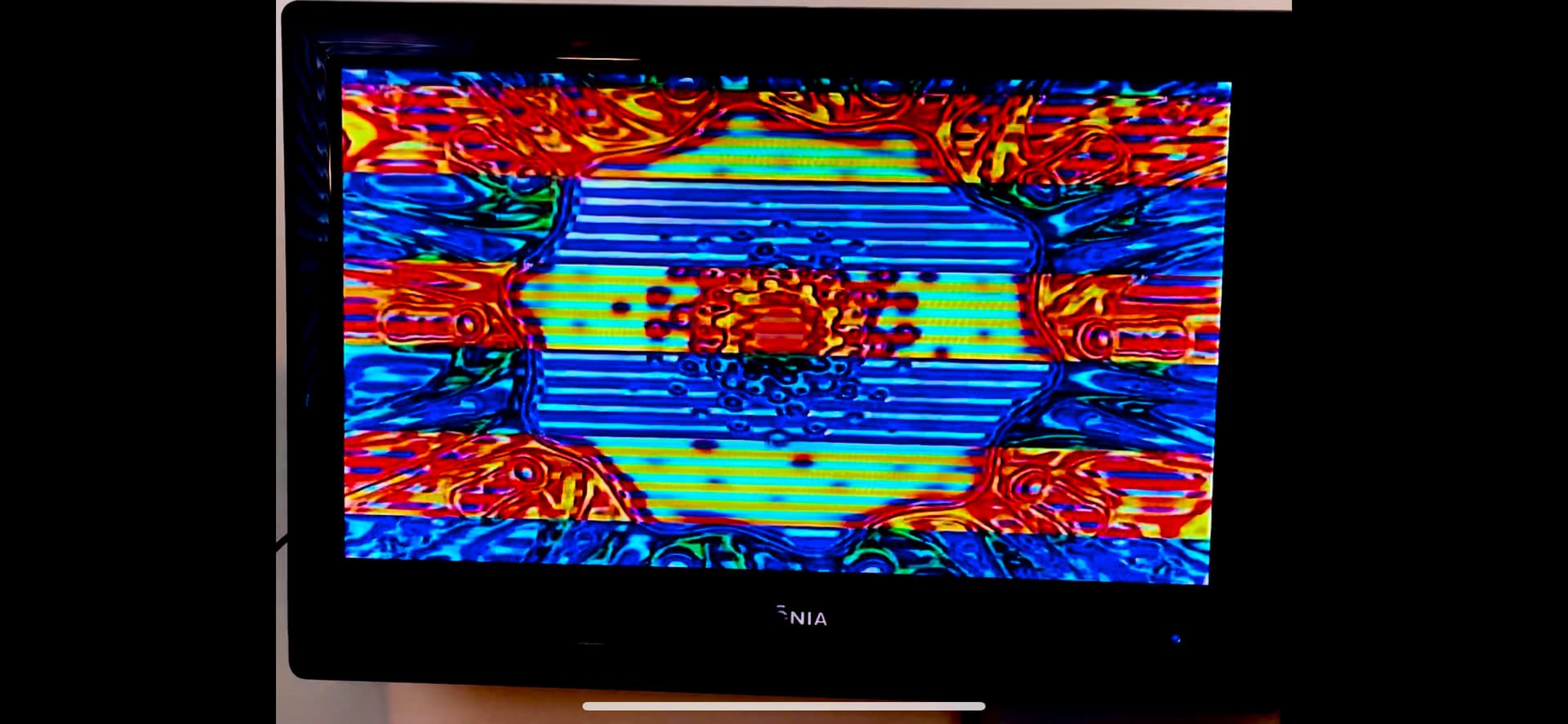

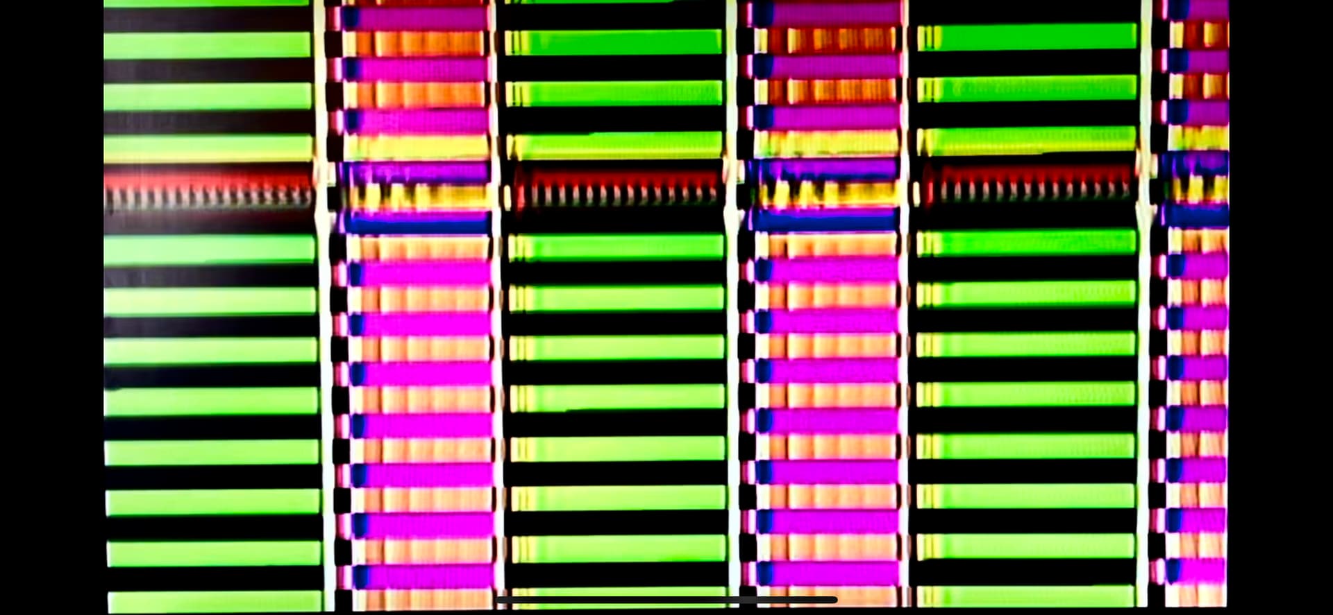

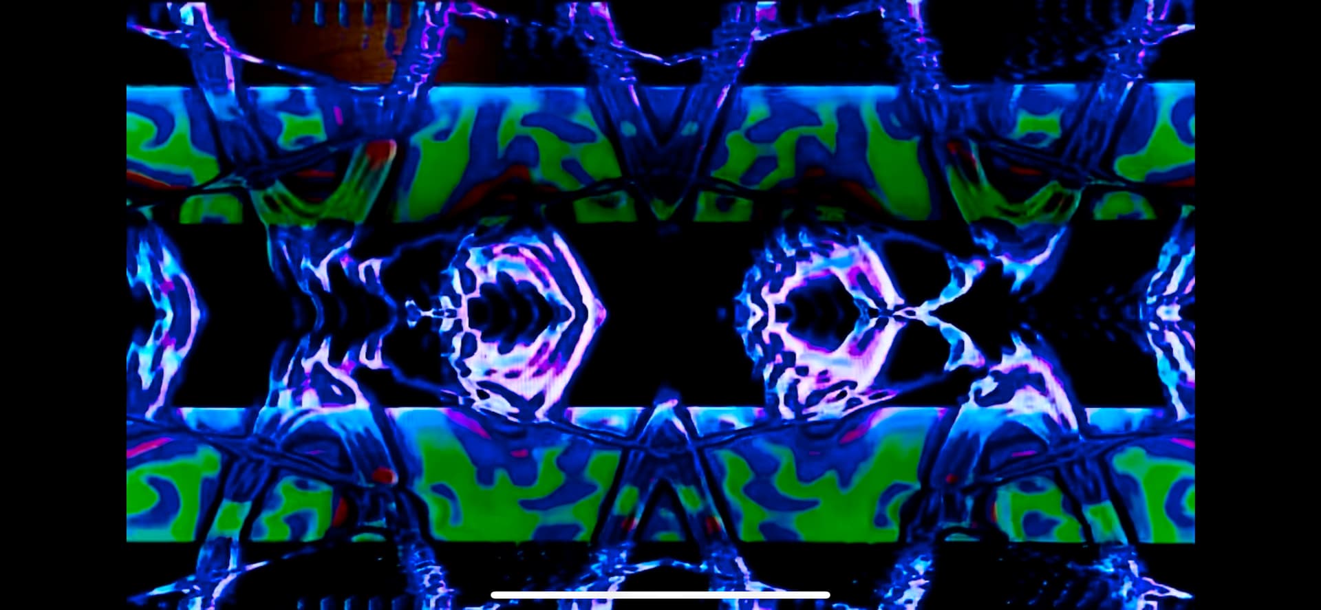

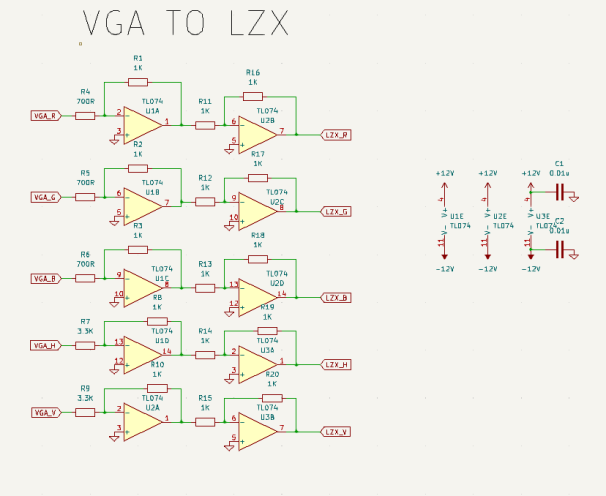

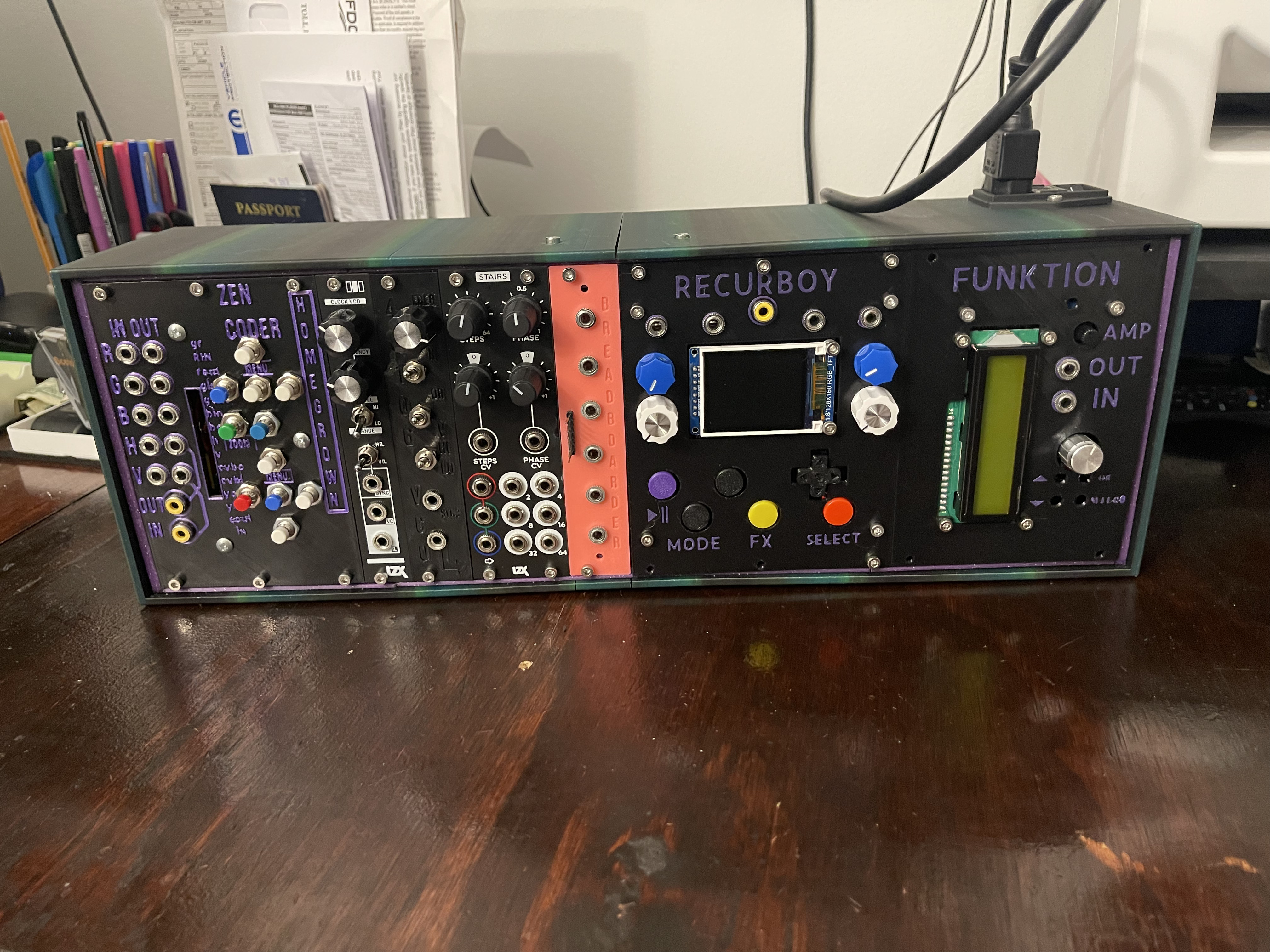

Hey y’all,
thought I’d post an update on my endeavors:
I was able to use VGA2AV converter and AV2VGA converter to make a hacky RGB encoder and decoder. The H and V sync are generated by the AV2VGA converter and hardwired to the VGA2AV converter. RGB is taken from LZX standard and scaled to VGA standard using AD8034s (thank you Bastien aka Syntonie, Phil aka pebble and analogmonster for all of your help there). Hacky blanking is achieved using H sync and a CD4053 IC (thank you Tim aka cyberboy666 for help with that.
On the decode side, composite video can be supplied to the AV2VGA converter. The VGA standard RGB is then scaled to LZX standard using AD8034s. In my current prototype, green doesn’t seem to work but otherwise I have had some nice success.
These converters also have S-video, so naturally I tried to convert this to component standard but unfortunately I ran into issue there. I was using Syntonie’s VU007 LZX to component conversion circuit but I could not even get a black and white output connecting luma from the Svideo output to the display (and I did test the svideo output and that worked fine). I suppose maybe it’s a resolution limitation?
Anyways, I may just forgo trying to implement component for now so I can start designing an actual module - my intent is for this to be a cheapier hackier option in modular anyways.
IMG_6836.HEIC
