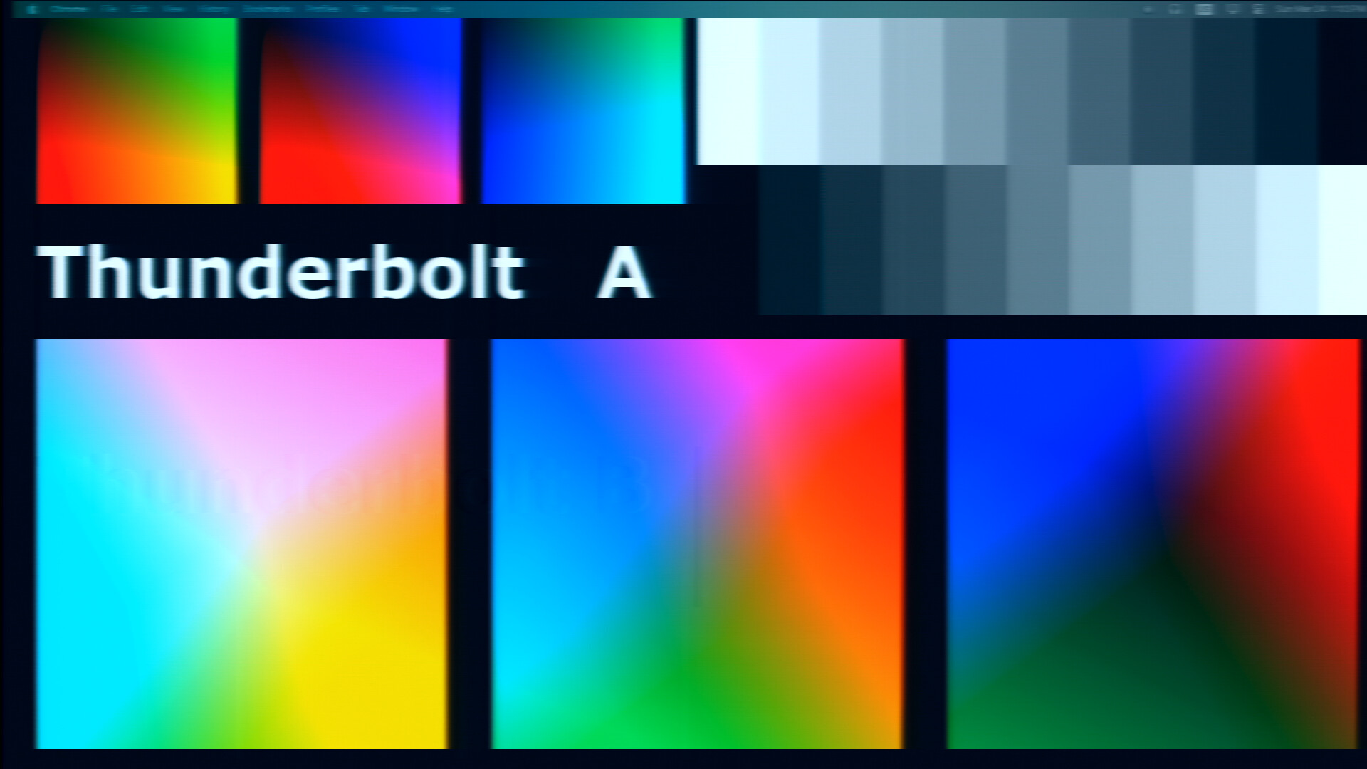

Here are screen captures. The bottom row of three large squares are a YIQ displays.
Normalled
Normal

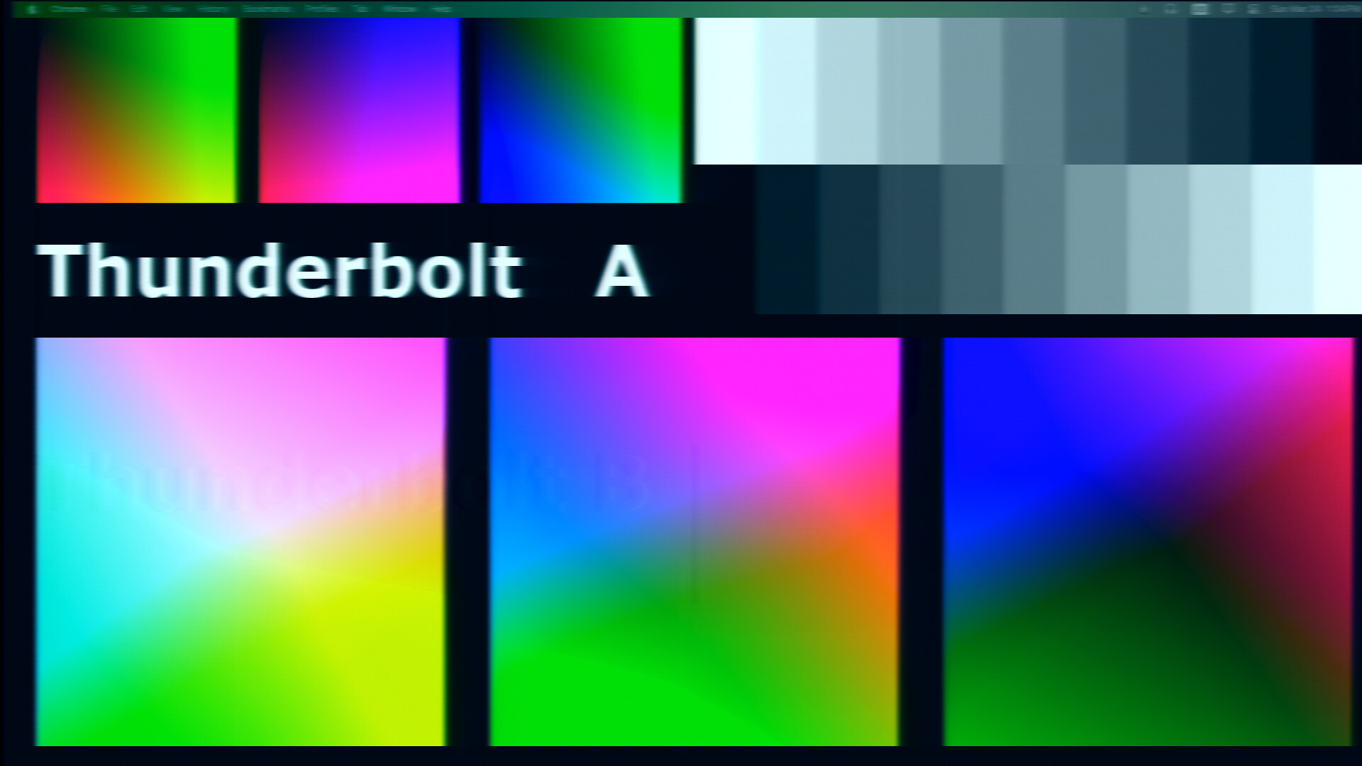

I Minus - much more Red
I minus

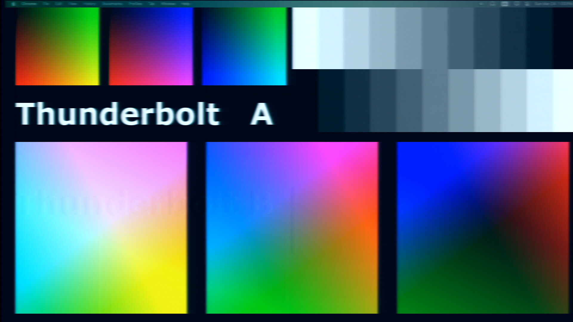

Q Minus - much more Green
Q minus

This took a while for me to understand, too.
The I and Q positive and negative inputs are additive. In other words, the I inputs are summed, and the Q inputs are summed. But the negative inputs are inverted before the summing.
Whatever you patch into a negative input is inverted and added to the existing signal. That existing signal is whatever is present at the positive input, either patched or internally normalled from the positive output.
Regarding the I and Q negative outputs… they are already inverted.
When you patch negative out to negative in, you are inverting the signal twice and adding it to the existing signal. Therefore you are doubling the signal. Do this with both I and Q, and you double the saturation.
