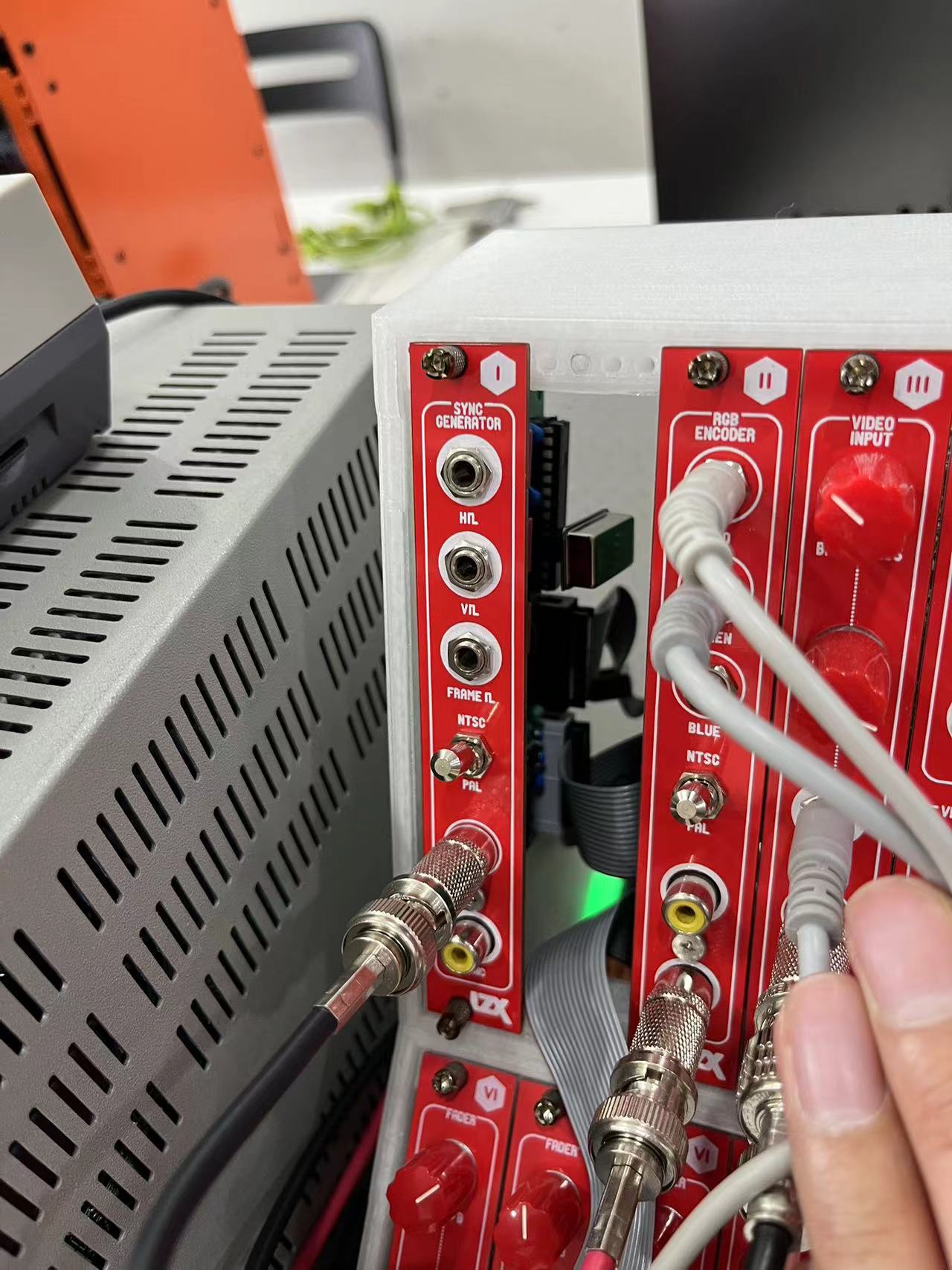

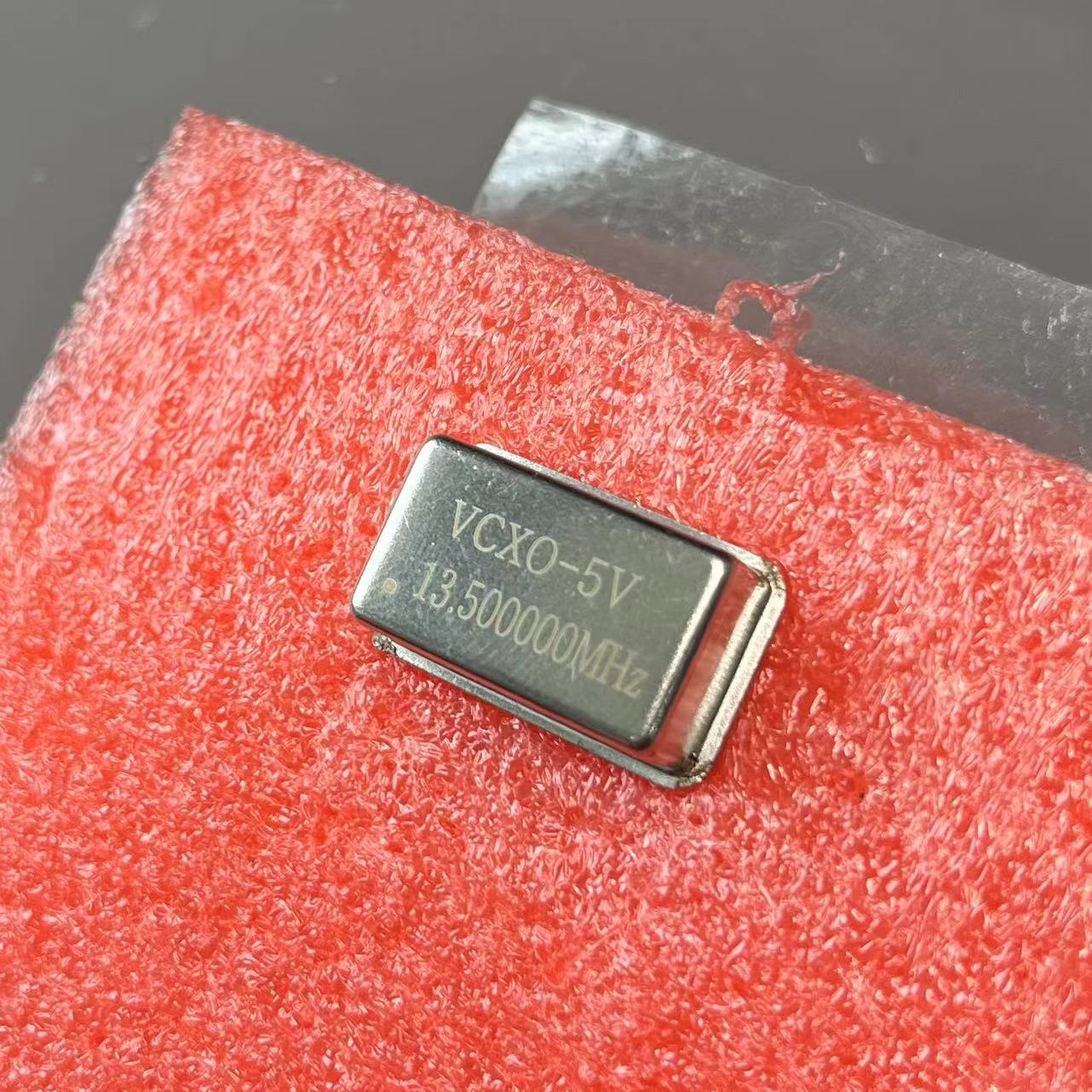

Greetings from China! The 13.5mhz VCXO is finally found. I bought customized VCXO from Taobao (a Chinese version of Amazon), and it worked! Besides of different size, it syncs perfectly and I’m glad to say that the cadet is back to life again (don’t know if you guys have found other solutions xd)
Video, size, and Taobao link are included in the topic, love from China.
P.S. Video from Kelvin Wang thx for the testing works
P.P.S. Why can’t i upload videos ahhhhhhhhhh
mmexport1715653712300
mmexport1715652654032

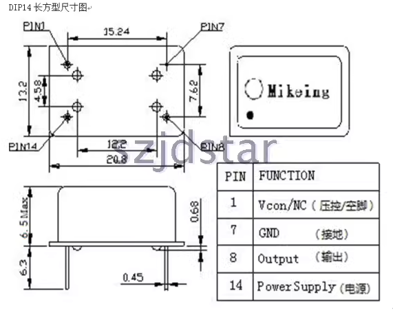

Here is the link. I’m not sure if it will work outside of China though.
The VXCO is quite large.

thanks for sharing this! i am currently building a C1 and i have this VCXO – but i realise now that the replacement has 4 pins while the original (and the PCB) has 6. could you enlighten me on how to frankenstein it to the PCB, meaning, which contact goes where? sadly comparing the pinouts i couldn’t figure it out
EDIT i just looked at the PCB gerber and realized that the middle contacts in each row are not connected to anything. so if we go by the little dot in the bottom corner of original VCXO and the replacement, would that be the correct placement? thank you!
