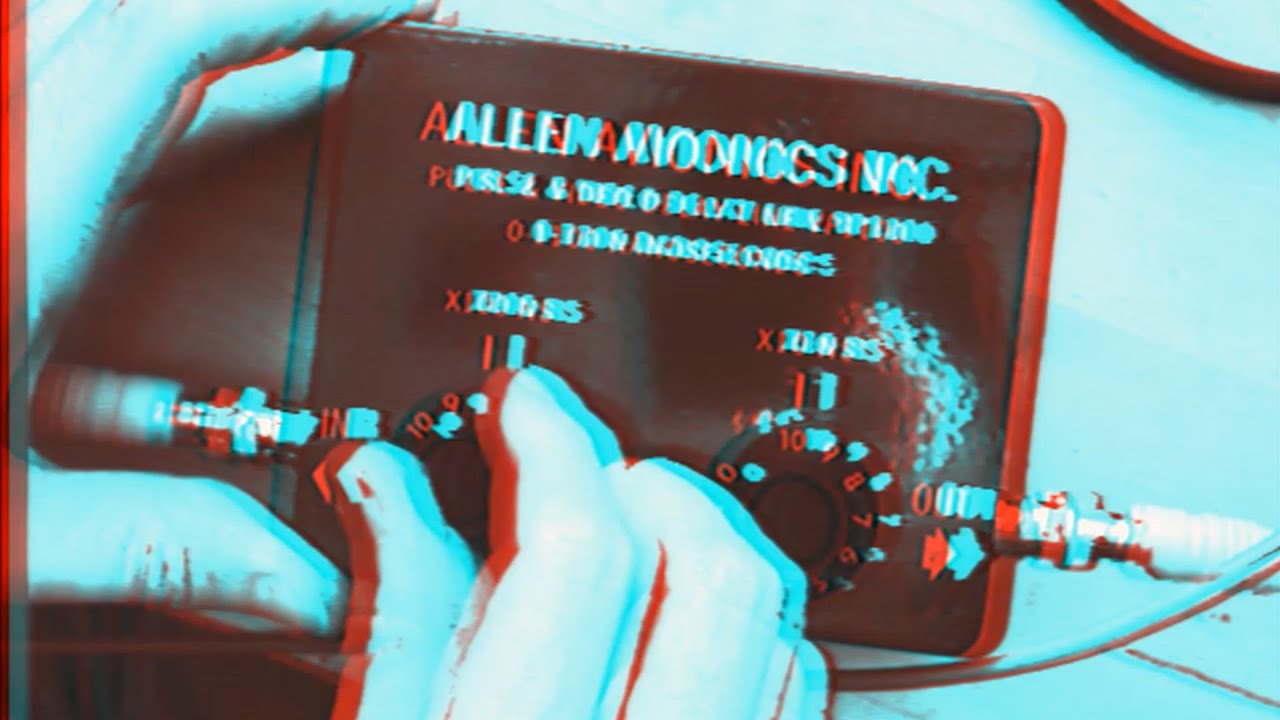

You can do some basic color channel shifting by putting a delay line in the signal path. Here’s a test I did:
https://www.youtube.com/watch?v=jJEwCk4P1TwThat was just a test with splitting a b&w signal. But you could theoretically run one channel of a component signal into the delay before decoding for this effect on a full-color image.
But those delay line boxes can be a bit pricey once they get up to meaningful delay times (I happened to find one on Ebay at a halfway reasonable price). Definitely cheaper than 3 MemPals though! Albeit far less control.
For precision, this is honestly an effect far easier to achieve in software… I prefer to leverage the native abilities of LZX stuff, splitting off one channel into a Castle Flip Flop or something and then using that blocky image as the “offset” color channel. Two effects for the price of one!
