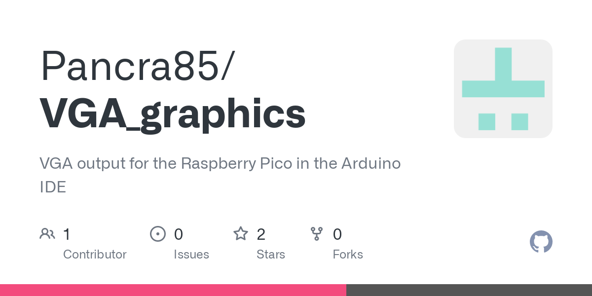

I uploaded my basic code to github:
GitHub
https://github.com/Pancra85/VGA_graphicsVGA output for the Raspberry Pico in the Arduino IDE - Pancra85/VGA_graphics
Link: GitHub - Pancra85/VGA_graphics: VGA output for the Raspberry Pico in the...
I’m working with the interface now and more details.
My take works with two 360x240 bitmap (one for current frame and another for next frame) and 3 colors which has lower specs than what I’ve seen around in other rp2040 vga output examples.
Also I am overclocking it to 250MHz, but at the same time if you draw too much on the screen it stalls quite a bit.
I think the problem lies that it erases the screen every frame and redraws it again, even if it stays still without changes.
Maybe that could be solved by using a sprite system instead of a screen bitmap but I am not that experienced with graphics
Any thoughts let me know
