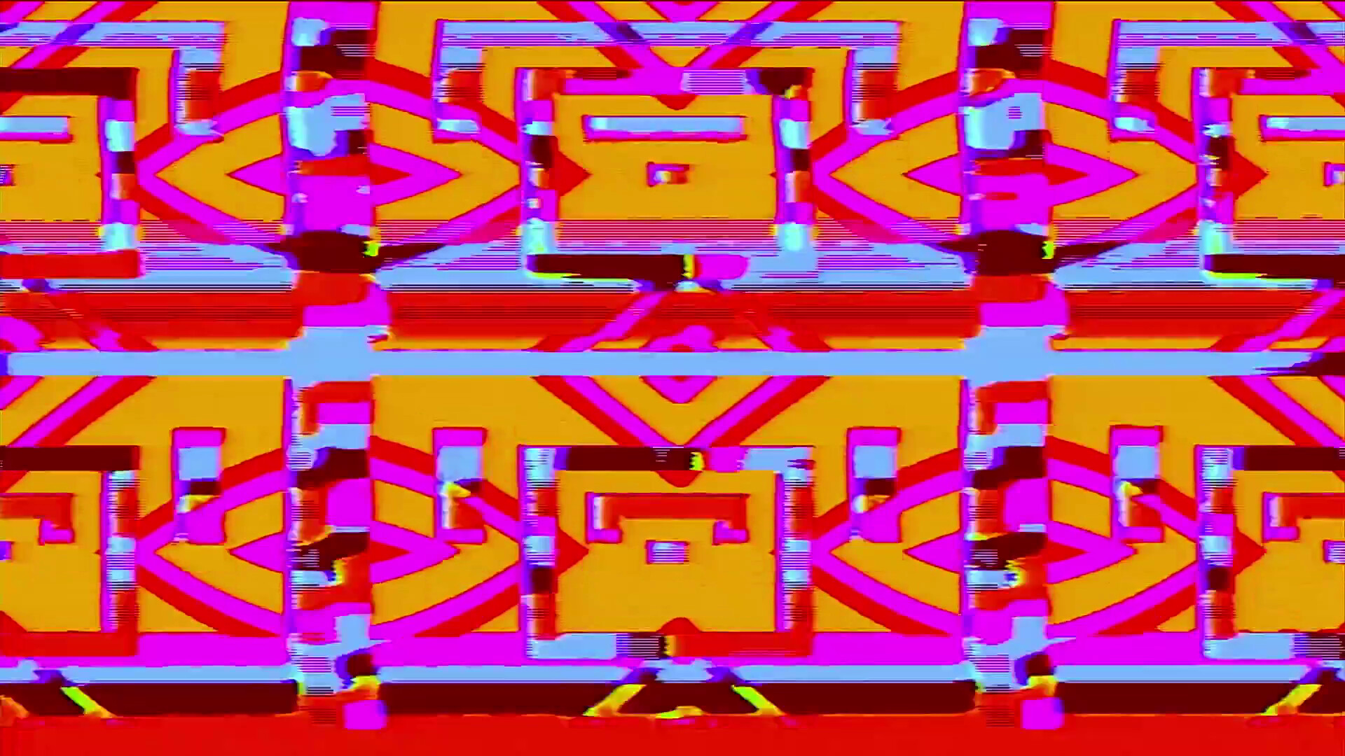

Thanks, this worked a treat!
vlcsnap-2024-06-15-15h38m42s355

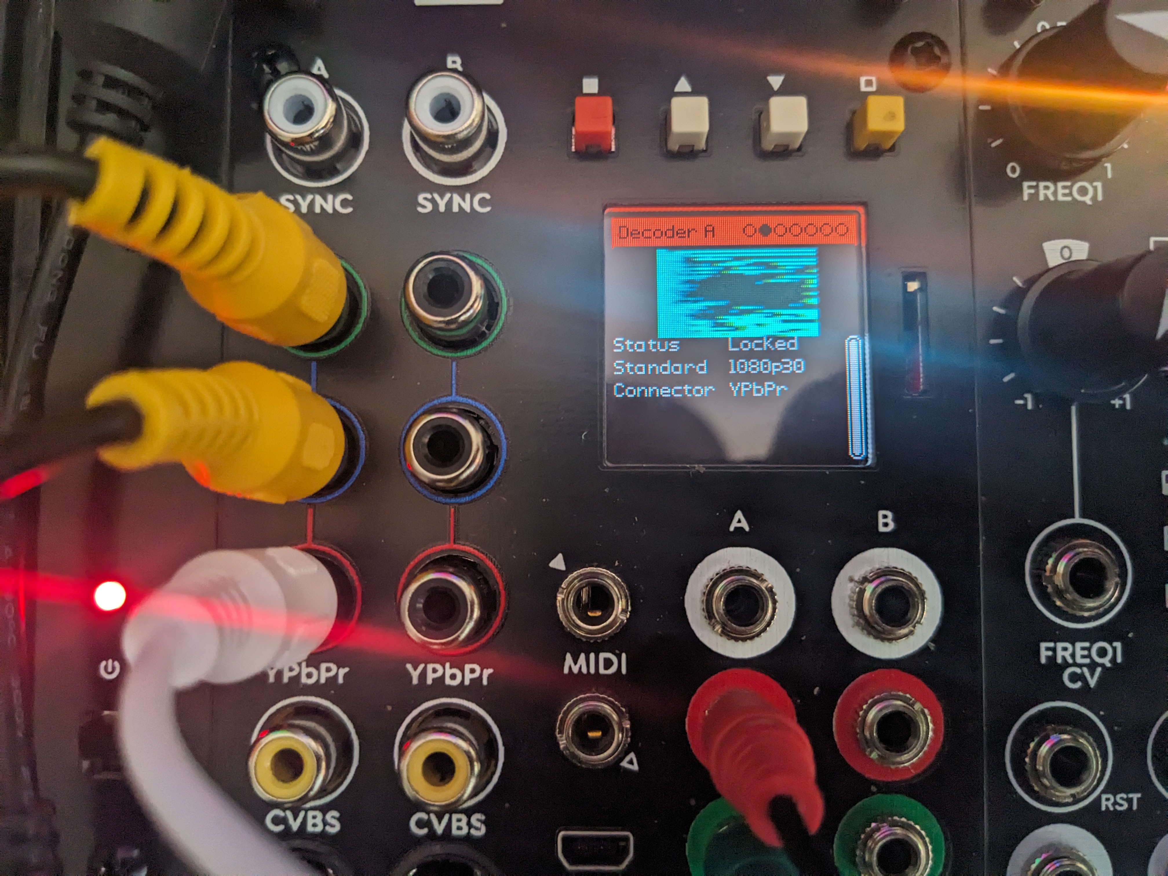

PXL_20240616_121221045
Thanks for this anyway, time to buy another module (my wallet won’t be happy!).
#7 — hellocatfood · 2024-06-18
j4s0n wrote:
You need something like this to do it properly… > VU001C - Triple Video Distribution Amplifier – Syntonie
The module arrived today and it works great and now I have nice hd video feedback
