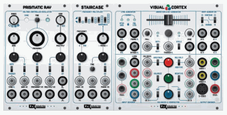

Starter System 1
“This system assumes you have no other EuroRack modular gear or oscillator sources. The inclusion of an oscillator like Prismatic Ray really brings shapes and video to life. Staircase is the fastest way to create patterns and visual complexity. The ability to patch a ramp output from Visual Cortex into Staircase and use Prismatic Ray as a primary modulation source makes this a complex, fun and low cost way to step into LZX.” – Sam Newell
Prismatic Ray
Staircase
Visual Cortex
Total HP Width, 52HP
+12V Power Consumption, 370mA (0.37 A)-12V Power Consumption, 390mA (0.39 A)Starter System 2

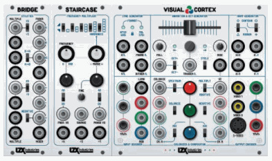

“The most minimal configuration I could recommend, this system assumes you are expanding an existing EuroRack modular synthesizer which includes oscillators and other modulation sources. Bridge provides a scaling interface between your video and audio modules. Bridge also allows you to fade and mix ramps from Visual Cortex, which can then be processed by Staircase. With the Visual Cortex Colorizer & Compositor you can create many interesting patches from a very small system.” – Sam Newell
Bridge
Staircase
Visual CortexTotal HP Width, 44HP
+12V Power Consumption, 280mA (0.28 A)-12V Power Consumption, 330mA (0.33 A)

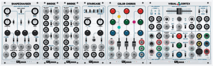

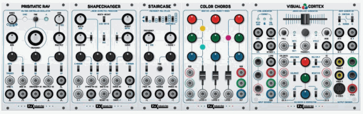

Basic System 1
“Building off of the Starter System 1, this layout introduces Shapechanger and Color Chords. The addition of Shapechanger instantly takes you out of solely making patterns and into the ability to generate complex and stunning shapes which can be mixed with patterns using Color Chords. Color Chords lets you dive deeper into the amazing analog color mixing capabilities that the LZX system provides, and gives you multiple layers to play with. This is important because of the vast amounts of possibilities within the Shapechanger + Staircase combination. Patching RGB out respectively into A or B on the Visual Cortex Compositor allows you to fine tune and filter through colors producing stunning combinations.” – Sam Newell
Prismatic Ray
Shapechanger
Staircase
Color Chords
Visual CortexTotal HP Width, 84HP
+12V Power Consumption, 630mA (0.63 A)-12V Power Consumption, 650mA (0.65 A)
Basic System 2
As Basic System 1, but building off of Starter System 2.
Shapechanger
Bridge (x2)
Staircase
Color Chords
+12V Power Consumption, 570mA (0.57 A)-12V Power Consumption, 610mA (0.61 A)

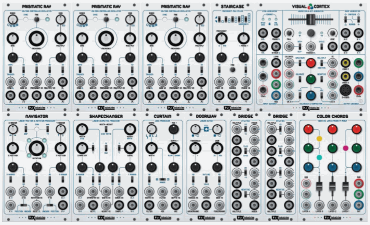

6U System
Prismatic Ray (x3)
Staircase
Visual Cortex
Navigator
Shapechanger
Curtain
Doorway
Bridge (x2)
Color ChordsTotal HP Width, 168HP
+12V Power Consumption, 1210mA (1.21 A)-12V Power Consumption, 1140mA (1.14 A)

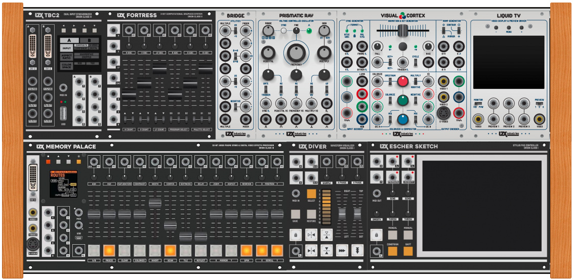

#11 — Zifor · 2019-09-13
Would it be possible there would be example setups with memory palace as well now? I am planning my rig around it and it would be fantastic to have a starting ground!
#12 — Z0NK0UT · 2019-09-13
You have an exciting journey ahead. You can add just about anything to Memory Palace and get exciting results. Here is a powerful complete system with Memory Palace. You can add any of these modules as the next step after Memory Palace.
#13 — Zifor · 2019-09-13
thank you!
What would be the reason i would need TBC2 with the memory palace? Does it not do a similar job with inputs? (I am a novice so sorry if this is a silly question!)
#14 — csboling · 2019-09-13
Memory Palace only has LZX patchable video inputs, you cannot connect an external video source to MP directly. You would have to use Visual Cortex, TBC2, Cadet III or Vidiot to decode it first – each of these has different capabilities. In addition to supporting several input formats, TBC2 will let you bring two different sources into the system and share sync between them and other video synth modules – currently you need some out-of-rack time base corrector for this.
#15 — Zifor · 2019-09-16
Starting to understand how clever this setup would be for a beginner like me. Thank you very much!

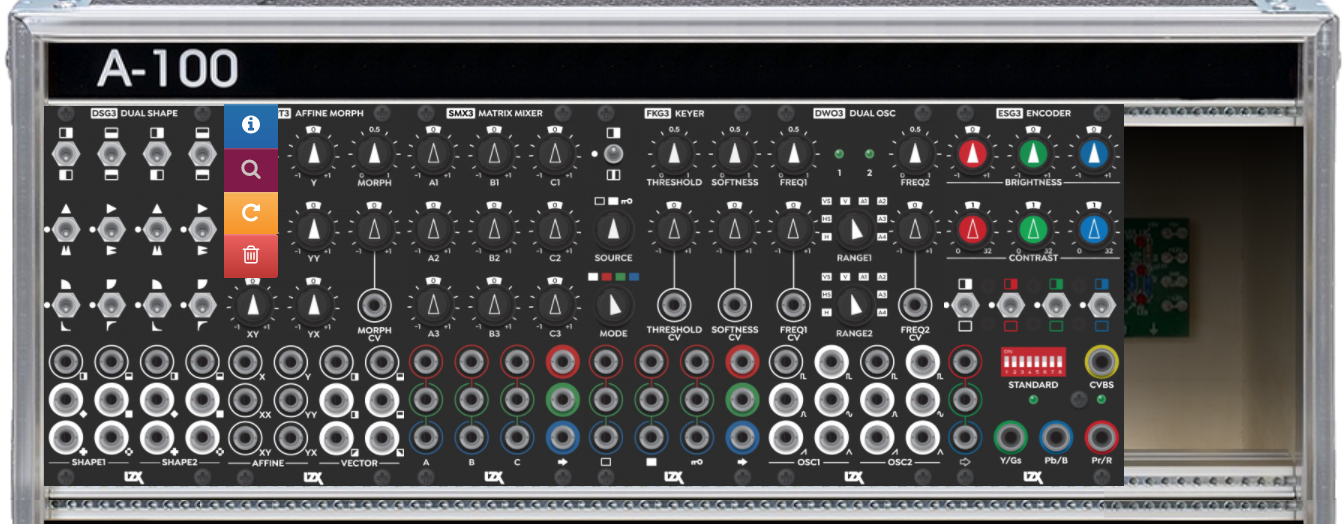

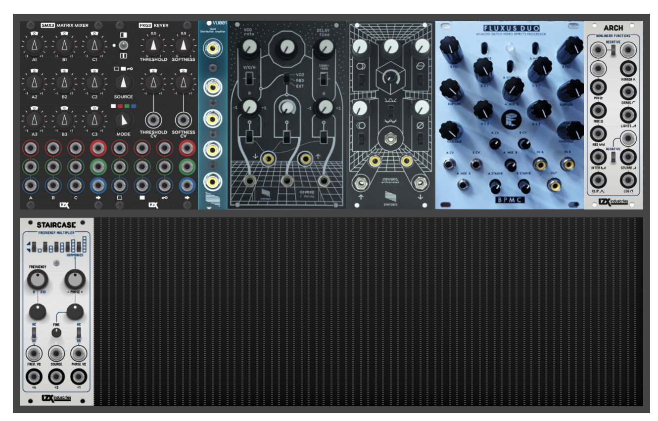

#17 — thenoiseoftime · 2022-01-31
Hey guys
So I’m planning to enter LZX world - well actually there is no going back now anymore cause I have ordered a bunch of modules already. I also had the honor of playing on my studiomates rack and got these results. It is more and less the aesthetic I would like to start to explore to start with. Until now I just used to jamm a bit with glichmodules and mix them with old videomixers and so on. I have a Audio Eurorack System, so LFOs and stuff is no problem and I even have modules I can directly set up for 1 v output.
This is from a session I was able to make on my buddys rack and it is certainly the direction I want to go. first try
So now that we have GEN 3 modules coming I was wondering how sync is going to work? I’m planing on getting at some point a Chromagnon since I won’t need HDMI a Visual Cortex would be fine as well. But if I want to start with what I have - my current rack looks like that in a few days:
I was wondering how the compatibility works with what I have:
I tryied to research all this options but I feel like I don’t have all the possibilitys understood especially because of the 14 pins sync models that now as far as I understood is not requiered anymore?
So could I make now Videosynthesis with my rack if I use a Ramp Generator (I have acces to a 3 Trins RGB at the moment as well - I could use it’s ramps rights?) and a Cadet I Sync Generator? Or do I need now the ESG3? Since I’m in Europe I have understood that Bastien is also working on a solution the vu007 and I would like to support him but I will definetly expand my rack anyway with some of his vu modules.
I hope this is the right place to post this, cause I thought that we could update this now together with the current LZX GEN 3 modules and maybe mention also compatibilitys with older Generations?
Thanks everyone for this amazing knowledge in this forum I feel very excited to enter this project.
#18 — Z0NK0UT · 2022-01-31
Chromagnon would be the most effective addition, as you’d get a sync source and animated pattern generation. If you just need sync and ramps, you could go with Cadet I & IV, but the Cadet sync gen is hard to find. ESG3 is another good solution; add DSG3 and ART3 to get some of the moving patterns shown in your linked video.
#19 — thenoiseoftime · 2022-01-31
Thanks!
So in theory this could be a beginner building setup right now with the upcoming modules right?
#20 — Z0NK0UT · 2022-01-31
Beginner or seasoned expert setup, yes!
Add TBC2 if you want to process external video & still images or make video feedback.
#21 — thenoiseoftime · 2022-02-01
I might be able to get some cadet modules for a while to test my system. But do I need a reverse and fill busboard?
#22 — Z0NK0UT · 2022-02-01
Cadet modules use the normal Eurorack power bus. No need to acquire anything special for power. You will need to sync Cadet I, II & IV together using a 14-pin sync cable.
