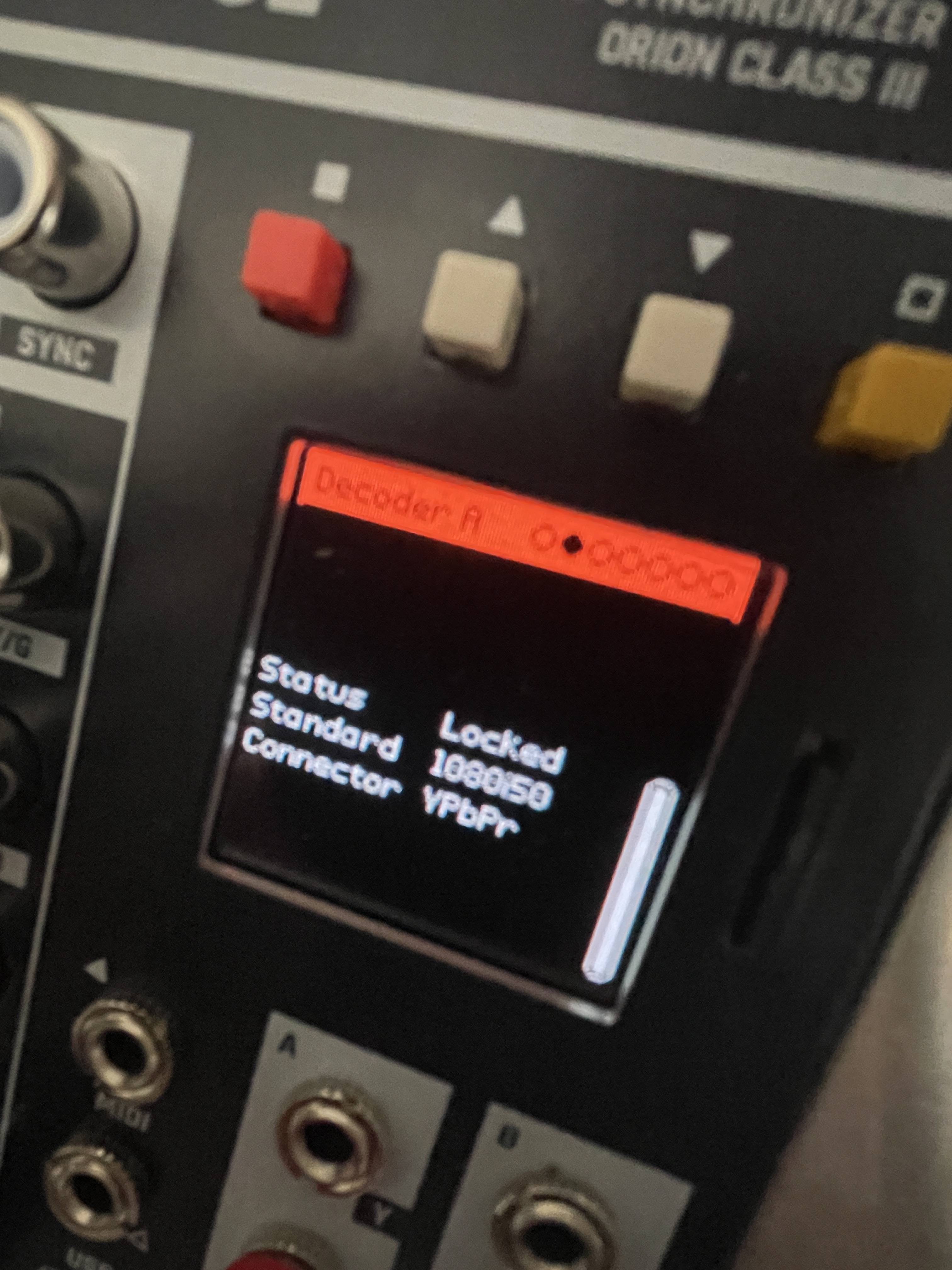

My TBC2 reads ‘Status: Locked’ whenever I have any HD video signal (i’m working in 1080i50) connected. The other settings on the inbuilt display show:
Standard: 1080i50
Connector: YPbPr
(Both correct)
It won’t show any signal on the display and no signal is shown through to the ESG3 either.
Any ideas why this is?
It was working momentarily, then the output froze (on my external monitor) and then this status appeared

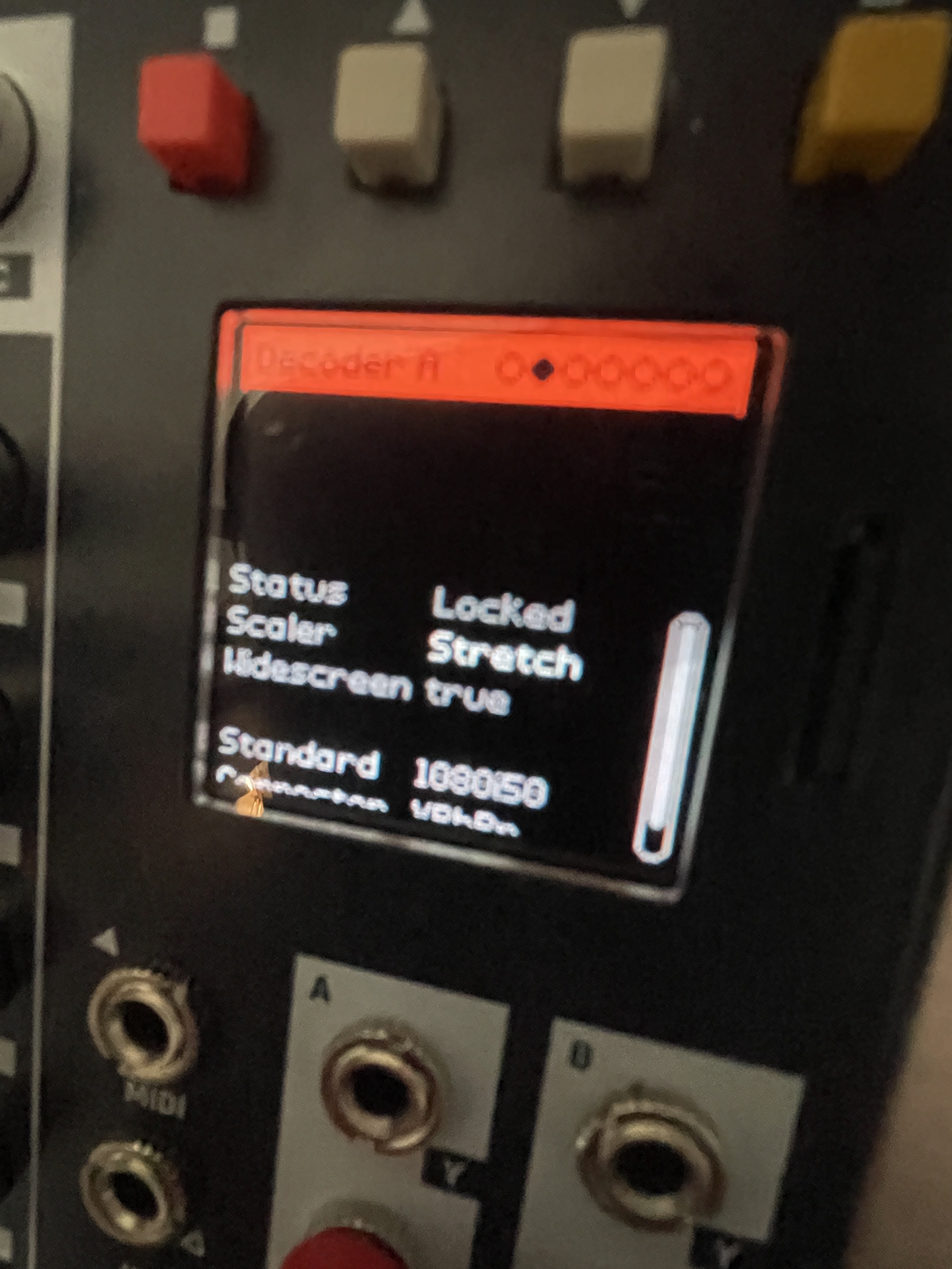

I’ve downgraded and tested on v.1.0 and updated and test on v.1.0.3 - same issue on both versions
On v.1.0.3 the screen shows an additional option: ‘Scaler’ with ‘stretch’ or ‘cropped’ options
My TBC2 is the Orion Class III version / with the CV/Gate outputs on the rear
I’ve attached an image of this as well
