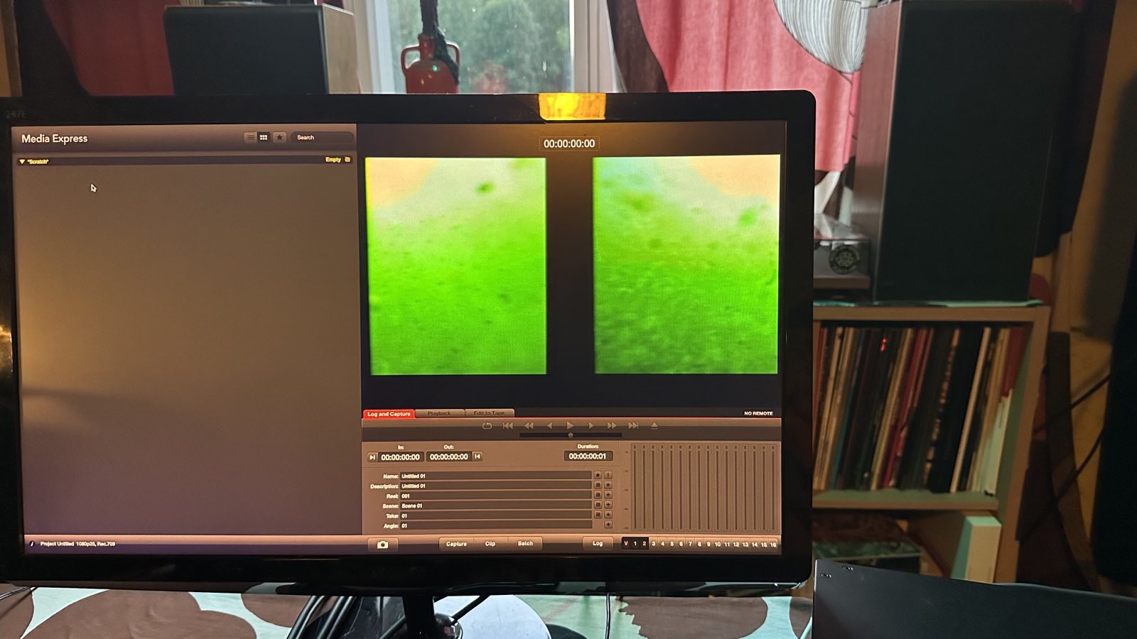

The TBC2, ESG3, BMD Desktop Video and Media Express are all set to capture/operate in 1080p 25fps and by setting it up like this the picture gets divided in two and it’s wiggling like a mofo.
This issue only presents itself in these settings and my only issue with it really is the astronomical file sizes.

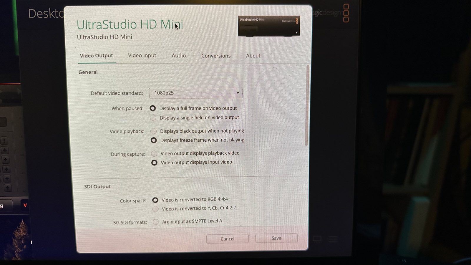

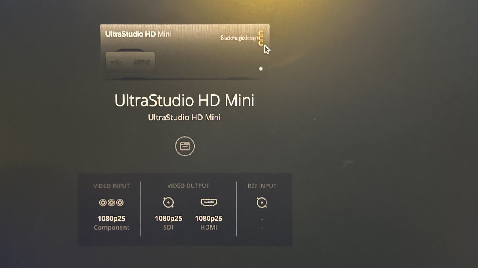

Here are some pictures of the settings in case there is something obviously wrong with them.
60da85dccaf3806008d5ad1e85eaccf82e7a2e91351780551d01f26c33097c0b
1069e4428b2dbbc8ee9f06e8689dc62dd6134c1240c62418a58a7a3fb8852771
660c6eb62335849002f20e395c0c02e38b46b055101714547d5dcef2ee189db3
621475e373e27d2bcb2f64a40c1dd9a38570fffd3e701c416972f74383114975
eeccc75f74c730f5c393fb5e73fc7e72533a3407c2f1d6224c931a2ad26c9d93

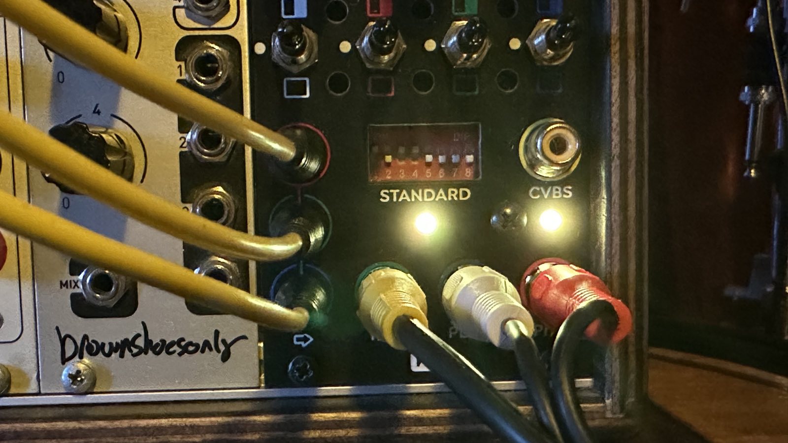

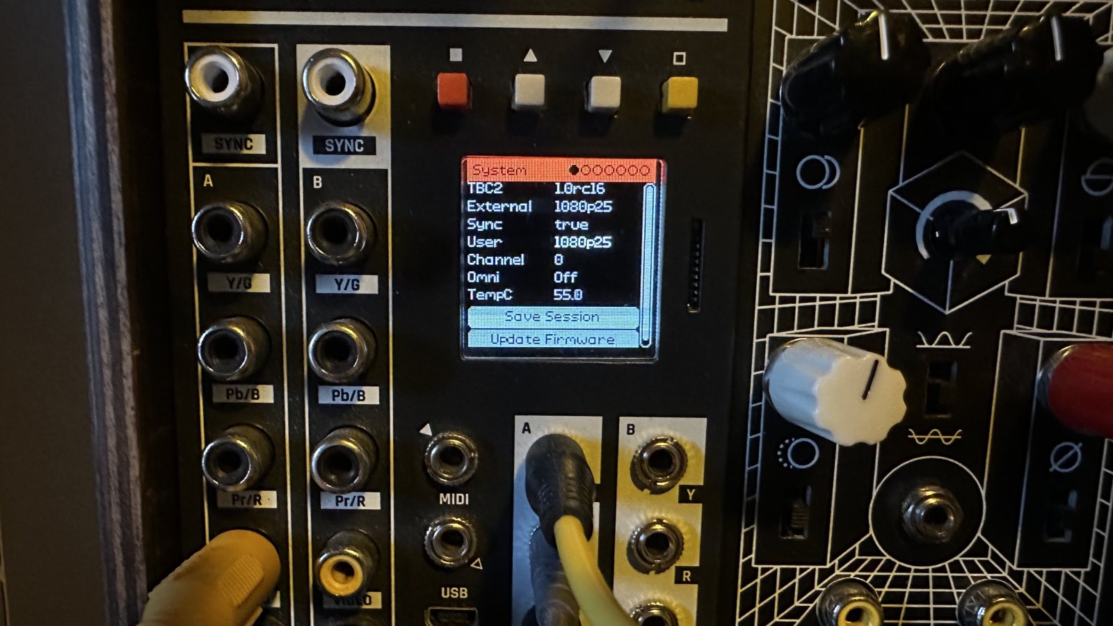

I now have only the TBC2 and ESG3 in my setup. The sync is going trom the ESG to the TBC. I have the dip switches set to 10110000 as the manual states is the configuration for 1080 25p. The picture is still divided in two. I have also tried it with different source material and no dice.
The picture on the TBC’s display is not split in two.

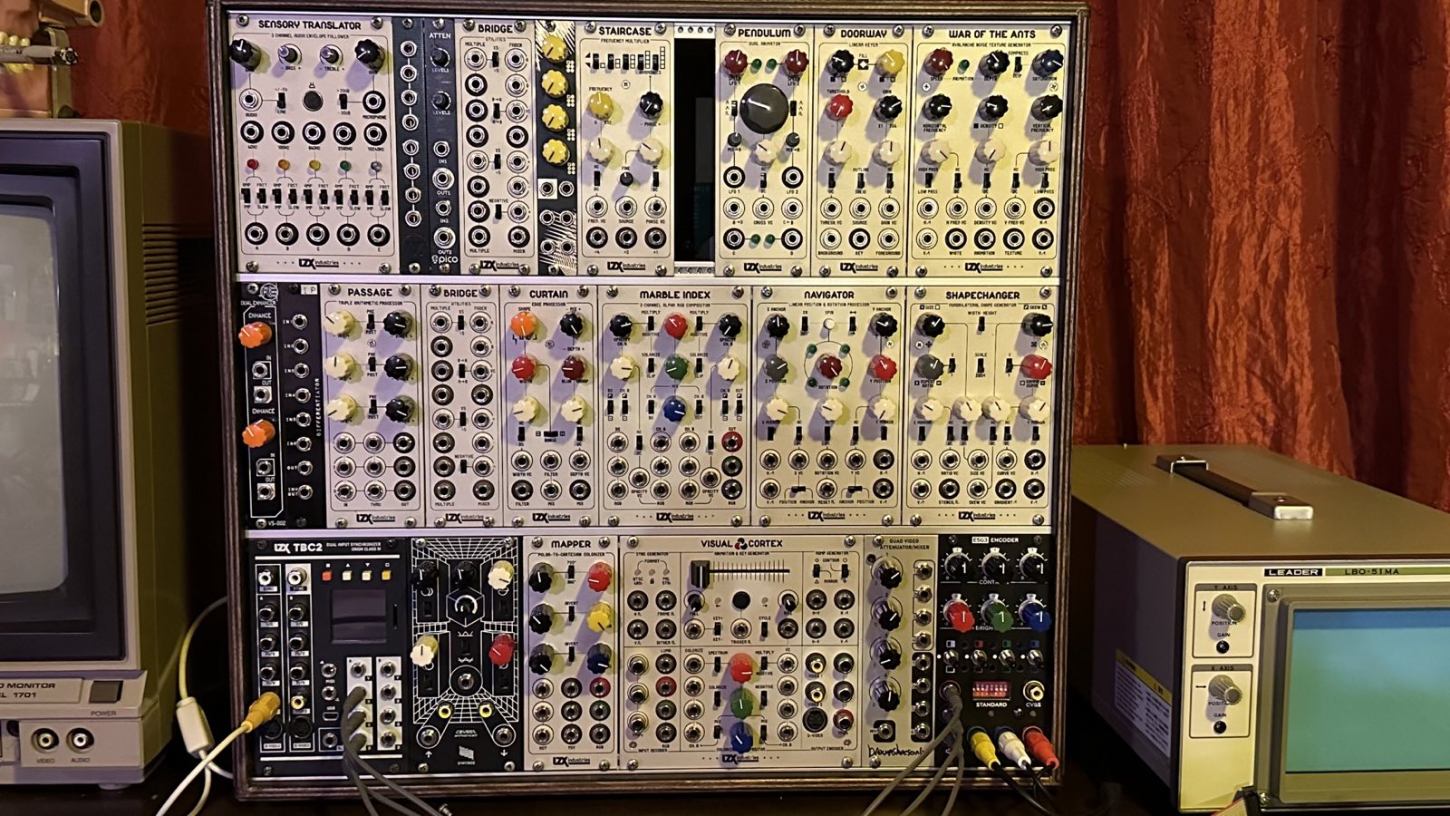

Here is the setup:
e015a9ca6045631a76e138ea1dc0a9265ba2a0b42b4de5746904f1b0f942c8e7-1
