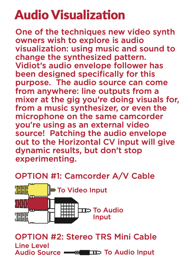

Thanks! It looks like there are a lot of options, which makes sense. Aural Scan sounds amazing. Now I’m wondering how the Vidiot does it, and whether I can just use something like Proc to reduce the voltage.
#4 — sean · 2024-11-22
Vidiot’s audio input feeds into an envelope follower:
Screenshot 2024-11-21 at 7.12.37 PM
Proc can attenuate, yes, if processing sound with an audio eurorack voltage range (0-5v) envelope follower. Very useful module to have, period.
