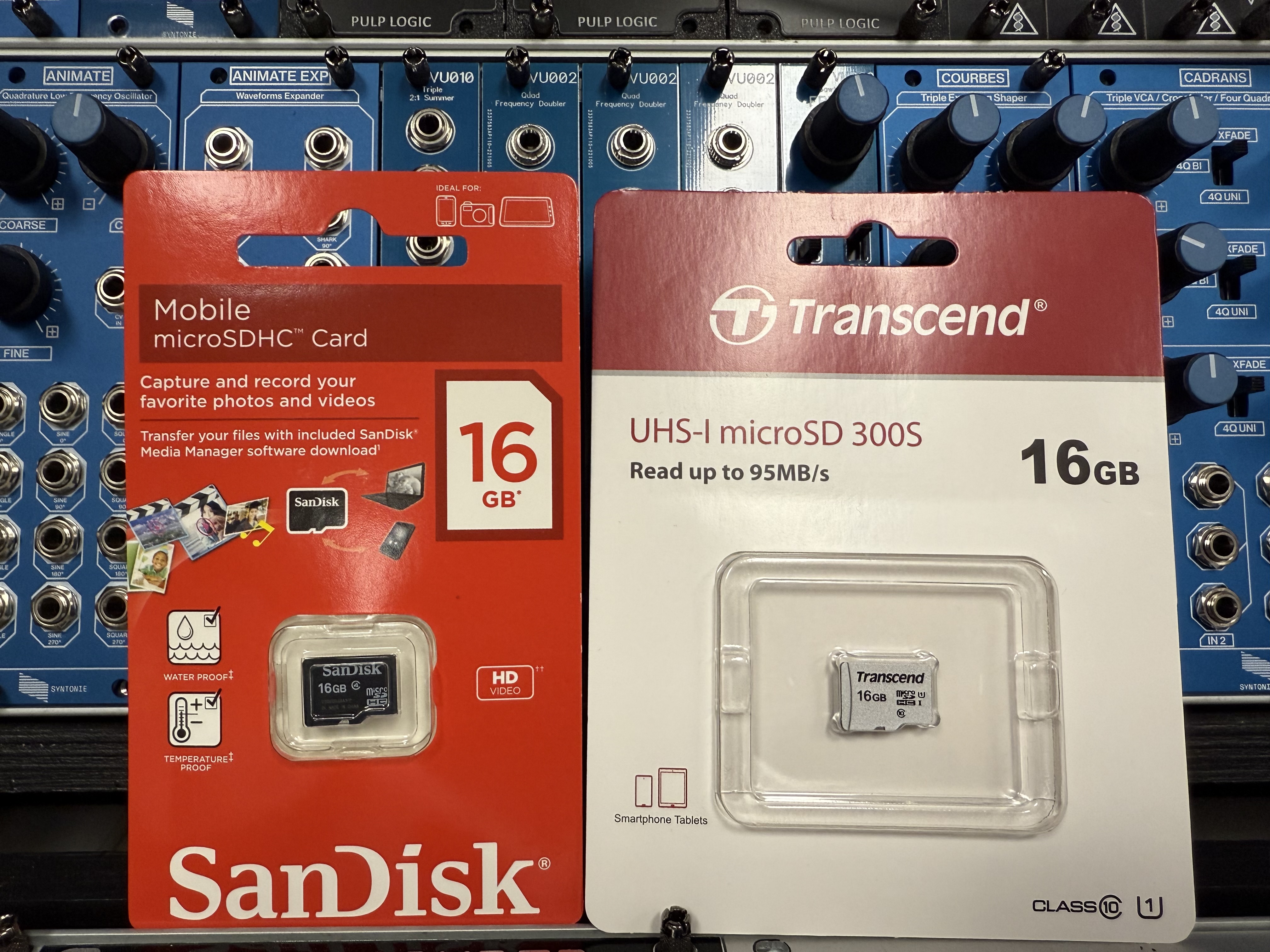

…sorry for the noise - with the help of this thread
(Posting in case it can be resolved and can help someone else in the future) > I accidentally pressed ‘Reset Firmware’ on the TBC2. After it finished erasing, there was a prompt to restart - I pressed the confirm/yellow button but think it was frozen as nothing happened for a couple of minutes, so I powered down - Now, after powering back up, the TBC2 won’t show anything on the display. > I’ve tried loading the boot.bin file to an SD card and holding down the ‘Boot from SD’ button on the back of t…>
i was able to boot from an Transcend 4GB card - the recommended Sandisk 16GB card did not work (photo shows also a 16GB Transcend, but only the 4GB is working):
IMG_1013

…however: please update the recommended SD-card-list; a (british) friend living in the netherlands and i searched online for a couple of days to find the recommended card (see photo above, card had only arrived today) which is an old class 4 model, very difficult to find (over here, Europe) and very-very expensive…and: it does not work…
