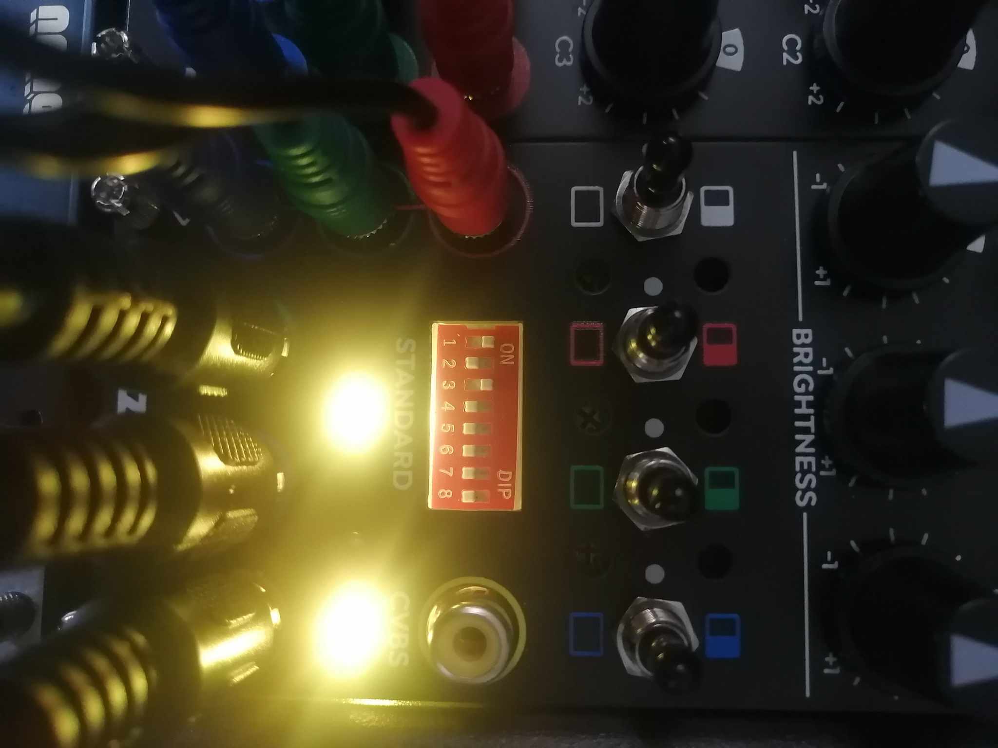

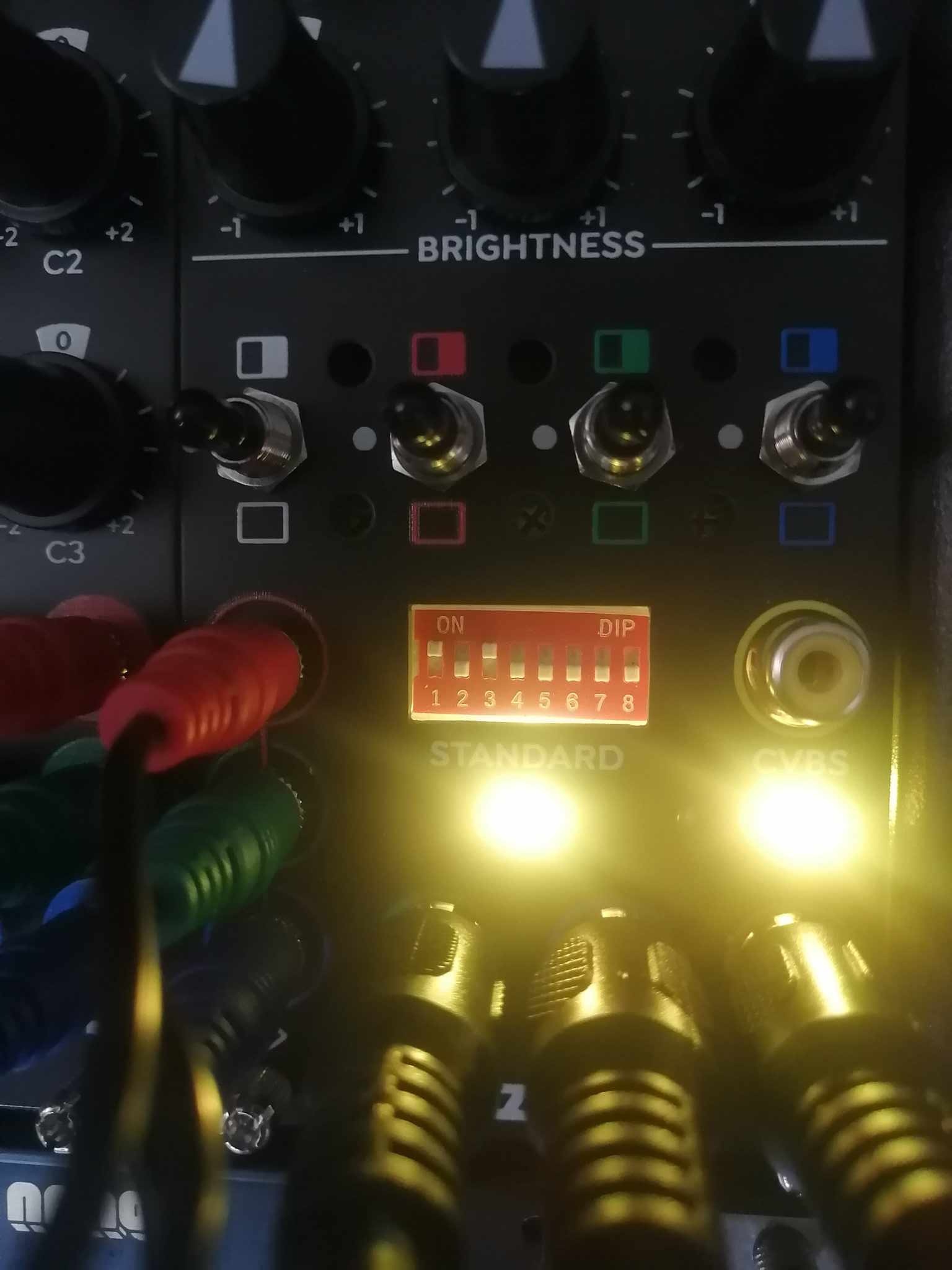

I’m trying to send the image from my synthesizer using the ESG3 module in HD, but it’s not working, despite the video format switch being configured to 1010xxxx. The indicator light is yellow.
I’m sending the signal through a Blackmagic Analog to SDI module, then to the UpDownCross HD, and finally to a USB 3.0 capture card to send it to Resolume Avenue. Here is the wiring diagram in the photo.

First thing I always recommend when having this type of issue is to attempt to segment the problem. If you have a display that accepts a YPbPr signal, first try sending your ESG3 output direct to that display. If that works, you know the ESG3 isn’t the issue. And so on with your remaining converters.
Looking at your ESG3 dip switch configuration, you have it configured to 1080i60 - this isn’t as common of a frame rate as 1080i5994 so that could present some problems in some systems.

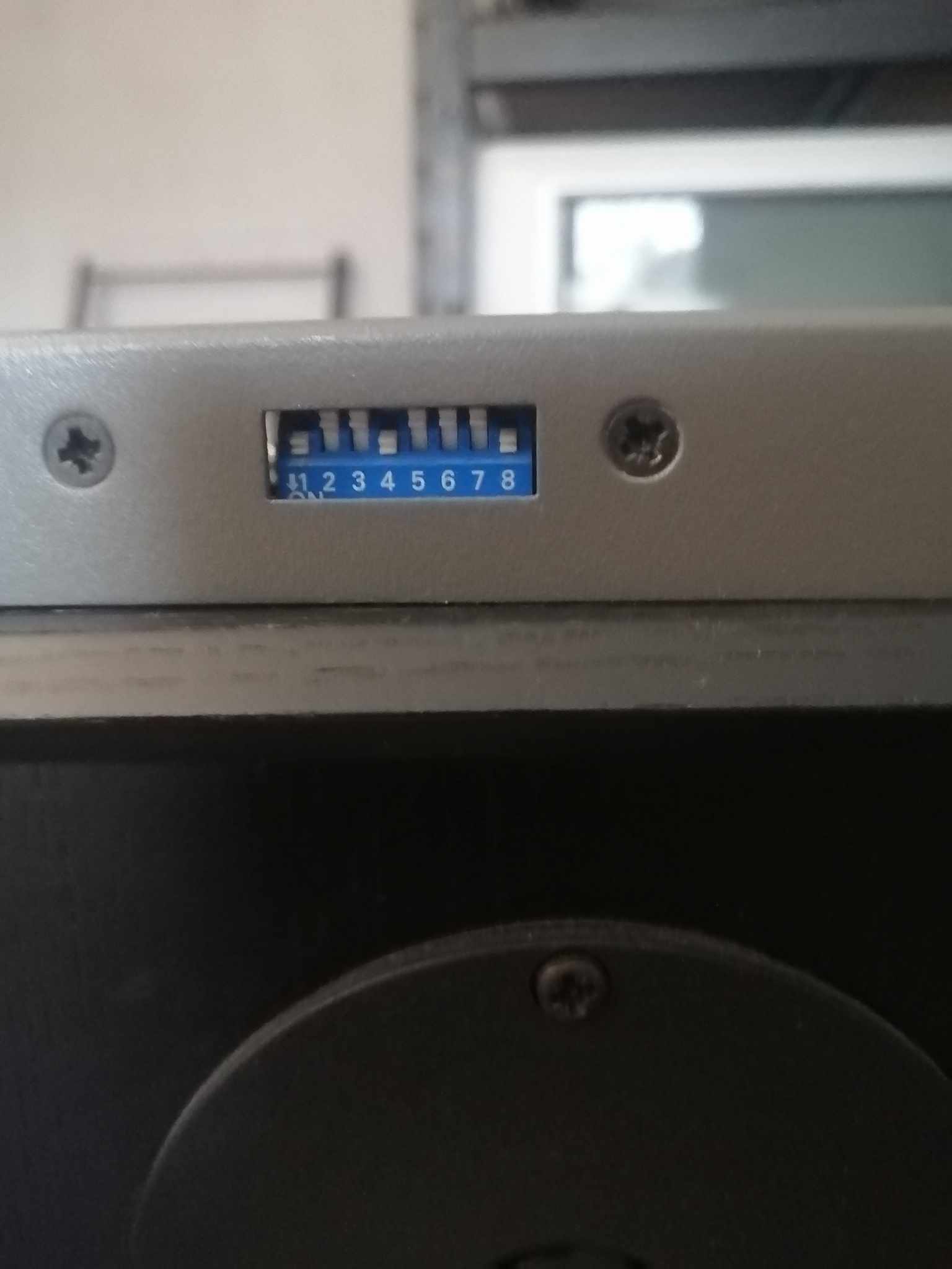

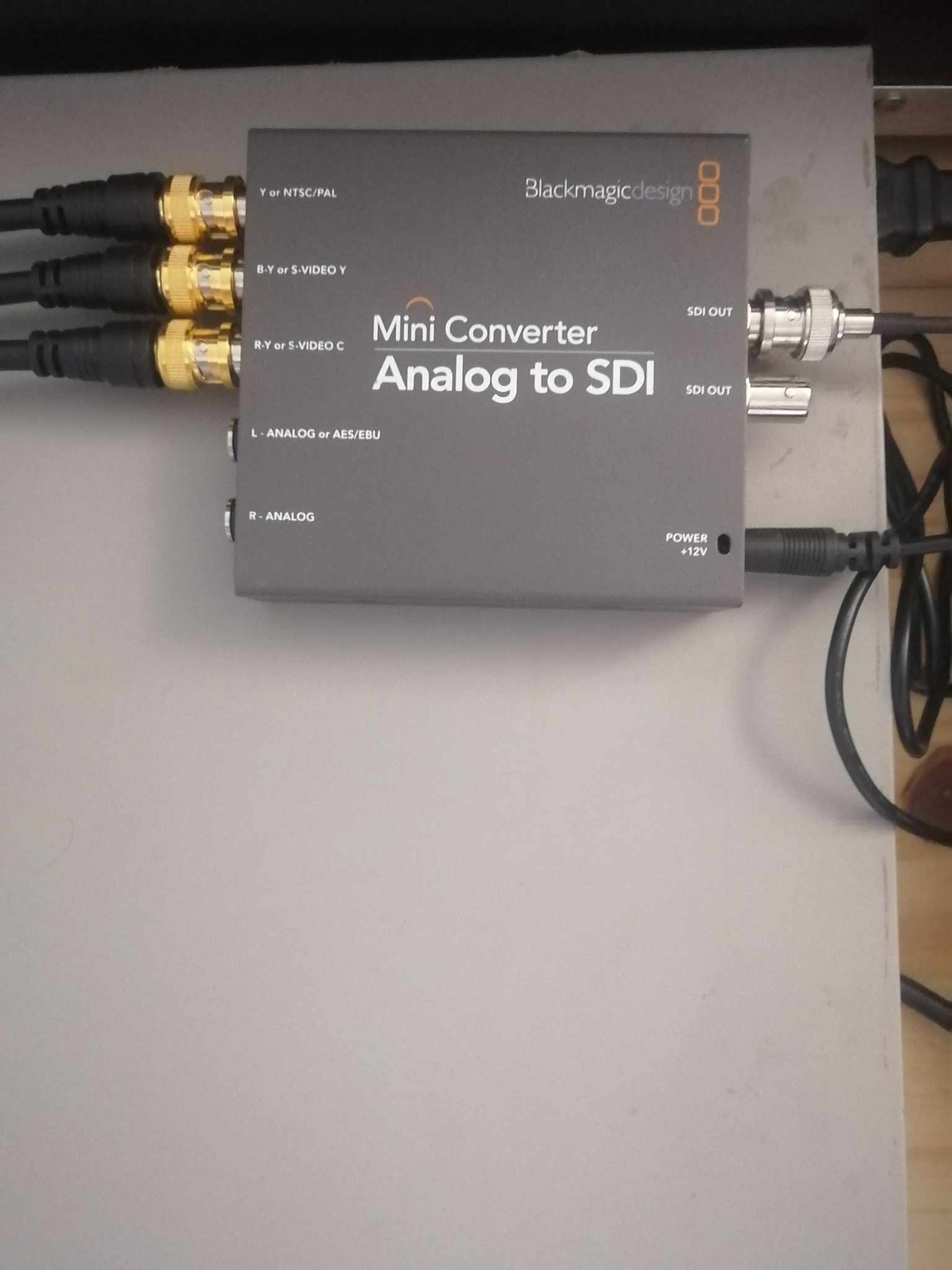

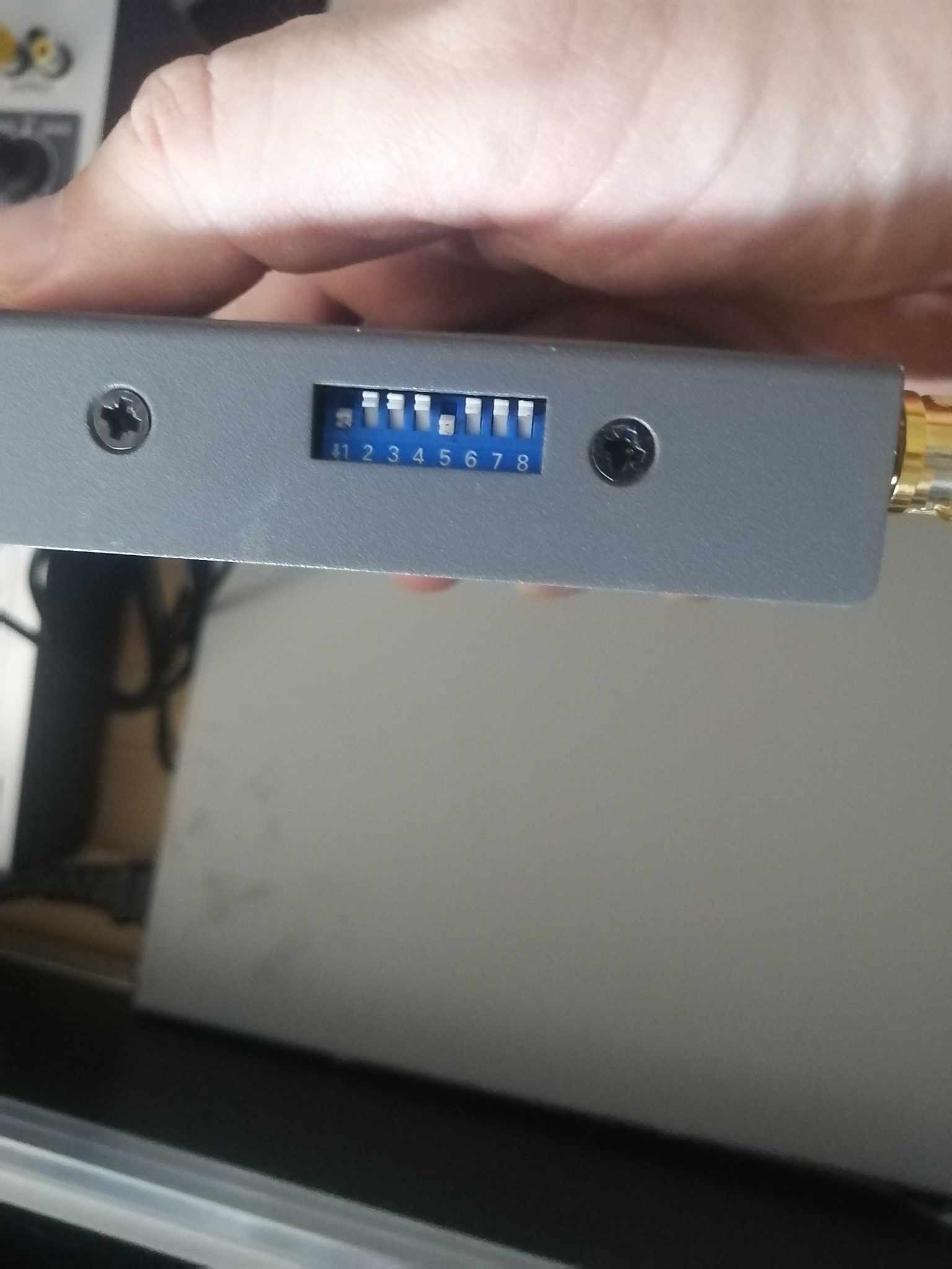

Looking at the Analog to SDI dip switches, it looks like you have switch 5 set to ON, which, according to the diagram on the back, sets your output to composite/s-video rather than component. These outputs cannot handle HD signals. Additionally, you have switch 1 set to ON. This switch has different impacts on the system depending on the amount of times it is cycled.

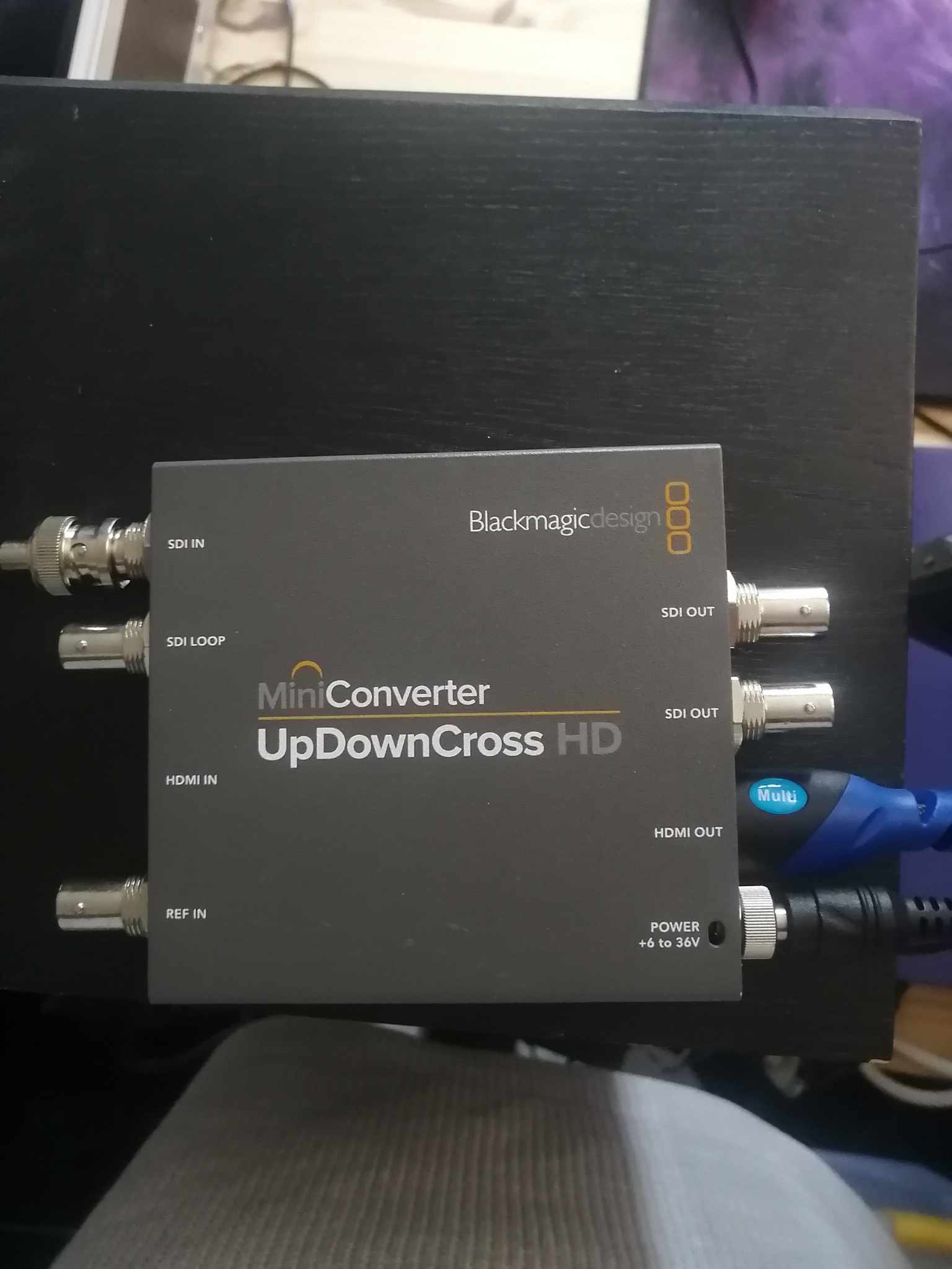

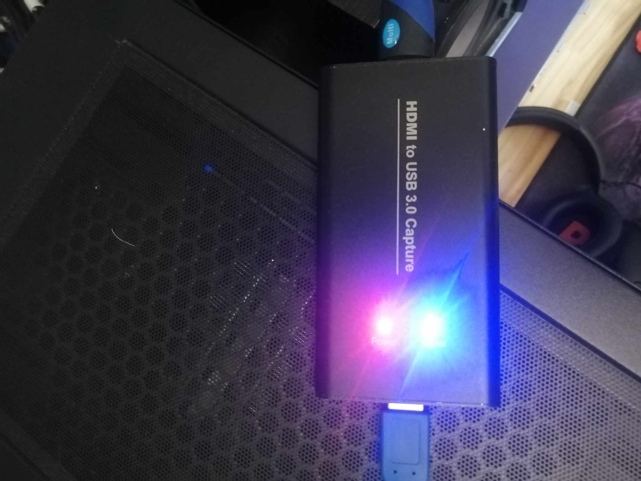

Looking at the UP Down Cross HD dips, you have 1, 4, and 8 set to ON, which, according to the diagram on the rear, sets the device to output 1080p30. Check the compatible resolutions/frame rates on your USB capture card to ensure that format is acceptable.

I just tested with the LZX without the Blackmagic module, and it works in composite. However, as soon as I try to use the different Blackmagic modules, such as Analog to SDI, the UpDownCross from the ESG3, or vice versa (doing UpDownCross HD and Analog to SDI via the TBC2), I receive nothing.
I have changed the module setup several times, but nothing works.

Hello, I just tested the ESG 3 module and streamed it directly to the screen in YPbPr. It seems to work. But still the same problem with the Blackmagic Analog to SDI and Up Down Cross modules and the RGBLing capture card.
