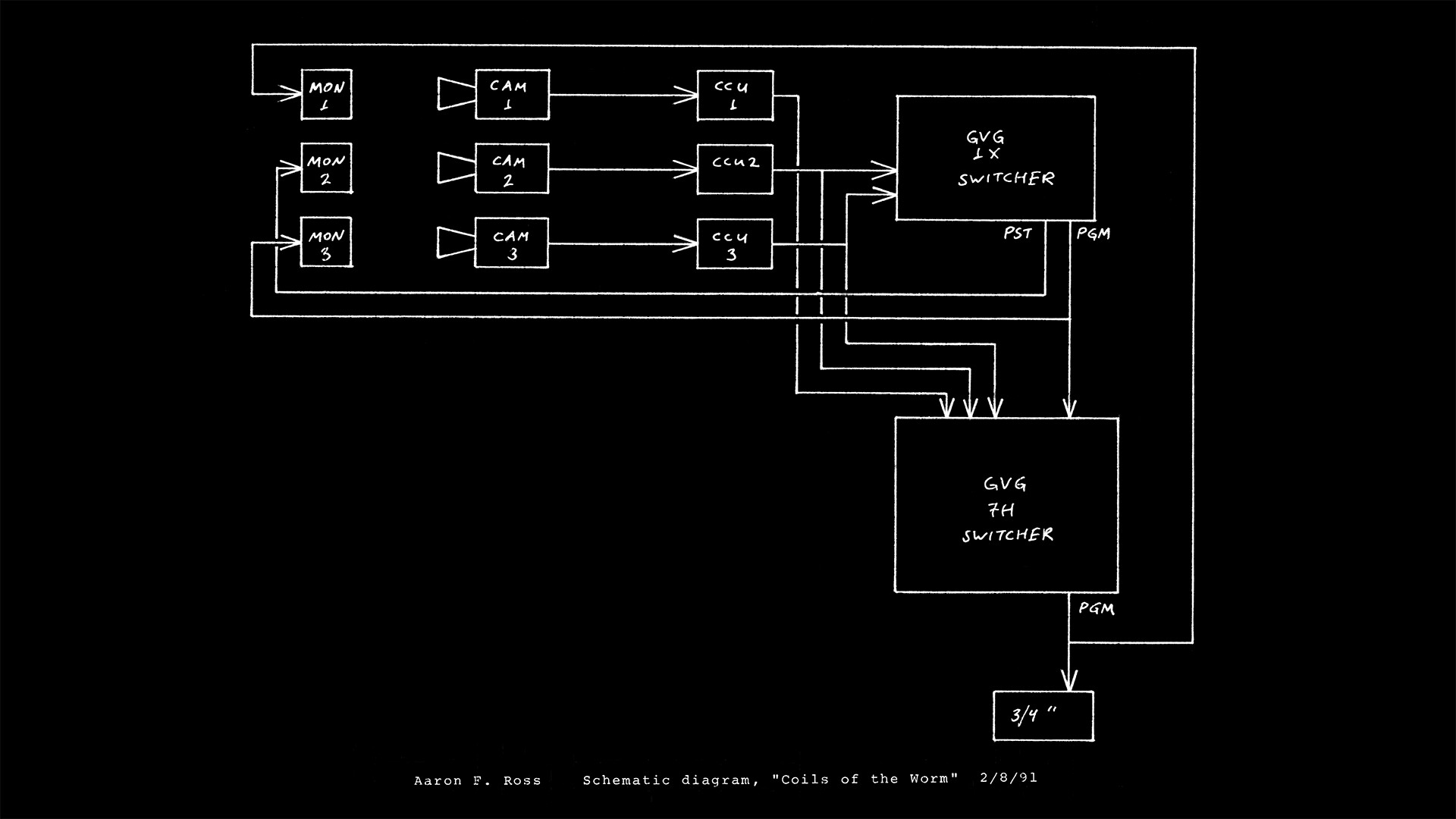

#2 — dryodryo · 2025-05-22
Feedback diagram, Coils of the Worm, 1991
00:21:33
00-21-33_coils_of_the_worm

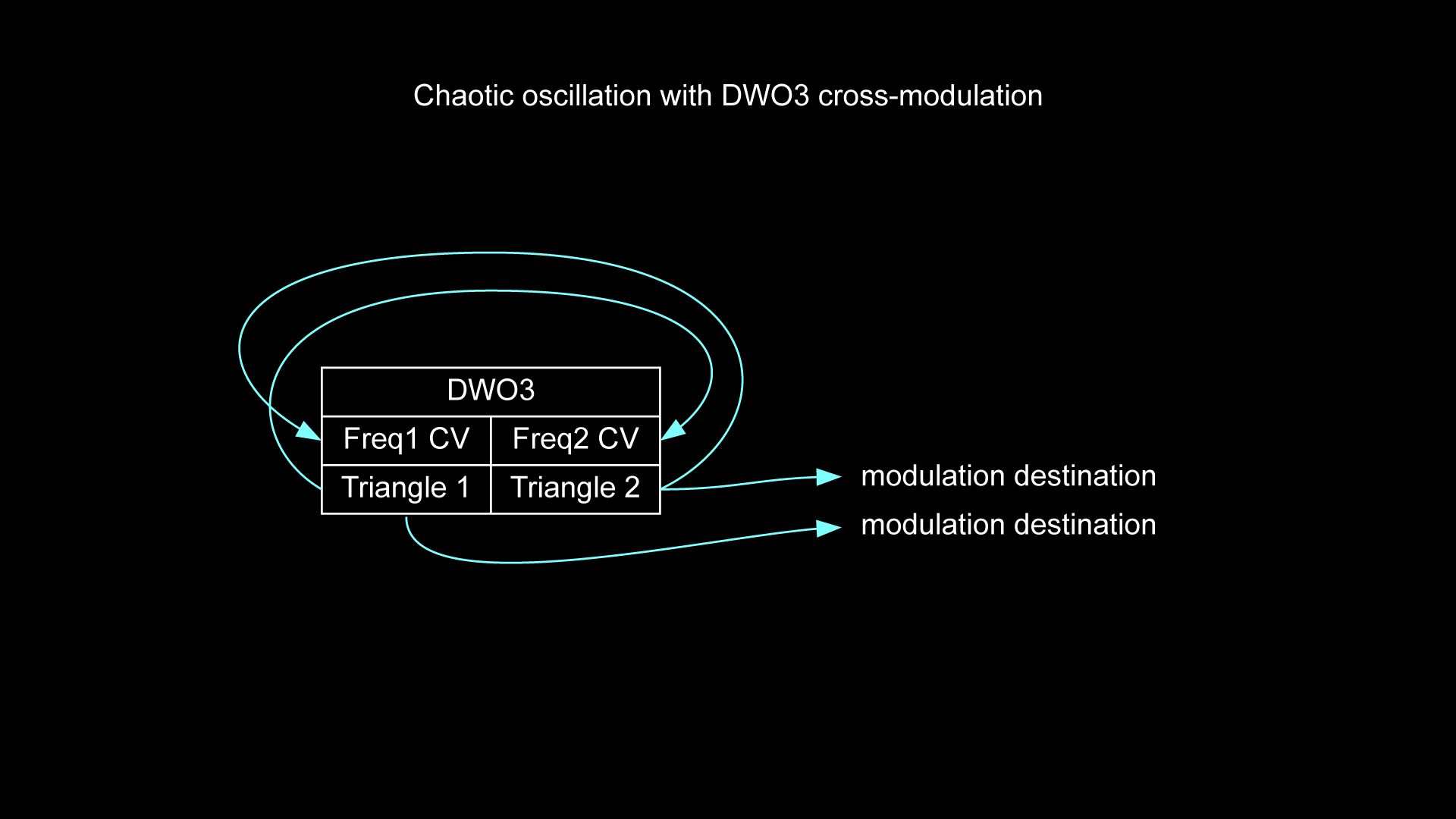

#3 — dryodryo · 2025-05-22
Chaotic oscillation with DWO3 cross-modulation
00:27:09
00-27-09_randomness_DWO3

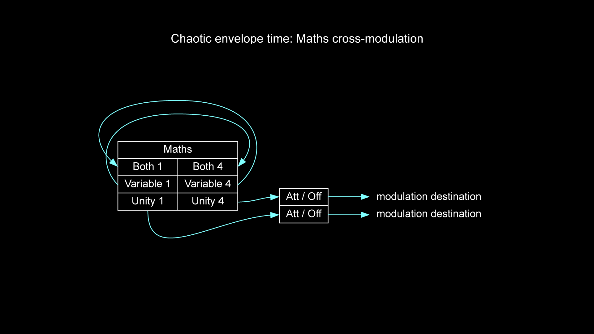

#4 — dryodryo · 2025-05-22
Chaotic envelope time: Maths cross-modulation
00:30:03
00-30-03_randomness_maths

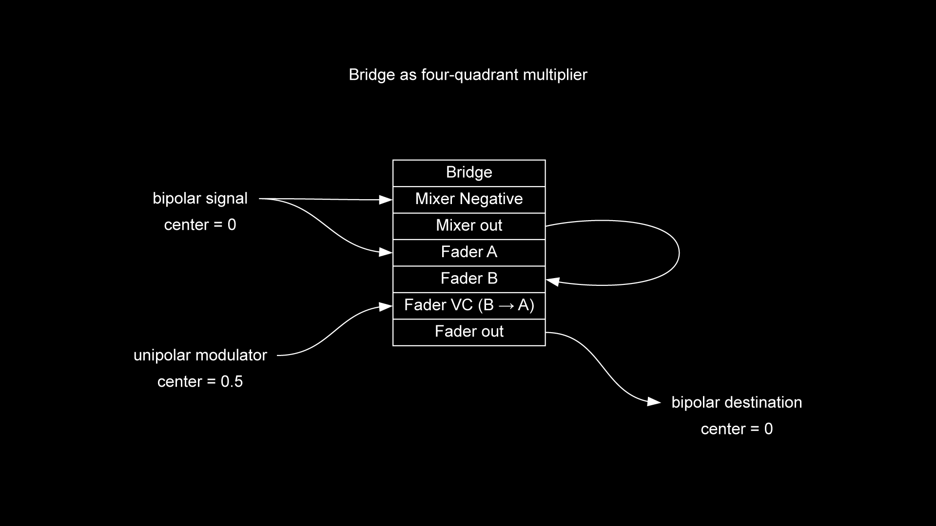

#5 — dryodryo · 2025-05-22
Bridge as four-quadrant multipier
00:38:12
00-38-12_bridge_4QM

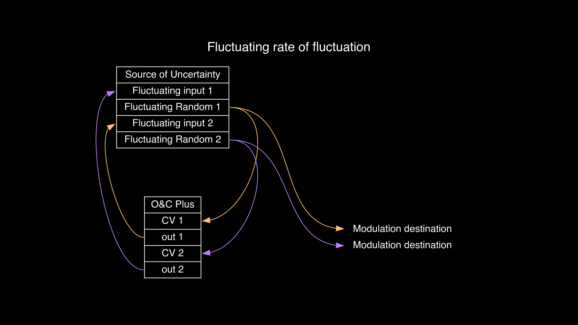

#6 — dryodryo · 2025-05-22
Fluctuating rate of fluctuation
00:40:41
00-40-41_fluctuating_fluctuation

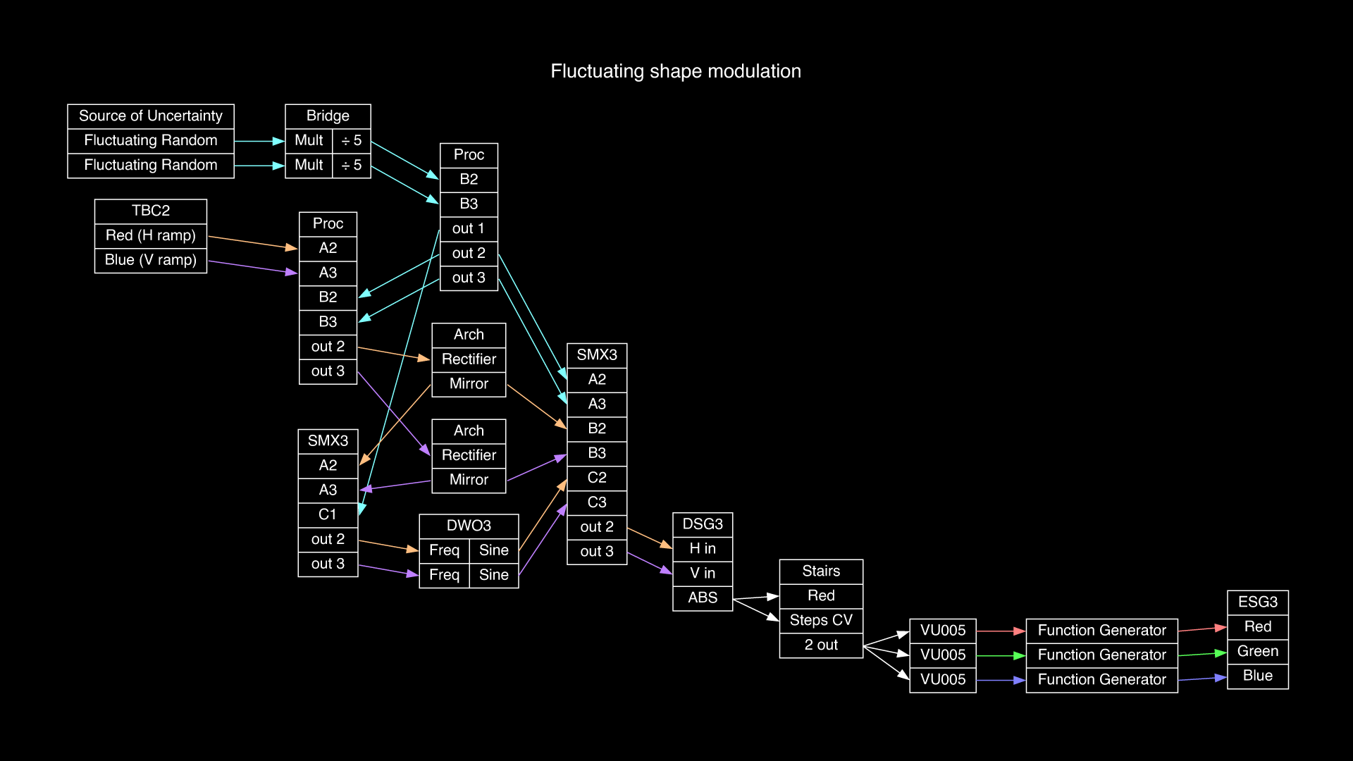

#7 — dryodryo · 2025-05-22
Fluctuating shape modulation
00:42:57
00-42-57_fluctuating_shape_modulation

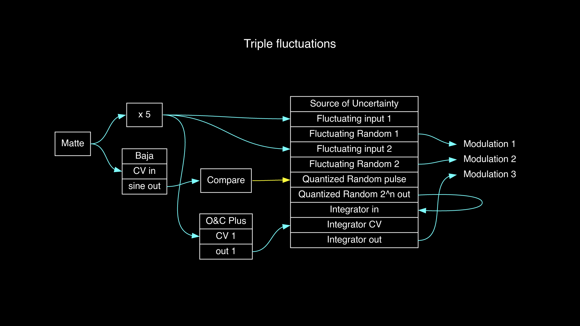

#8 — dryodryo · 2025-05-22
Triple fluctuations
00:48:28
00-48-28_triple_fluctuations

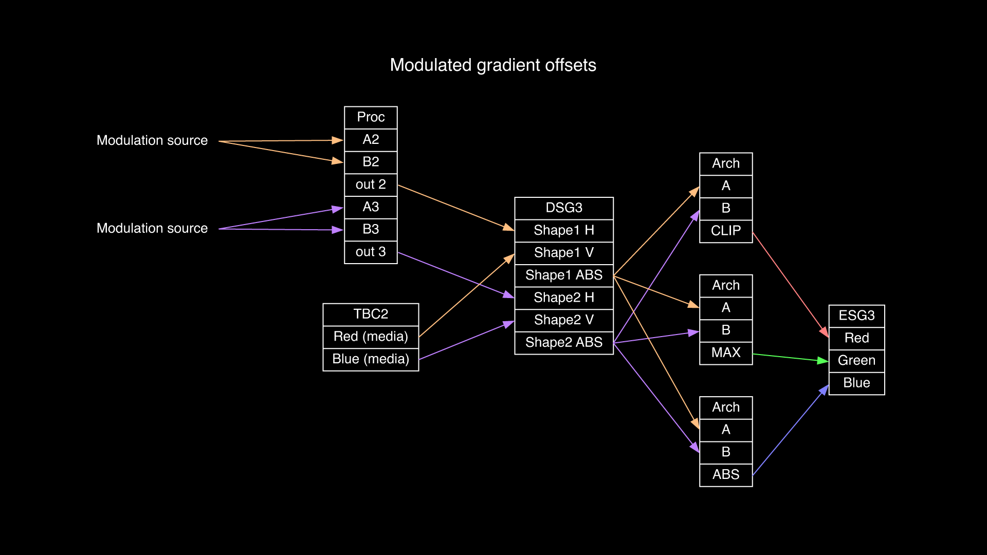

#9 — dryodryo · 2025-05-22
Modulated gradient offsets
01:02:48
01-02-48_modulated_gradient_offsets

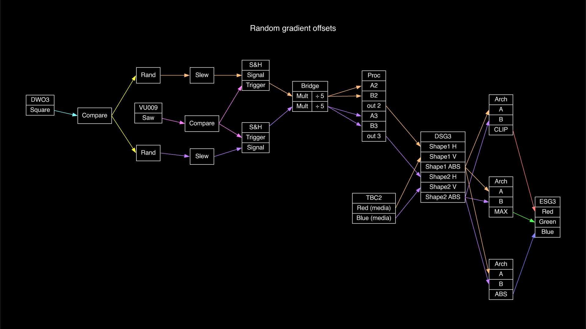

#10 — dryodryo · 2025-05-22
Random gradient offsets
01:05:06
01-05-06_random_gradient_offsets

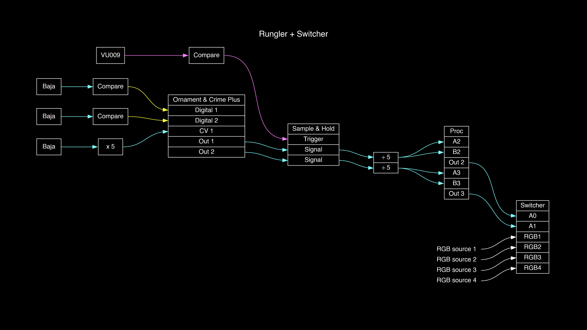

#11 — dryodryo · 2025-05-22
Rungler + Switcher
01:17:16
01-17-16_rungler_switcher

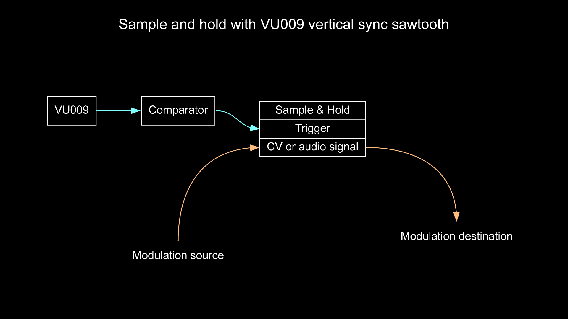

#12 — dryodryo · 2025-05-22
Sample and hold with VU009 sawtooth
01:17:56
sample_hold_vu009_01

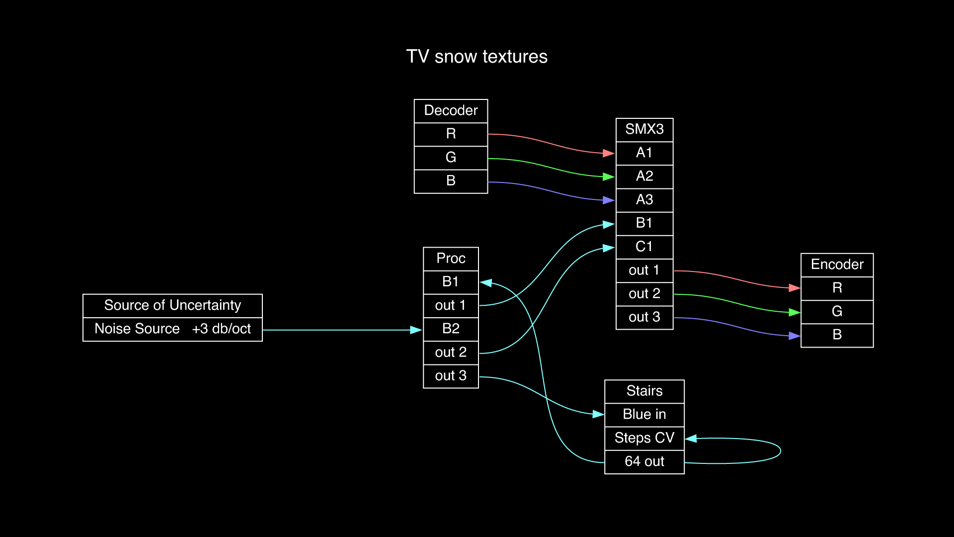

#13 — dryodryo · 2025-05-22
TV snow textures
01:37:04
01-37-04_TV_snow_textures

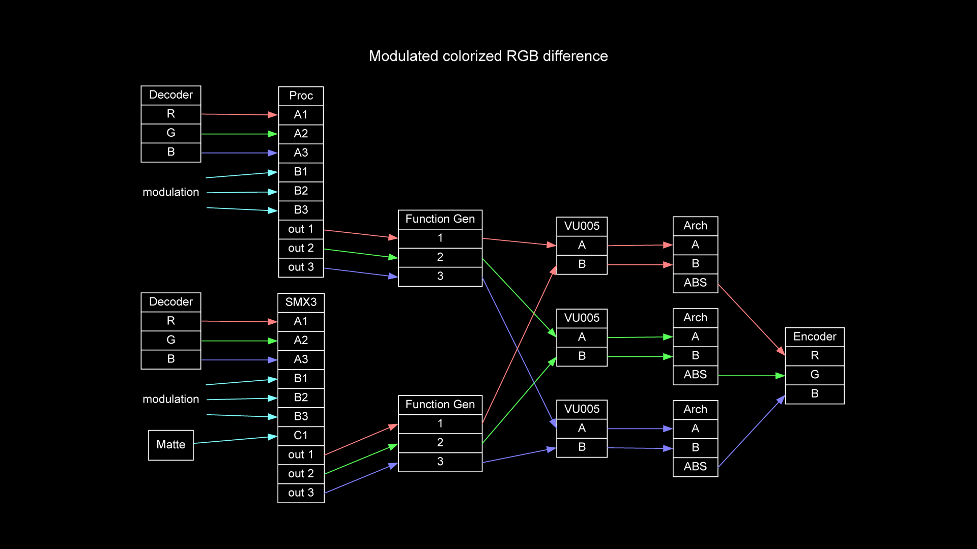

#14 — dryodryo · 2025-05-22
Modulated colorized RGB difference
01:39:12
01-39-12_modulated_RGB_difference

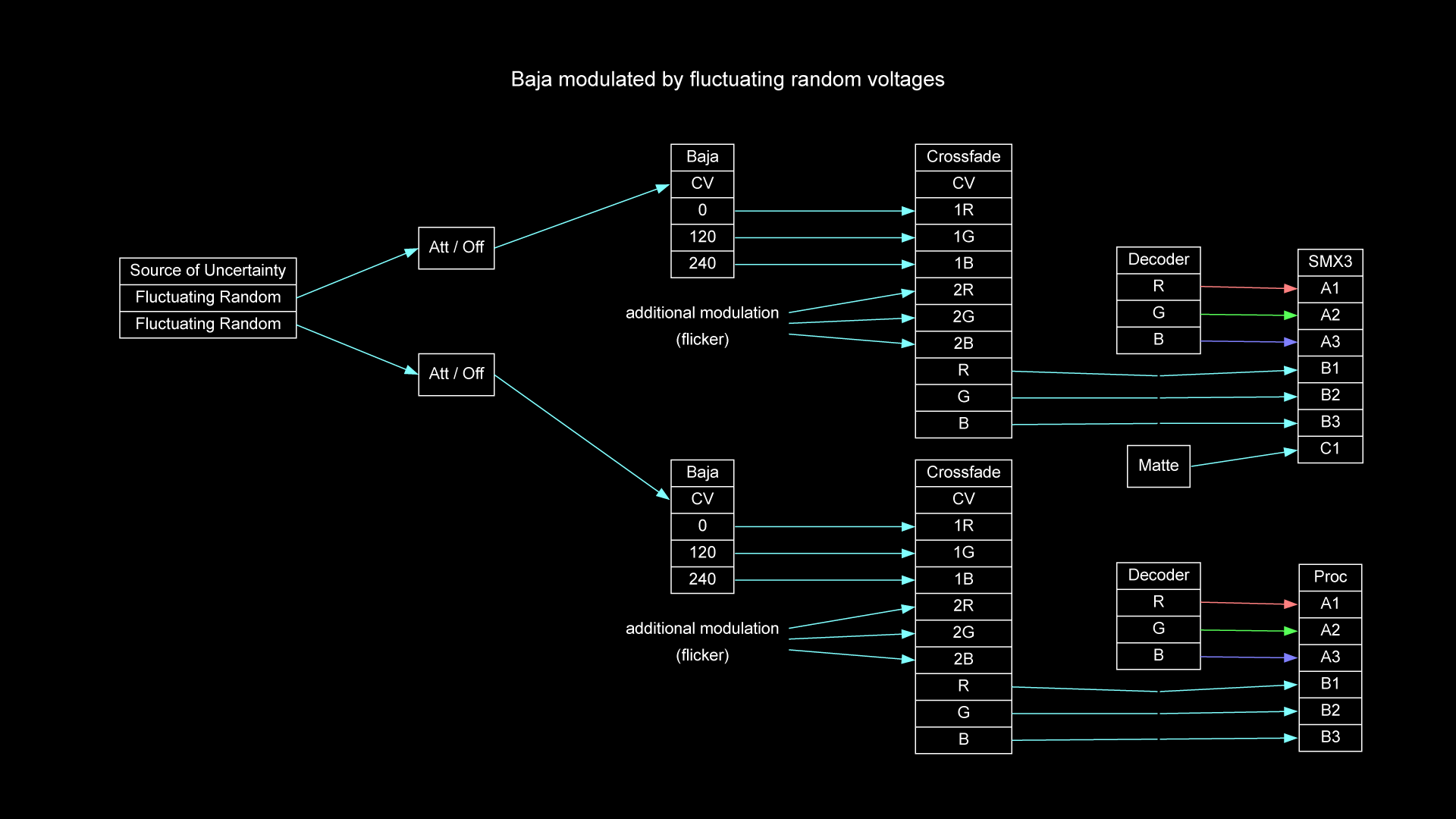

#15 — dryodryo · 2025-05-22
Baja modulated by Fluctuating Random Voltage
01:42:32
01-42-32_fluctuating_bajas

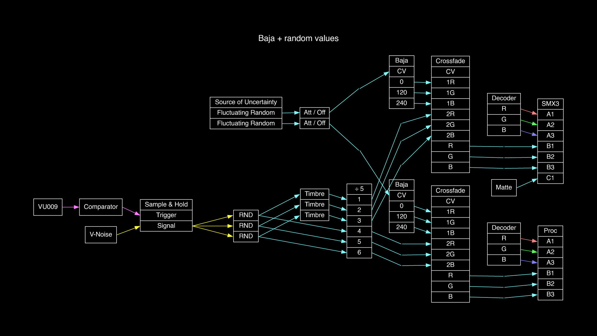

#16 — dryodryo · 2025-05-22
Baja + random values
01:45:50
01-45-50_baja_random_pulse
