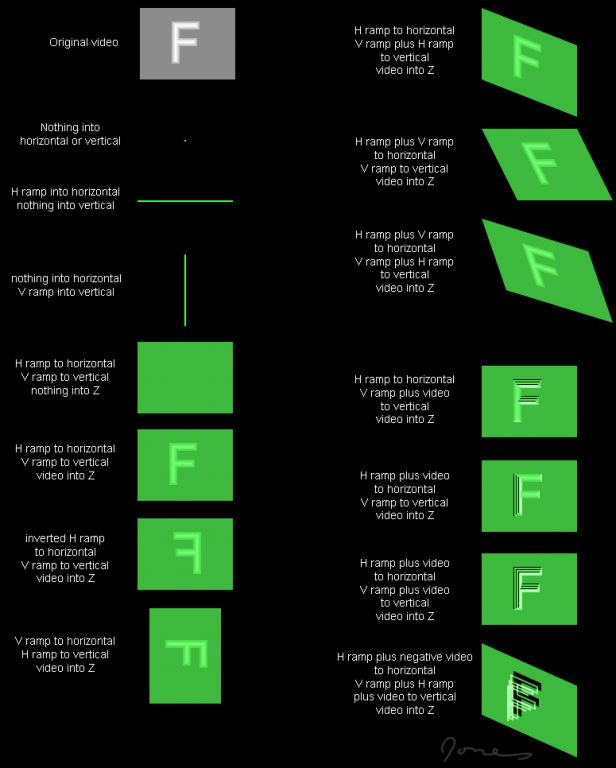

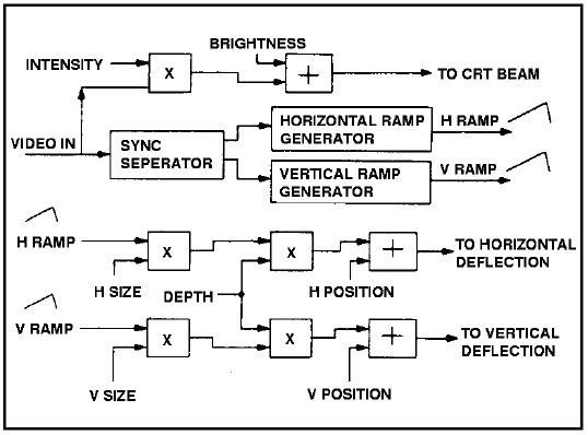

#2 — reverselandfill · 2018-09-22
These?
1136_1060_xyz_scope_sigs_1_1%20(1)
1136_2032_ruttetra_1_1%20(1)

Interesting, but I’m looking for documentation Lars released using Navigator, Shapechanger, Bridge, Passage, etc. Was it removed from the site?
