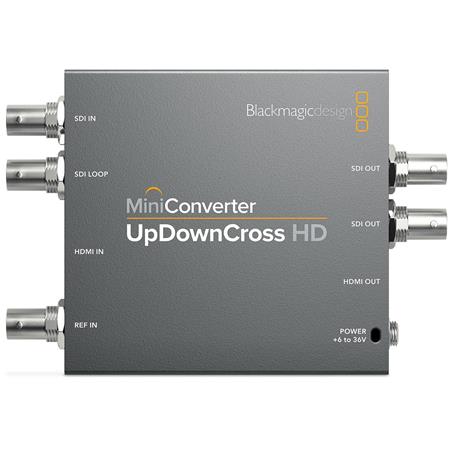

I’m looking for a conversion and scaling solution for my Cadet’s composite video output. The main use is to feed projectors and such. I know the Teranex Mini will need a cheap SDI->HDMI box to do this, but I
m ASSuming that will Just Work.
I can get either of the solutions in the title for around the same price ($300-350), so it’s down to features and actual use.
Can anyone think of a reason to favor one over the other, or is there something else I should be looking at?

If you haven’t already, you should also look at their SDI->HDMI micro converter.
#3 — nerdware · 2018-09-27
Oh! I just noticed that the Mini Converter UpDownCross HD model has an HDMI output. I’d not known this before today. Thanks.

#4 — peloazul · 2018-09-27
If it matters, I think the UpDownCross is only 3G (1080p?), and the Teranex Mini is 12G (4K?). So a little more future-proofing with the latter.

#6 — jnoble · 2018-09-27
The Teranex Mini’s UHD option is only for upscaling incoming HD analog video, however, and the manual is not specific at all about what “HD” and “UHD” formats they are, exactly.
I’m leaning toward the mini analog->SDI + UpDownCross HD.
#7 — wednesdayayay · 2018-09-27
I like this option because if you were to go into the 4k realm your updowncross HD could just get replaced with an SDI => 4k and you would be good to go
