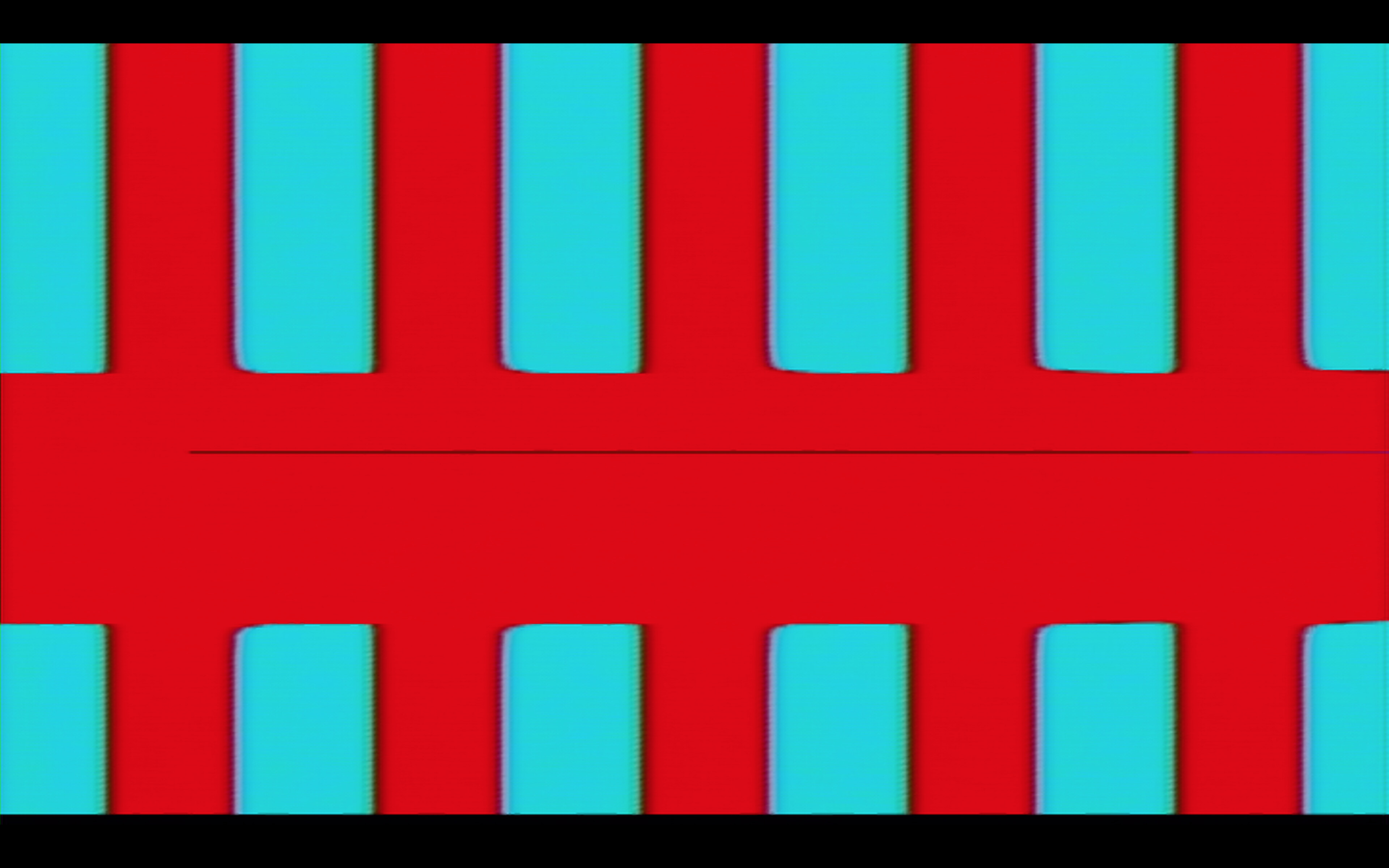

#13 — johnskynet · 2021-02-11
Bumping this topic for research sake as I am just in the process of updating my rig to hardware hd! (yipee!) And I am doing some test on my equipment. :))
So long short of it I also am experiencing some weird horizontal lines in the Vidiot when I run it through my setup.
My workflow:
Vidiot → BM Analog to SDI → MD-HX → Thunderbolt Intensity Shuttle
pic below vv
Screen Shot 2021-02-10 at 11.25.57 PM

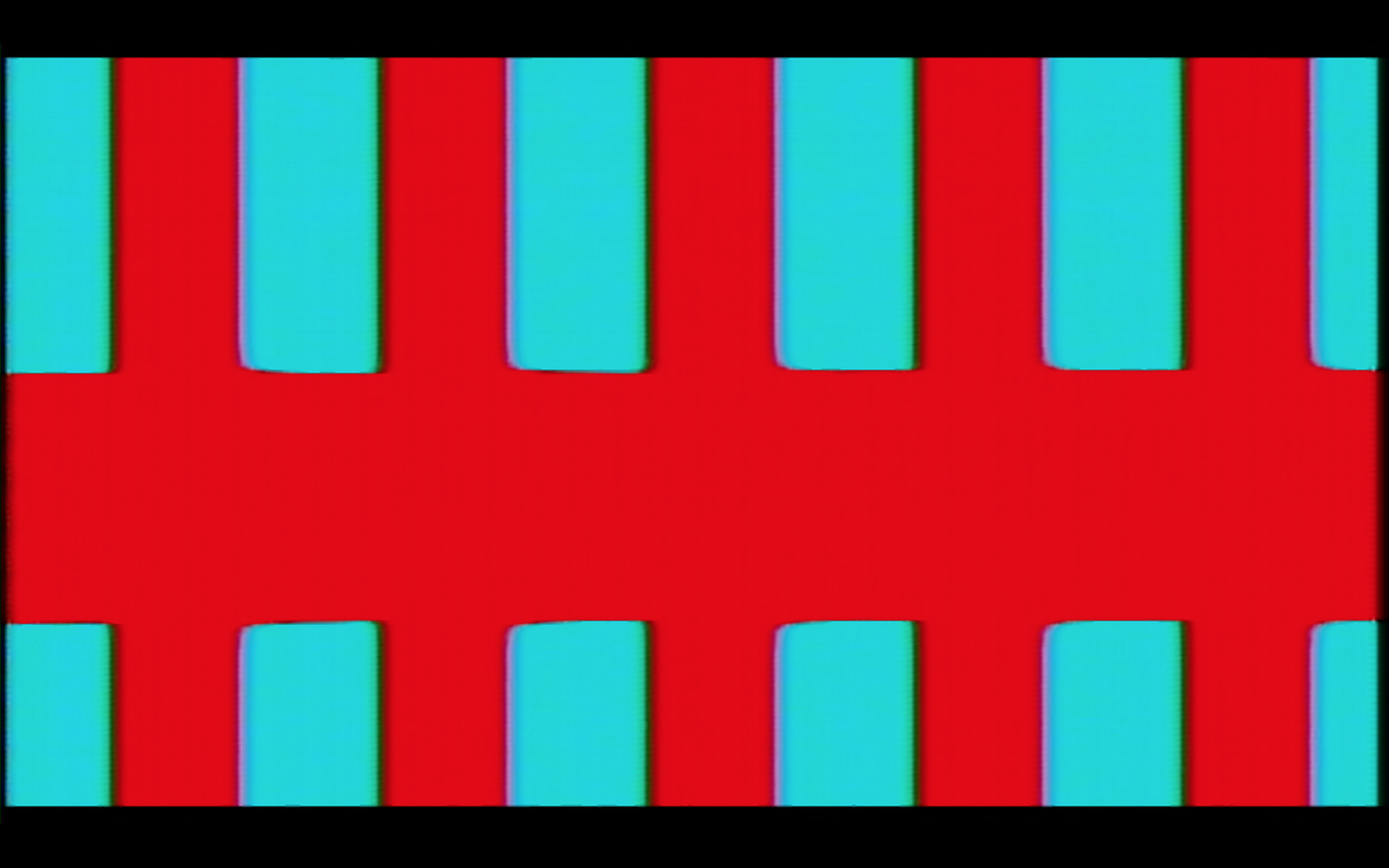

However! I noticed if I run the Vidiot thru the V4 as suggested I don’t get any dropout or horizontal lines! pic below vv
Screen Shot 2021-02-10 at 11.25.36 PM
Interestingly if I run the Vidiot into the composite on the BM Shuttle with SD resolution I don’t get any drops or lines either. No pic but u get the point.
I am swapping out my BM Shuttle recording for an Atomos Ninja V that I should be getting in the next few days. But let me know if you want to test some other stuff out. :)) I am gonna break out my euro lzx system too and I know everyone here loves there workflow posts
