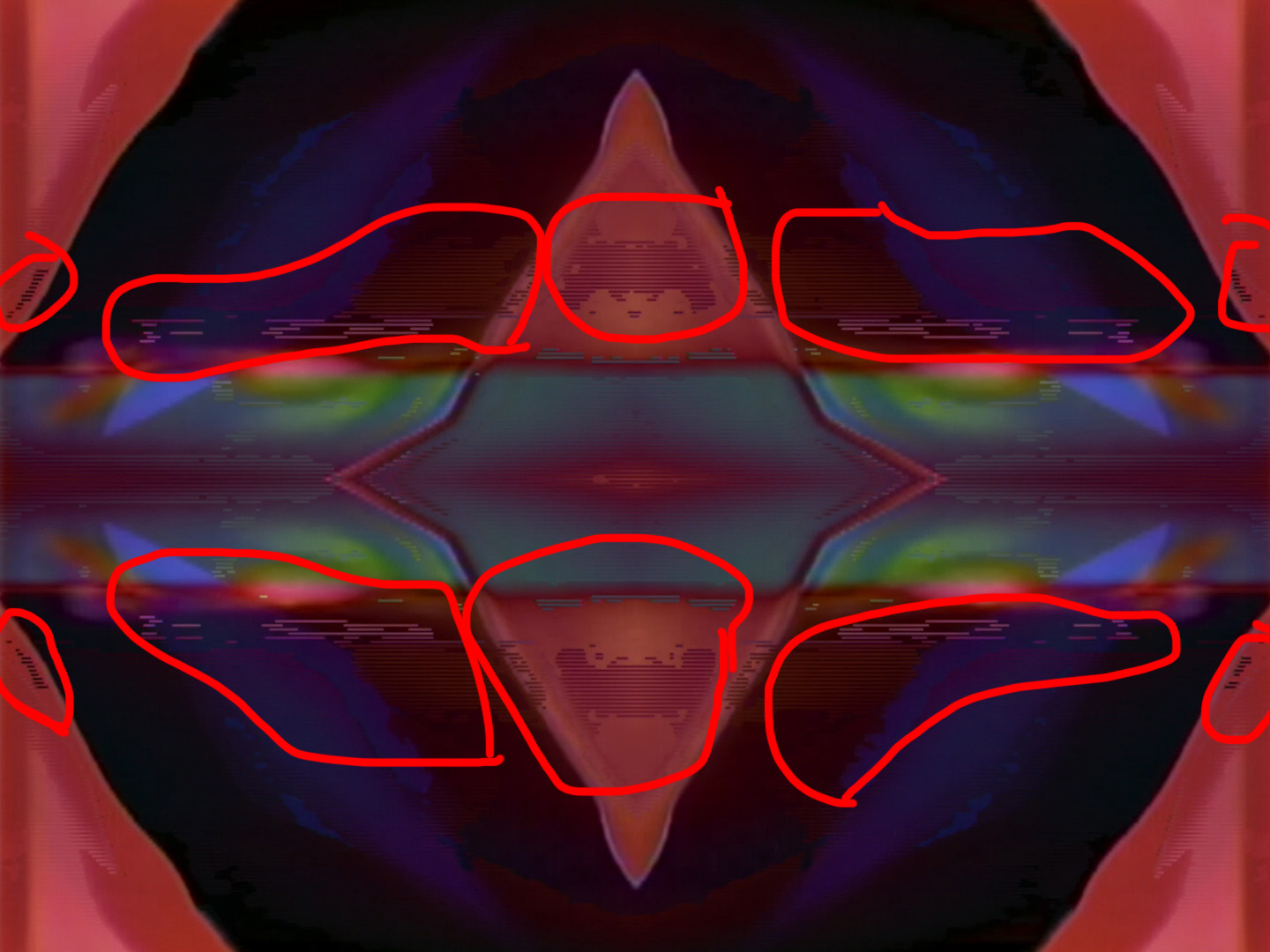

#3 — alexpelly · 2018-09-05
Can any one recommend a converter that takes composite RCA or s-video and outputs HDMI? I usually run my system through an Edirol V4, and have been using a Roland VC-1-SC scan converter, but get all these awful interlacing artifacts.
#4 — creatorlars · 2018-09-05
Here we’re using Blackmagic Mini Converters… Analog-to-SDI then SDI-to-HDMI.
#5 — alexpelly · 2018-09-05
Oh rad! Those are way cheaper too. What resolution is the HDMI output after the signal travels through both mini converters? Hoping for 1080p.

#19 — alexpelly · 2018-11-20
I’ve been using the Blackmagic Mini Converters - Blackmagic Design Mini Converter Analog to SDI and Blackmagic Design Mini Converter UpDownCross HD for a couple months now with no more interlacing issues. They’re also way cheaper than the Roland scan converter I was using before, which is awesome! Definitely would recommend them. Thanks for the advice!
